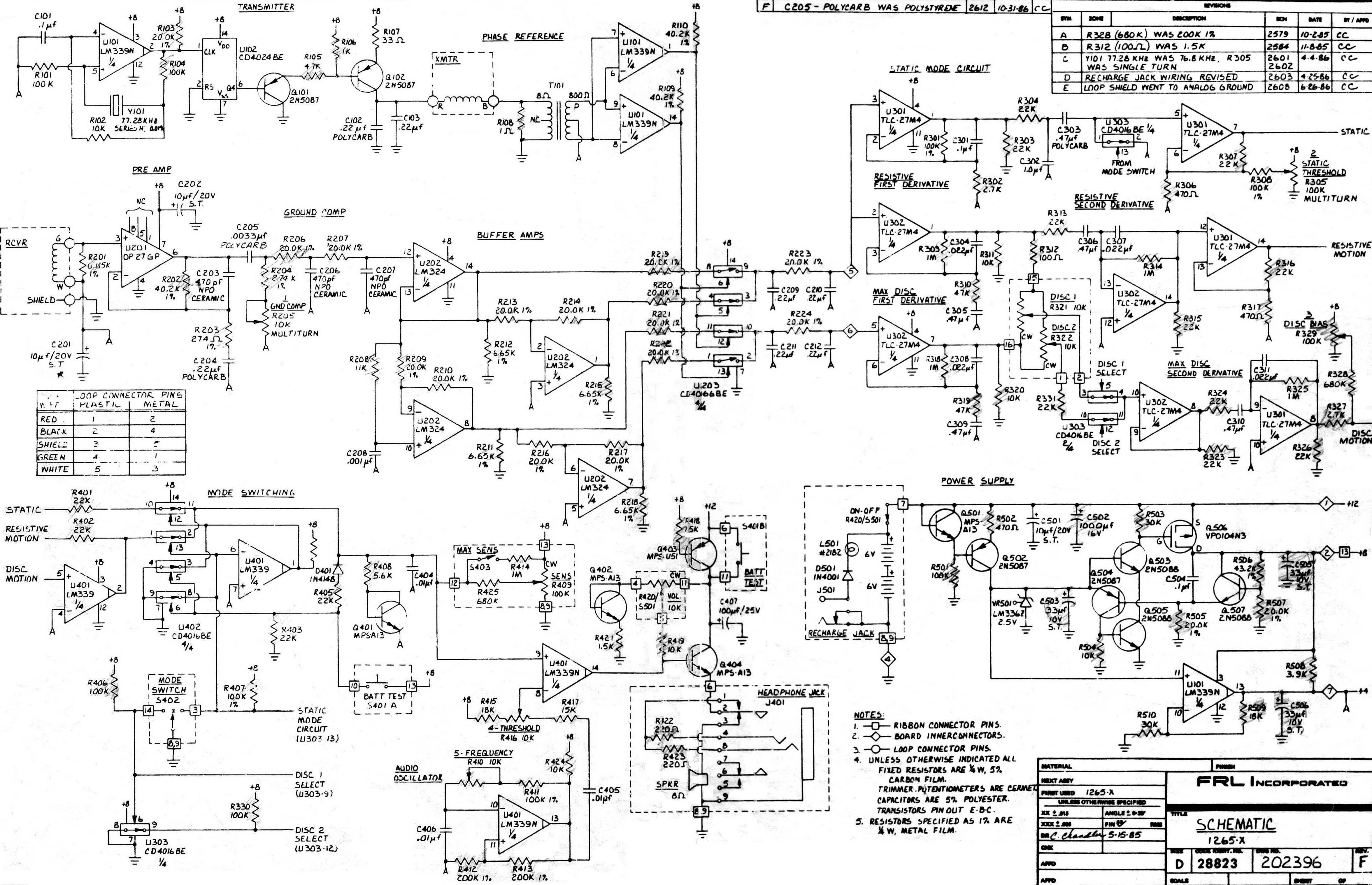

    Can someone point me in the right direction
    Disk 2 works fine all the time
    Disc 1 works only after the machine has been on for several hours. Until then it gives a continuous beep
    All metal mode I believe should be no motion. It isn't. Pull the trigger and the tone dies in a second or so
    Changed the switch still the same.
    Original is a dpdt but only one side is used?

            The slight problem got worse.
            Unit stopped working.
            Quick examination and the FET has blown. Not got round to changing.
            There is one on the spare board. Slightly confused as the D,G,S should be 180⁰ out according to the data books but the legend on the FET has them the same as the original VP0104N3
            Anyhow not looked at it to carefully yet need to clear some other projects out of the way first.
            Seen the original schematics. Unfortunately I can't read most of the writing on them.
            Can't see why the FET would blow either. With upright components there are a few areas were components get very close to shorting less than ¹/₂ mm but even if they did it wouldn't cause a power jumps.
              No Idea where I gathered this schematic from, here I'm sure . It's quite readable if opened in Paint.
                  [ATTACH]40752[/ATTACH]
                  Cheers can read that one better. At least I should be able to get the power supply up and running again.
                  Looks closer to my board than the one I found.

                    Many thanks. Downloaded
                      Opened in MS Paint it's more then readable. Wish all I had did that.
