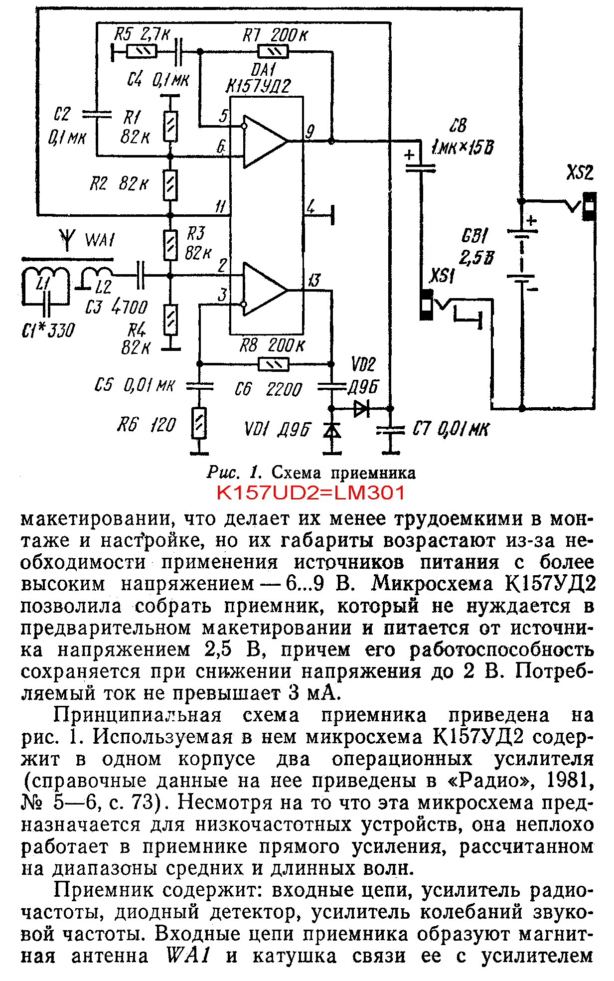

Hi Corny, (>:O/]
*CA3035 OR CA3935*??
I HAVE did offer to change the CA on two opams
(or at the best of a way, on heterodyne cheapest China receiver).
I have a magazine shematic of simple 1-V-1 receiver, similar to that I means of.
Are you need?.. I can scan it but only tomorrow.

Do you think we can use a simple radio receiver?
Thaks KT315 for your help. Because you mentioned the china receiver, do you think that in the schematic of the two box we could use in place of the receiver a normal radio receiver adjusted to 100 KHz (or what the transmitter sends)? It would be very interesting.
