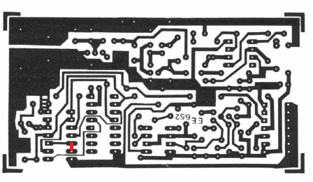

    You was provided with the corrections. U1 Pins 12, 13 need to be connected NOT as the documents PCB is provided. The Schematic in the document it was said is correct so your transistors need to be oriented as the same. Don't use the Layout Diagram for the Transistor as it was stated they or some are in Error.Click image for larger version

          then why people say it's working I made the project with corrections but beeps without any changing in frequency near or far from metal I used 24 rounds c oil of 0.4 mm tick wire
          is the circuit sense the changing risistance of the coil or something else
          if it's resistance I can try many resistance with differente values and see if any change in freaquency appear
          any sujests are very welcome
            DID you Use 32KHZ oscillator(very important) or better yet 40KHZ Oscillator crystal. 25KHZ may be too low. Also did you use LM318 Hi speed op amp? Check your power supply. Are you getting 18volts? Post picture of your circuit board top and bottom.

                No, it is a Pulse Induction detector so exact frequencies is NOT critical.
                READ up on PI detectors.
                  No, it is a Pulse Induction detector so exact frequencies is NOT critical. READ up on PI detectors.
                  I built this years ago and I'm just getting back into it...Of course the timing is important, even in a PI because this determines your sample period.
