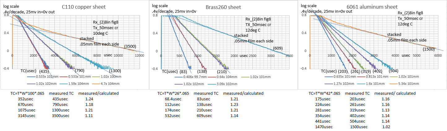

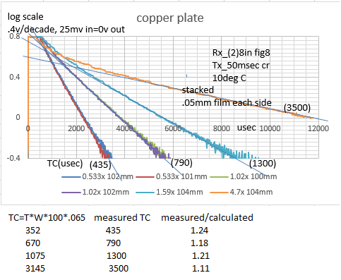

  • Ordered some metal sample packs to test other than foil. Tested the C110 copper sheet pack today, approximate 4x4 x .016, .021, .032, .04 and.0625inches. Recorded the data and didn't see 5 decay lines. Received (2).021, (2).04 and (1).0625 plate. Recorded the 5 plates stacked also. Plates have a .05mm plastic film covering them so not touching. Didn't know if %IACS would be close to 100. I have a 99.9% copper coin that calculates %IACS<100 with .06 multiplier and Carl had less than 100 with his test of 99.9% copper, reply#253 nugget simulation thread. Calculated TC assuming 100% and with multiplier .065, looks like .065 is to high or some other problem.
    Have a Brass260 and 6061 aluminum pack to test yet. Some .0007inch(.0178mm) and.00135inch(.0343mm)C110 copper foil coming to test. Not sure what will learn with the brass and aluminum packs, multiplier and %IACS?

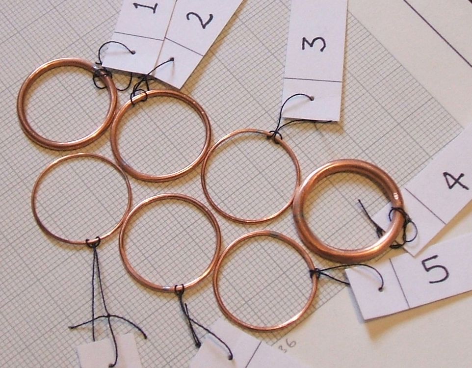

      I've made a selection of nice '20mm' copper rings. Trawled through some big maths for inductance calculations ( which make no real difference ), and surprisingly, I get a pretty good agreement with the theoretical TC value. Well, for the modest sized wires, anyway. The chunky wires make nice-looking rings, that were hard to manufacture, but show very clear signs of skin effect.
      I'll hold back on the details, until I've sorted stuff out, but my measured TC's were +6% over theory. I've not allowed for solder-joint resistance.
      Attached a pic of the rings:

        Wire length for straight wire testing didn't effect TC after a few wire diameters(don't remember how many diameters but could test to see)Cut wire length for rings, 63mm(20mm diameter), 94mm(30mm diameter)or 126mm(40mm diameter). You rings look good. Did you start with a fixed wire length and then make ring? My measured was over calculated, solder joint resistance should make TC less than calculated. Including the chart with my 20mm diameter rings.
        Charted the other metal samples I got. I'll try a 100mm square of heavy duty aluminum foil tomorrow. Looks like .065 multiplier is to high for my tests today. Not sure about %IACS for 6061 aluminum and 260 brass but copper shouldn't be over 100. I'm struggling but maybe I'll figure it out. Still have some copper foil coming if foil is causing the problem.

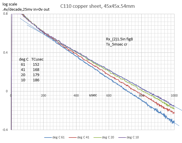

          • Temperature effect on target TC. Cut a piece 45mm square from one of the copper sheets reply#138. Covered one side with masking tape to aim infrared thermometer at for recording temperature. Heated target with a heat gun, placed target above coil and recorded four temperatures as the target cooled.

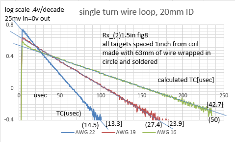

            • All my rings were made by measuring the correct straight length, then forming it around a plastic rod, then fine-tuning with pliers to get the ends matching. With the exception of the 2.44mm wire one, which was made 7mm longer on each end, the cut points scribed on. It was then bent on the former, and then cut /filed to the marks. The last 5mm or so of a loop is the hardest to bend, making it 'over-long' gets round this.
              I've since made two additional loops from smaller diameter enamelled wire, to fill in the gap at the bottom end. I'll try and locate some heavy gauge enamelled, it's in a box somewhere ....
              Yes, I made some 19mm long straight wires. The bad news is the thinner wire ones give too little signal to get any accurate measurement. I was also expecting the thickest ones to also give misleading readings due to skin-effect. However, I did get 4 points on a straight-line graph, and you won't believe this , but they match the equation:

              • And a quick straight-line plot of the temperature change on your test plate shows a decent fit, with the exception of the 61C point, which appears to match an actual temperature of 72C.
                (Plotting TC-1 against degrees C , straight-line at correct slope rate)

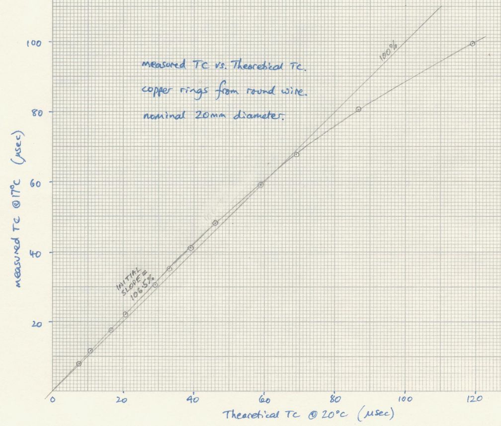

                  • I haven't completed my promised plots, as I wanted to get some extra wire sizes to fill in some gaps, particularly for larger diameter gauges. I have been successful , I've made three new rings and four 19mm lengths, and they are great fits, with the exception of the 3.00mm diameter '19mm' which is odd, more investigation needed on that one, but I don't think its pure copper, it seemed a bit 'springy'.
                    But the '19mm' TC values are excellent, a cracking straight-line, showing TC = 0.029 D2 %IACS , not a hint of skin-effect.
                    The rings also chart great up to about TC = 50 usec , where measured drops down vs. theory. I assume this is mostly caused by Resistance increasing due to skin effect, though Inductance is also slightly affected by it.

                      Looks like you are getting good results. 2mm wire is the largest I've tested, will get some larger wire next time to store.
                      What size wire were you using for the 50usec TC ring? http://www.geotech1.com/forums/attac...2&d=1547342322 chart I posted above, AWG#16(1.29mm diameter)tested about 50usec for me and showed some skin effect at start of decay.

                      • I don't have an actual 50 usec ring, that was just an estimate of the point where measurements start to deviate from a straight-line, and it's probably more like 45 usec.
                        The actual readings near that value are for wires of diameter: 1.23mm, 1.35mm and 1.58mm, measured and calculated values for these were:
                        D = 1.23mm ; Theory TC = 39.15us ; Measured TC = 41.05us
                        D = 1.35mm : Theory TC = 46.1us ; Measured TC = 47.7us
                        D = 1.58mm : Theory TC = 58.9us ; Measured TC = 59.05us
                        The best-fit line for the smaller-diameter wires ( up to 40us TC ) shows: Measured TC = 1.06 x Theory TC. This could be 1.05 if test temperature ( 17C ) was taken into account. But you can see the 1.35mm wire is dropping off, being 1.035 x Theory, and for the largest 2.44mm wire measured about 0.84 x theory ( 99.6us vs. 119us ).

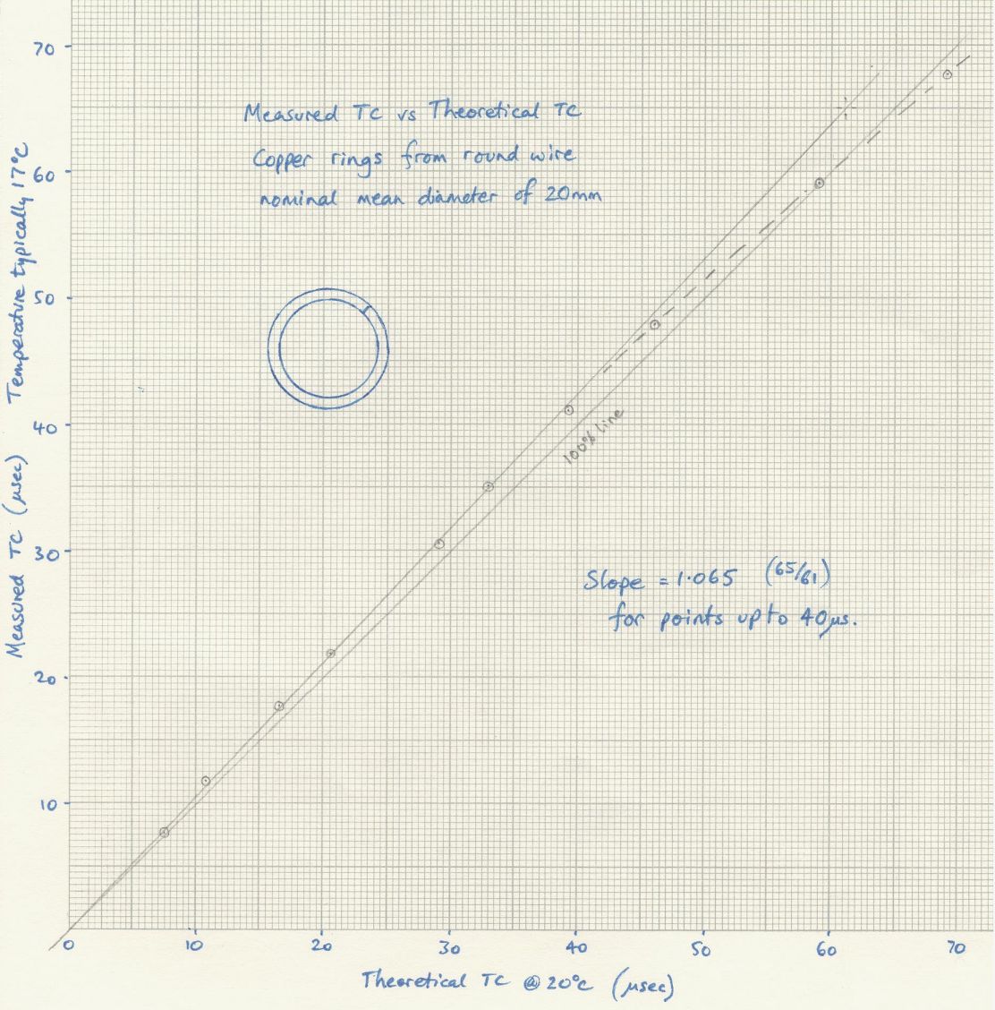

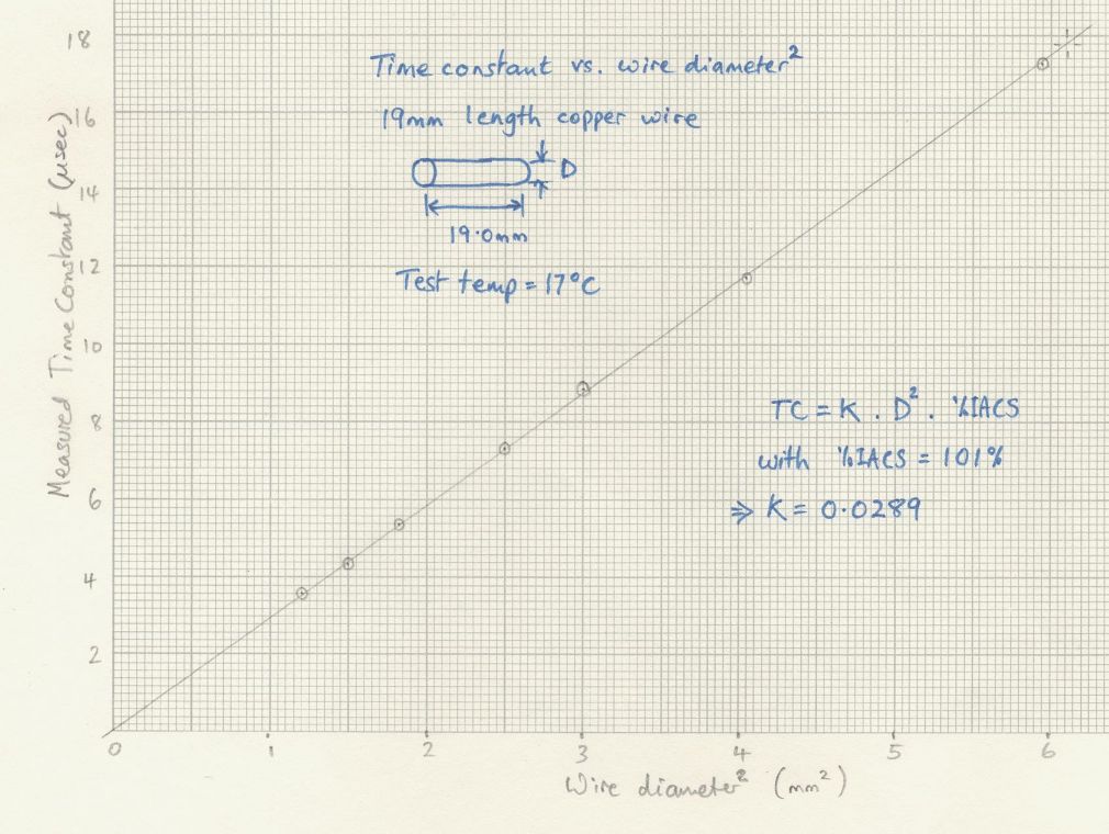

                            • So here is the 19mm long wire test graph. Wire diameters used were:
                              1.10; 1.23; 1.35; 1.58; 1.73; 2.01 and 2.44mm
                              As the test was done at a temperature of 17C, I used a figure of 101% IACS in the maths. I assumed the wire was 100% IACS at 20C. ( I will have a go at testing some of the wire samples, to see if they really are 101 - 102% as some sources say )
                              Gotta say, it's the straightest graph I've plotted for a while , and I was expecting the fat 2.44mm wire to show some skin effect and spoil it.
                              Still, the end result is K = 0.029.
                              • And here's two graphs for the '20mm' diameter copper rings. One shows all of them, clearly showing what I assume is skin-effect ( 13kHz VLF used ), and one showing the smaller gauge wires in more detail, to show the decent straight-line.
                                Twelve wire diameters tested in total:
                                0.46; 0.57; 0.73; 0.83; 1.02; 1.10; 1.23; 1.35; 1.58; 1.73; 2.01 and 2.44mm.
                                All were bare copper electrical grade wire, the two smallest were enamelled.
                                The 'theoretical' figures assume conductivity is 100% at 20C ( 58 x 106 ). The tests were done at a temp of about 17C.
                                The slope for the smaller gauge wires is about 1.065, ie. 6.5% above theory. 1% of this is down to temperature, so it's really 5.5% above theory.
                                The other 'errors' I've discounted. The solder joint is maybe 0.1mm thick, roughly equivalent to 1mm of copper, so the loop resistance is increased by (63+1)/63 = +1.5%. But if this is wire with IACS of 101 - 102%, that roughly cancels the solder-joint resistance.
