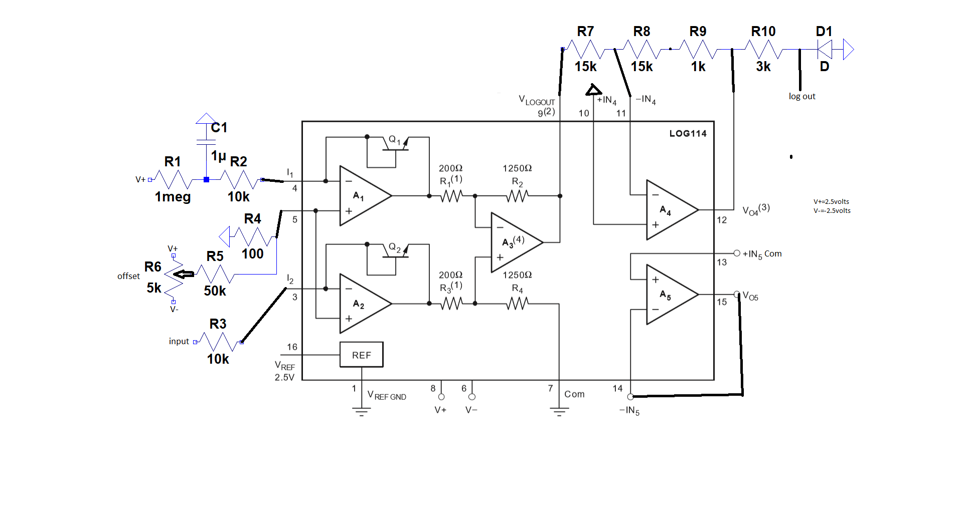

      Thanks again for your help. Building the log amp in spice helped to understand what I needed to do. When testing the log circuit the other day I would sometimes get more than 800mv log out. 2.5 volts in(+PS) should be 800mv log out. After more time than it should I finally determined the scope over ranging was causing the problem so I added a resistor and diode to clamp the output going to far negative. Wasn't thinking when trying the capacitor decay, the clamp was causing the problem. Including schematic of log amp, if I had done sooner someone would have seen the problem. The 1usec decay looks like it could be better, need to try higher current. The diode is disconnected from common for todays tests. I tried a amplifier(offset adjusted to less than 20uv)between the capacitor discharge and log amp yesterday and it worked after lifting the diode. Today I tried capacitor direct to log amp and didn't see an offset problem.
      I tied pin 1 of LOG114 to V- instead of common, forgot to change schematic. Not used so probably doesn't matter.

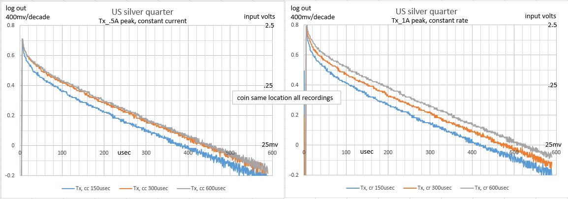

              I just thought I would run a plot for the silver quarter and clad quarter and here is the result. The top trace is for the two quarters and there is little difference. The midde trace for comparison is a US copper penny. The third trace is a US Cent.
              Ignore the rulers and figures as I did not cancel them, and the graph is 500uS full scale rather than 1000uS in the previous ones. The quarters have not yet reached zero in this plot.
              [ATTACH]42249[/ATTACH]

                Wondering how your log amp is working. I lowered the input resistor like you and Skippy suggested. Looks better. The mv/decade changed so I had to make the gain adjustable. Doing some testing, will post some data when I think I've got it best I can.

                  I've had a read of the LOG114 datasheet, seen a few things of importance, and come up with a few suggestions.
                  They talk about 8 decades range --- this is for CURRENT, if you put in volts through a resistor to the virtual ground, it performs badly, as the virtual ground can be 4mV off, the datasheet says 3 decades range only, eg. 10 Volts -> 10mV.
                  So you're going to have to drive it hard on the input, but not above 3mA or it goes 'off'. I suggest, based on your input voltage max being about 1.6 Volts, you have this drive 1.6 mA into the IC. Hence choose the input resistor (R3) = 1k0.
                  For your 'zero-volt' output, I suggest you choose this to occur at input current of 10mV. Hence your reference input current needs to be (10mV / 1k0) = 10 microamps. (eg. 250K to +2.5V rail)
                  Your output scale factor needs increasing, I suggest 800 mV / decade, which means post-amp gain of 2.13333 . (for example 4K7/2K2; 10K/4K7; 12K/5K6; 16K/7K5 ) .... the last one is easiest, just add another 15K across your existing one to make 7K5.
                  This would give a maximum logamp output of about +1.7 Volts, I assume it can do this from 2.5V supplies? And minimum output would be equivalent to 25 microvolts.
                  If you need more range, you're going to have to consider a voltage-to-current converter, that can be done with a modest opamp circuit, a Howland source:
                  http://michaelgellis.tripod.com/howland.html
                  (I've never tried it, the V -> I converters I've previously used were ones with a transistor in the loop, but they were sinks, not sources)
                  In addition, if you split resistor R5 'in half', eg 24K & 24K, you could decouple the tapping point to ground with a 1u capacitor, similar to the reference input circuit, and reduce noise injection.

                    More data with higher log amp input current. Changes to log114c.png, R1=200k, R2=2k, R3=2k, R9=1k pot(adjust log out volts to 400mv/decade) and D1 not connected to common.
                    The capacitors were connected to the R3 input and common. A 1N4148 anode was connected to Tx command(+-2.5v step signal), cathode to R3(log amp input). When command signal goes to -2.5v, capacitor discharges into the R3(2k input resistor). NPO ceramic capacitors, don't know how close they are to rated value.
                    Need to get PI coil and amplifier to decay to zero volts faster to get 2 decades of straight decay with short TC targets.

                      I was posting reply #69 while you were posting #68.
                      The input can go as high as 2.5 volts. Tried 2k input resistor which gives 1ma at 2volts in. R6 in the schematic adjusts offset.
                      I'll think about the other suggestions, something else to do right now.

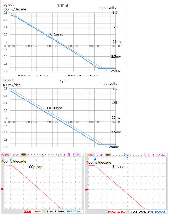

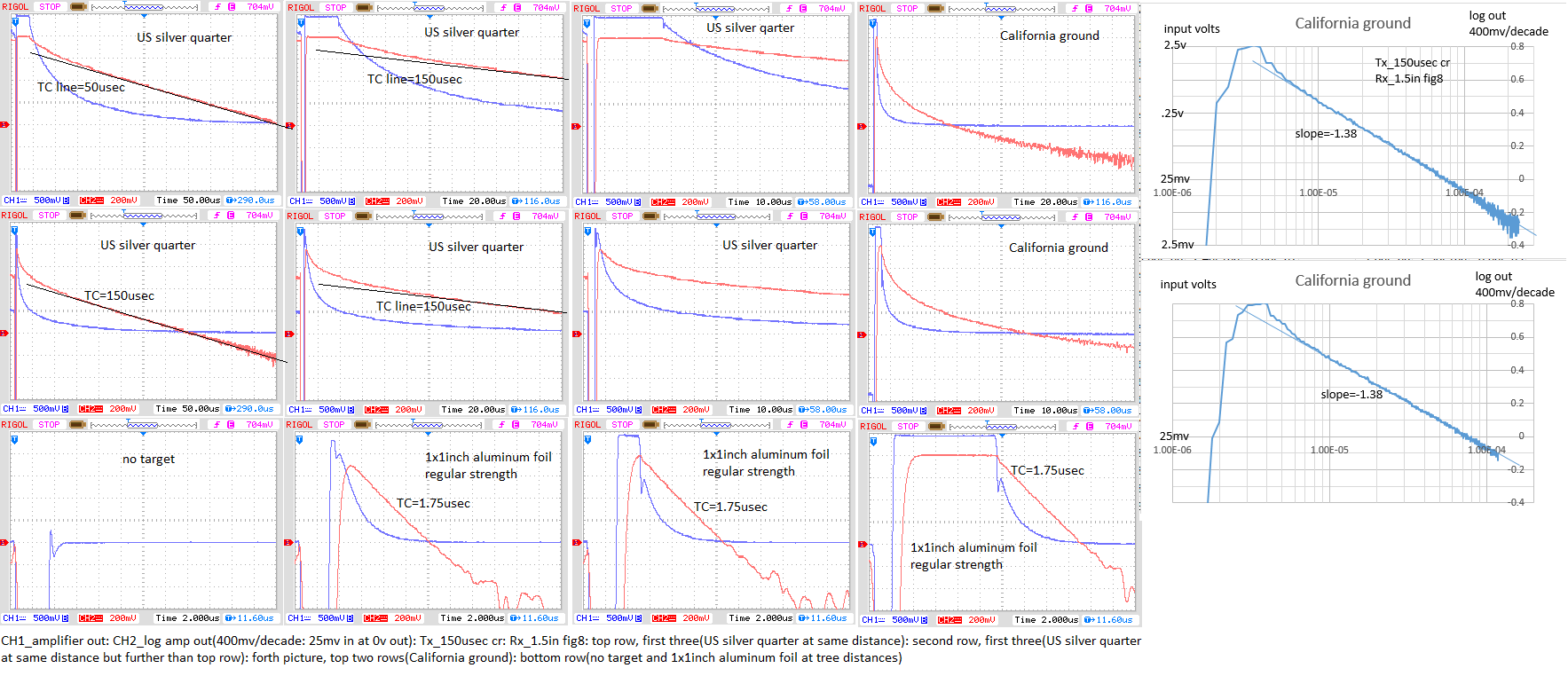

                              More test data. Charted the quarter at two distances, one amplifier saturated for about 30usec and another with amplifier not saturated. Three different record times. To determine TC, record time should be 4 or 5 times target TC. With the detector I'm building the target sample + ground sample is taken in less than 150usec. It's hard to see what happens the first 100usec where the decay isn't straight line decay with 600usec full scale. Trying to determine the best scaling and if saturated or not saturated amplifier is best.
                              I get a glitch in the no target picture that shows up in some of the other pictures, not always at the same signal amplitude. Two of the foil pictures it peaks at about 1.5volts, with some of the quarter amplifier saturated pictures glitch is near full scale. Any ideas what is causing it or how best to determine what is causing it?
                              I'm starting to like the log amp vs the way I was charting the data.
                              Charted California ground with Excel to get log X scale.
                              I see the first picture shows 50usec line instead of 150usec line like it should be.
