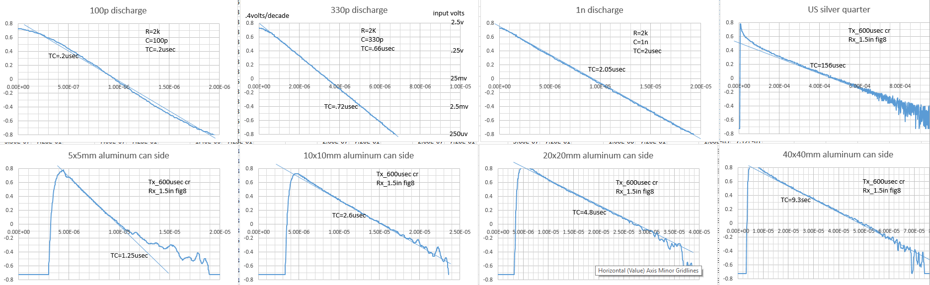

      Trials with slightly different pulse shapes and pulse durations exhibit a calculated scatter in the power law ranging from -0.8 to -1.4.'
      The pulse used to obtain -0.99 was 370uS wide of which 320uS was cc and a switch off time of 2uS. From Eric's reply #84.
      I have gotten power law ranging from -1 to -1.4. Wondering what would cause ground to be less than -1. The two grounds I have chart the same slope if the Tx pulse is the same. Longer TC targets with skin effect chart straight line decay on log X log Y charts with slopes less than -1 out to near there TC where they have straight line decay on linear X log Y charts.
      Looking at added chart, near there TC might be the wrong words.
      Haven't tried different switch off times. Could that be causing a big slope change?
      I am happy with the log amp, wish the preamp had less noise.

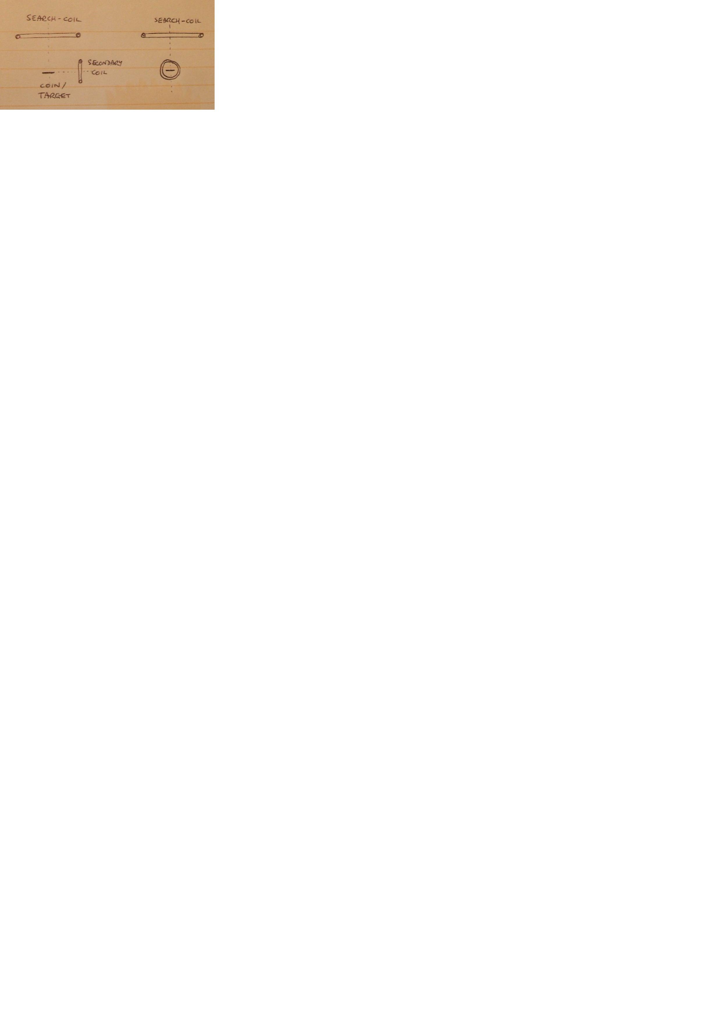

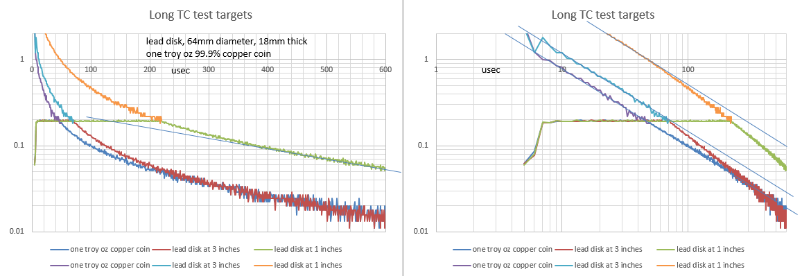

        I've thought about the thick lead disc vs. the 1 ounce coin ....
        the circulating currents in the flat coin will be predominantly in the one flat plane; they will be that way initially, and will stay that way as they decay, hence the uniform 'slope'. The bulky lead disc may start off with currents circulating mainly in the plane, because of the way the detectors' coil / magnetic field pass through the sample. But it seems likely that they may not stay circulating that way, and could easily end up flowing in loops in a perpendicular plane, ie. through the bulk thickness. The currents will still decay (as the lead has electrical resistance)... but the magnetic field they generate will not be picked up (or picked up much less) because their plane is perpendicular to the detectors coil. It's the "coin-on-edge effect", on a microscopic scale.
        This is just a thought .... I'm not sure what particular experiments you could try, to understand the behaviour. Would a second coil, at right-angles to the flat disc/ 1 ounce coin give the answer? A drawing would help explain ... the second coil is on the same plane as the flat coin, but oriented so it sees the coin as 'on-edge'. Edit , attached pic.
        And regarding your response tester: I was thinking of other ways to clean up the noise on your charts.
        It's not hard to implement a simple ( or not-so-simple ) digital filter in Excel.
        A simple one to try is: Filtered sample value = (0.25 x Previous sample value + 0.50 x Sample value + 0.25 x next sample value)
        Example: if you have samples s3, s4, s5 etc chronologically
        then your new samples would be: S4 = 0.25 x s3 + 0.5 x s4 + 0.25 x s5
        You could create dummy values s0 = s1, and slast+1 = slast to make the first/last S data points less duff.
        ( did you try the low-pass filter on the 'reference current' input of the log-amp, by the way?)

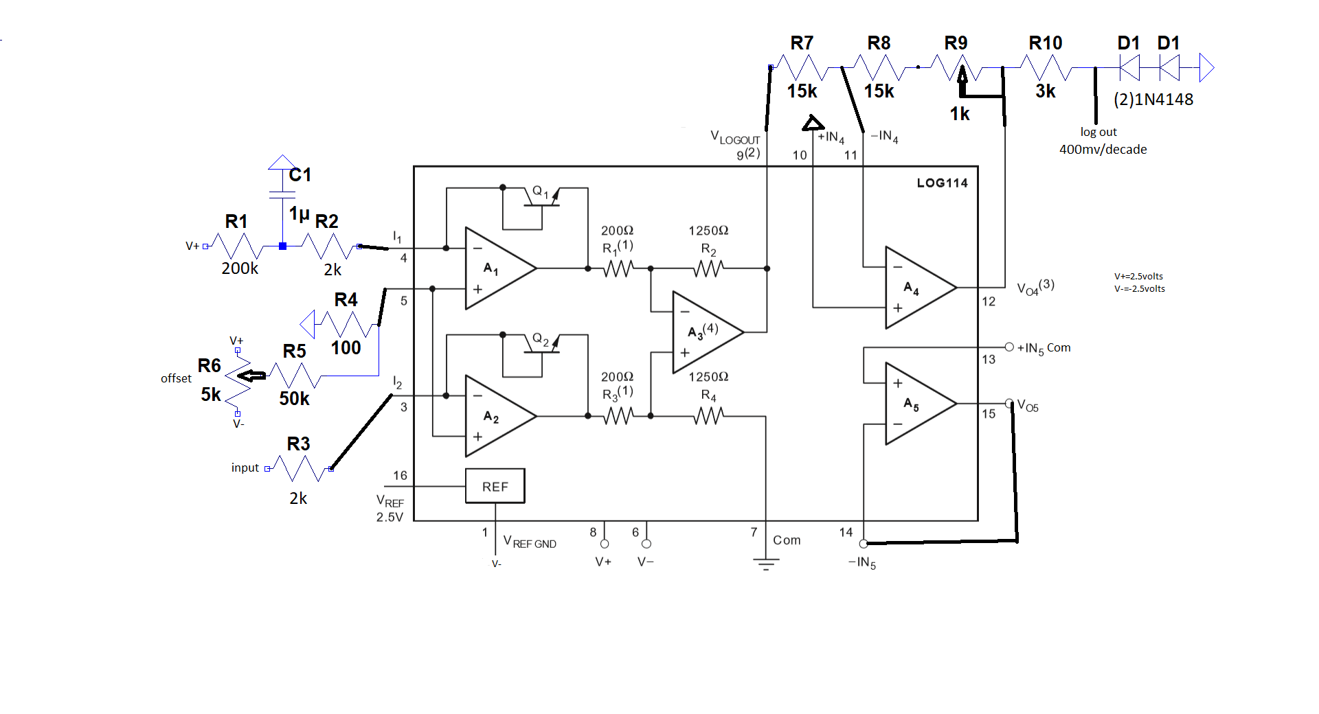

          Present schematic of log amp. The 2 diodes(D1)on output prevent a problem with the scope over ranging with .2v/div when log amp out goes to -2.5v. I'll try some of your other suggestions.

            I made an error in my previous post, it wasn't the 'reference current' input, it was the offset trimming circuitry, specifically splitting R5 in two and decoupling the tap to ground.Example 27K & 27K, with 10 uF cap.
            Also try a low-pass filter with the output opamp, add a cap across the 16K (15+1), probably something quite small, 220pF may be a place to start, it will be obvious if it mucks up the output curves, particularly the fast decay ones.
            • #96
              I was thinking R4 and R5 are in parallel so the input resistance is less than 100 ohms and splitting R5 wouldn't make a difference. The noise is coming from the preamp and coil, no noise with capacitor input decay(4 decades)

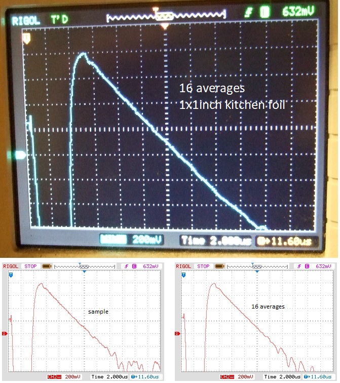

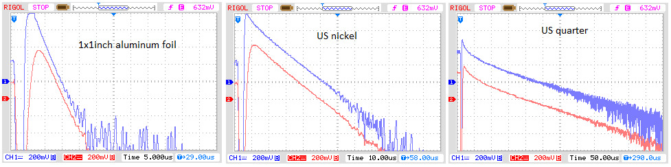

                Some pictures of 1x1inch regular strength aluminum foil. Did a test the other day where I was thinking operating the scope on average was helping, didn't think so before. Average does work on the scope screen but not storage unless I'm doing something wrong. If I were to purchase another scope I would look for one that averaged storage.
                      Hi Skippy,
                      Let me try this again. When I started with the log amp I picked 1 meg reference input resistor. If a 1k input resistor can cause a noise problem on the preamp maybe a 1 meg input resistor could cause a noise problem with the log amp. The reason for adding 10k in series with a 1u capacitor from junction to ground. Hoping to reduce resistor noise. Wasn't thinking of other benefits like reducing PS ripple and maybe others. What was your reason for splitting R5? I haven't been calculating noise level, not sure I know how. Let me try a couple of examples. Someone can correct me or give an example on how it should be done. Preamp: 1MHz response, gain=450, input noise=1nv/rt Hz. Input noise=1000000^.5*1E-9=1uv RMS or 6uv p-p. 6uv*450=2.7mv p-p output noise. A 1k input resistor would have 4 times the noise. Log amp: 1meg input resistor, noise=1000000^.5*140E-9=140uv RMS or 850uv p-p. If I wanted 4 decades with 2.5v input full scale, 250uv to 2.5v the noise level would be greater than the minimum scale. With 200k input resistor I ended with, 1000*60nv*6=360uv p-p still higher than the minimum scale. Don't need 4 decades because of preamp and coil noise so maybe adding the capacitor and resistor to the input wasn't necessary. Not sure any of this is correct or makes sense. How much lower than the minimum scale should the p-p noise level be?
                      Haven't tried the 220pf capacitor yet but I would expect 48kHz cutoff to effect the decay.
                      • "What was your reason for splitting R5?"
                        To reduce power supply noise entering the + opamp input of the logamp. I saw you weren't using the 2.5 Volt internal reference, (due to only using +/- 2.5V supply rails), so I thought the direct use of the supplies to inject the reference current and fine-tune the offset null, may be a possible source of noise. I hadn't seen any specific details about the power supply ... 3-terminal linear regulators? Bench PSU with 60cm long leads to the board? The purpose of using 27K & 27K is to make the capacitor more 'effective'. If it was across the 100R resistor, the cap would need to be large to do anything. Similarly, from the pot wiper to ground would also be low-ish resistance. But ( 27K + C ) would make a decent low-pass filter.
                        However, this is a bit academic, as I hadn't really studied all your charts, and failed to notice the tests with a simple capacitor-discharge were noise-free to very low input levels, a fair way below where you would notice it, due to the larger detector-related noise.
                        The 220pF across the 16K resistor was likely to be too much, intentionally. I was thinking that it would be better to start of with a value that did some filtering, but may upset the response, then reduce it progressively. Rather than start off with 10pF and keep increasing the value until it got too high. I didn't come up with 220pF in a very scientific way, I just guessed that a decay time 0.693RC of 2 microseconds would not be too excessive.

                          • Re: low-pass filtering, you have the option of using the second uncommitted op-amp in the log IC, so you could have dual outputs, such as unfiltered & filtered, or 'mild filtering' and 'heavier filtering', to suit the test / test target in question.

                              • Originally posted by Skippy View Post
                                Used the second amp. 10k to +input, 150pf +input to common, -input and output connected together for output. CH1(first amp)not filtered, CH2(second amp)filtered. CH zero's offset 1 major division. Y axis, log out, .4v/decade, 25mv in=0v out.
