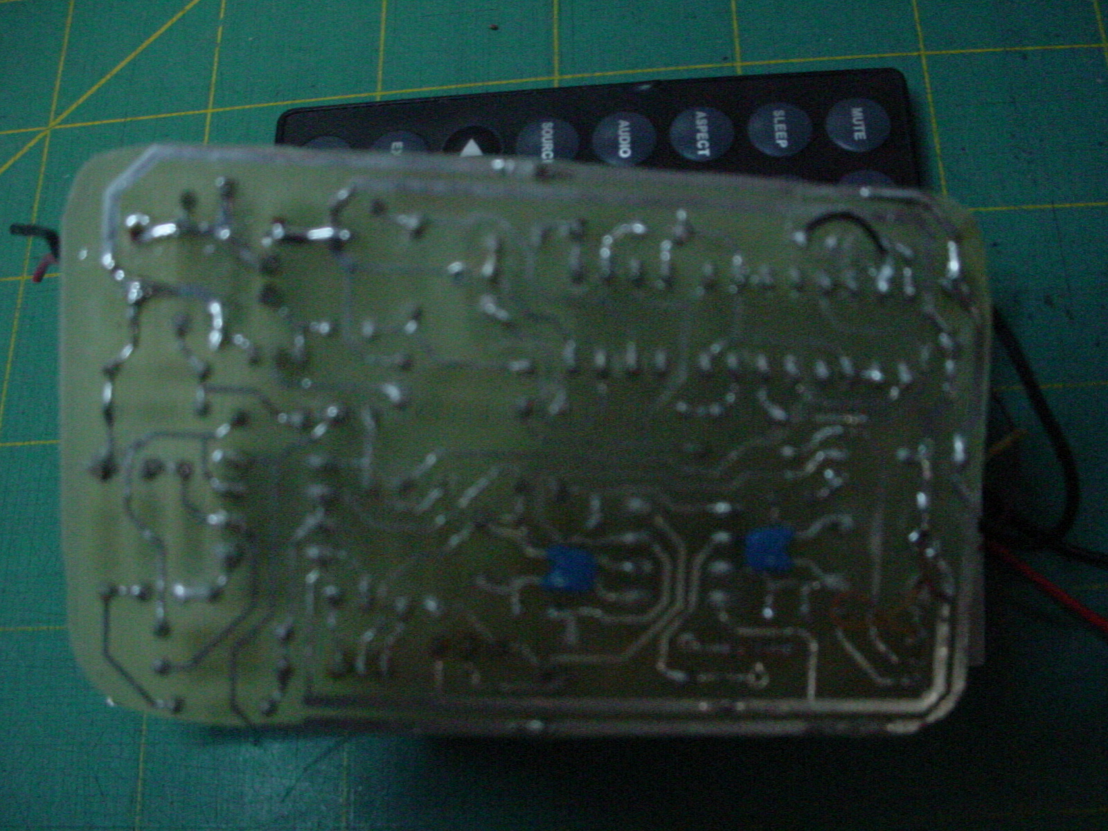

        Tim the small detector is from Moreland and Overton book. I made a pc board, it works but it doesn't set the world on fire. I found a couple of mistakes on the pc board layout. The jumpers installed corrected the problem. I have been having fun with the Hammerhead board which I purchase from WM6. I guess I am from the old school that say's my brain can be a better judge of a target than a pic chip. I have a VLF machine with a 8 bit processor in it, I just don't trust the machine. Thanks for asking Tim, Best to all Jim
        hello James, please be so kind i shows us the corrections on the layout
        espacially i biten out my teeth on the pi-5 project

                    I built the PI Detector from the 2012 edition of the Metal Detector book, I posted my finding of the errors or mistakes on the printed circuit board. The post lasted about 30 to 45 minutes an was gone. I did not use any foul or abusive language. I have no idea who or why it was removed. At this point in time it is a mood point. I still think that this a great board, an enjoy all the folks. Best to all Jim
                      hi James, please be so Kind and post a Picture of your board layout here
                      we can end this mystic, for now and ever

                          I have posted a picture of the board, as I remember there were 2 capacitors, need to be installed, a trace on the IC was incorrect and the transistor pin layout was incorrect. Please can we move on to more interesting issues. This will be the last comment about the little detector. Best to all Jim

                              Which PI design are you referring to?
                              I assume it's either PI-1, 2, 3 or 4, as there was no PCB layout supplied for PI-5.
                              Also, please check the errata list for Edition 1 here -> http://www.geotech1.com/forums/content.php?143-updates
                              Note 10 states: Page 177, Figure 12.21 - PI-1 PCB Layout - the silkscreen is incorrect for Q3.
