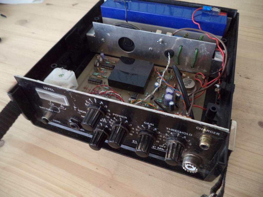

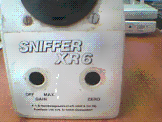

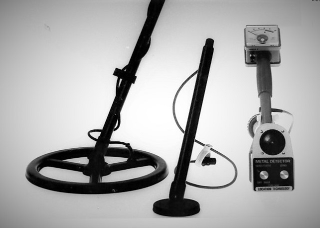

          While on the subject of XR##, there was a question some years ago on this forum as to who designed and made the XR6. Initially it was made by Geo-Electronics Ltd, which was my first UK business in 1970. When I moved to southern Ireland in 1975 and formed Location Technology, I continued the production for a while and later replaced it with a detector called Deepscan. Both of these models were sold to A-S in Germany who labeled them as Sniffer XR6. The electronics is quite different to the XR7 and XR71

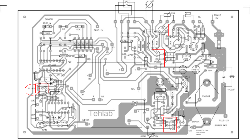

            Hi friends xr7 original PBC or Lay has done the drawinghere you can share

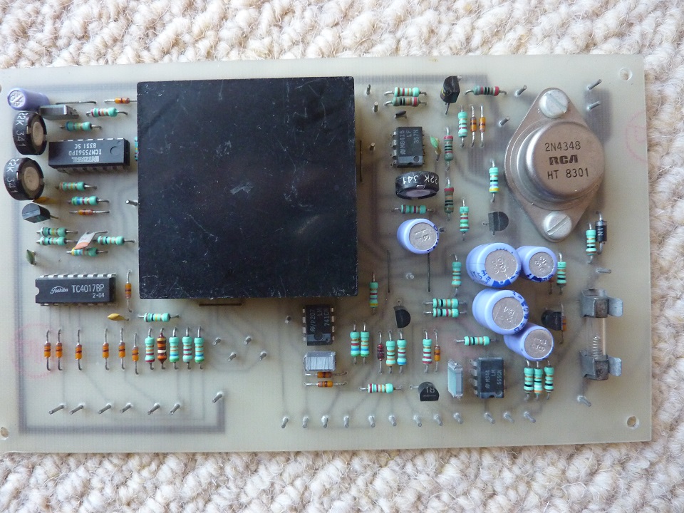

              Does anyone have a schematic for the original XR7 detector? Also a diagram of what controls, switches, etc etc, are wired to the various pins. I have a complete and unused circuit board and would like to power it up and get it working with a coil.
              Thanks in advance for any help.

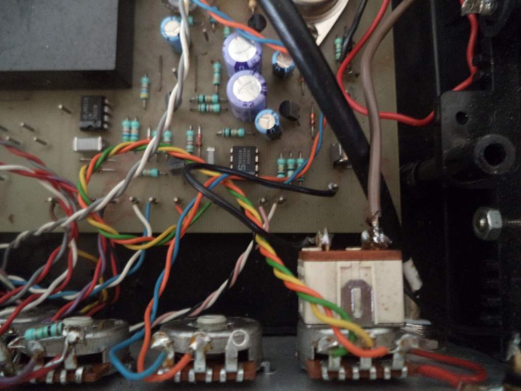

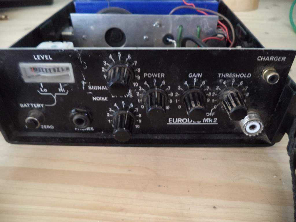

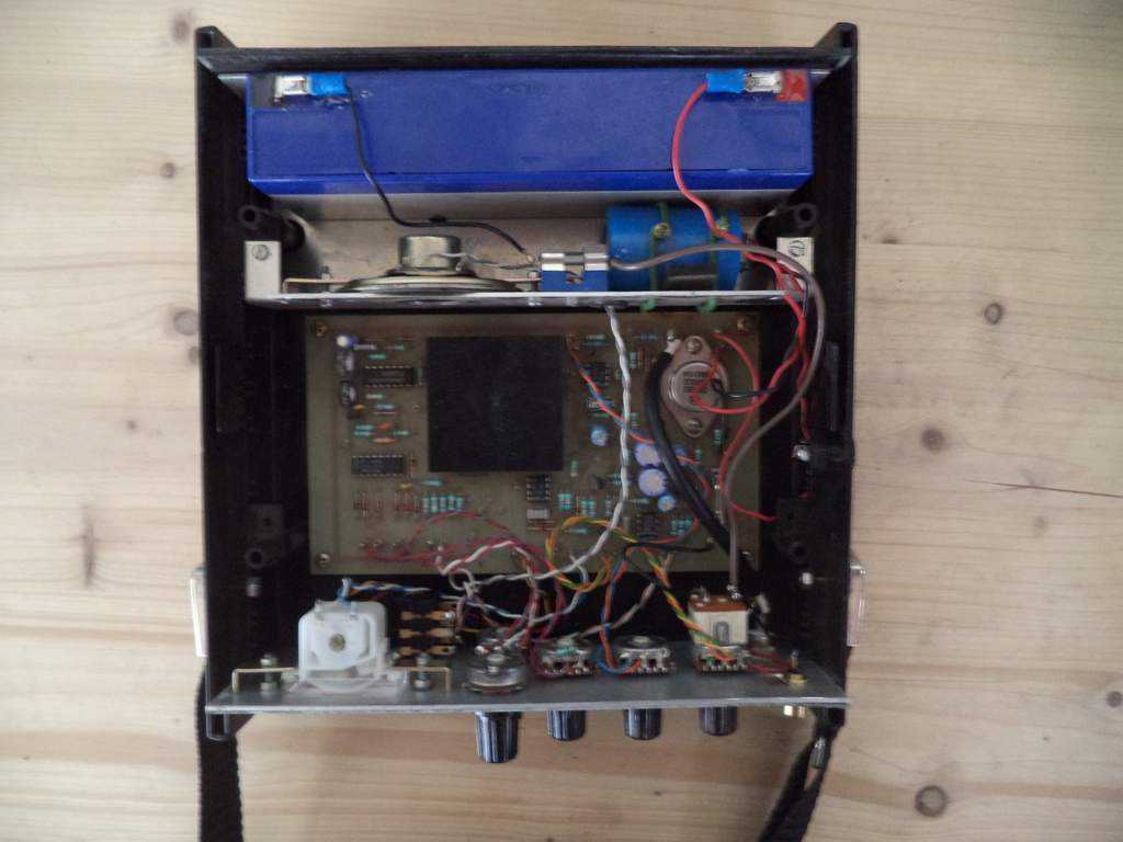

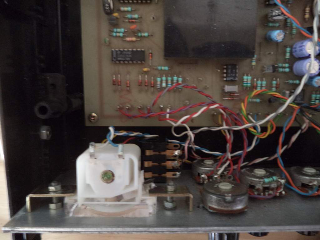

                may be this can help

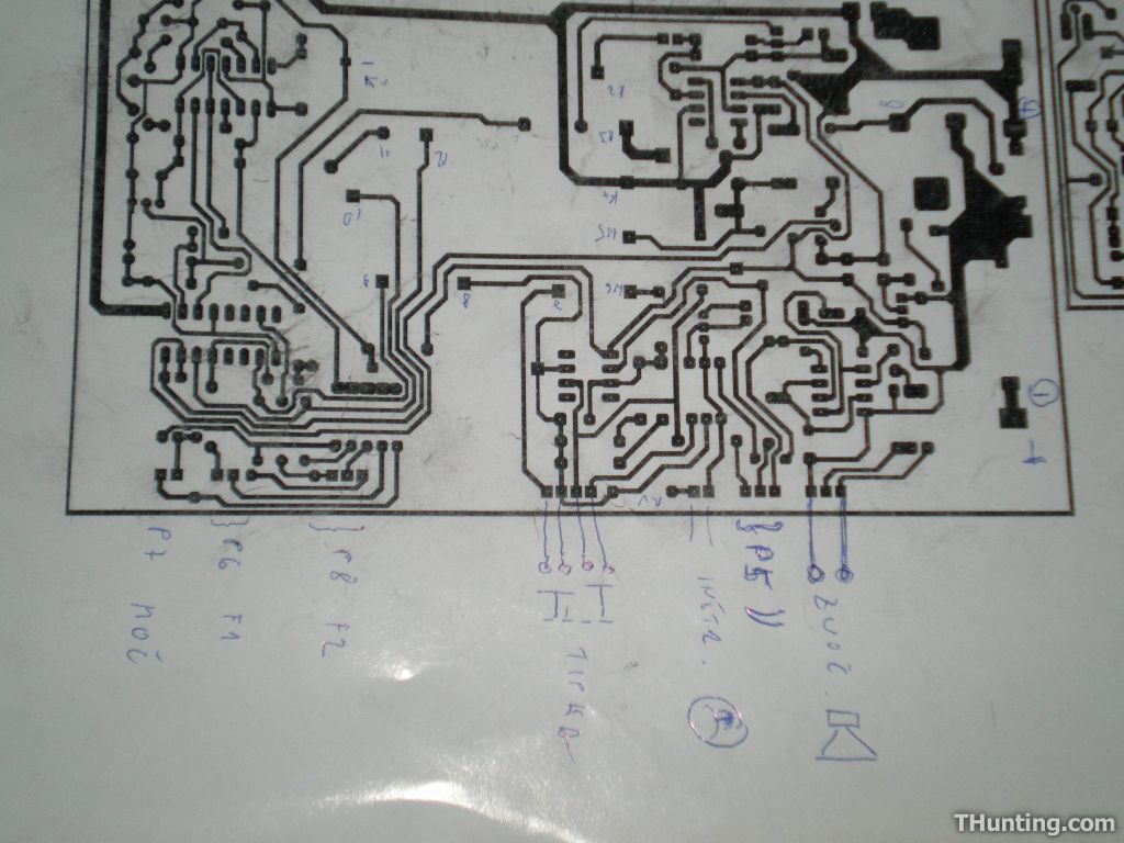

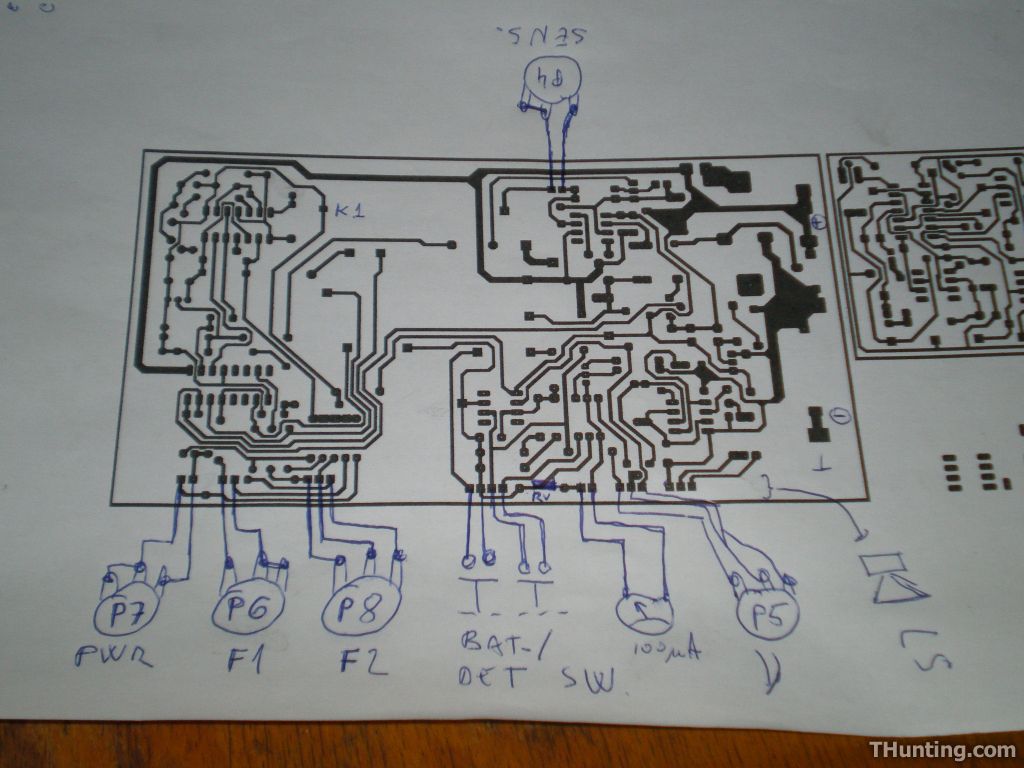

                  Sorry ,i dont have the detector anymore in my hands
                  • #99
                    maybe that i do not sure know
ID:	350671Click image for larger version
ID:	350672Click image for larger version
Name:	dbp comp.1.jpg

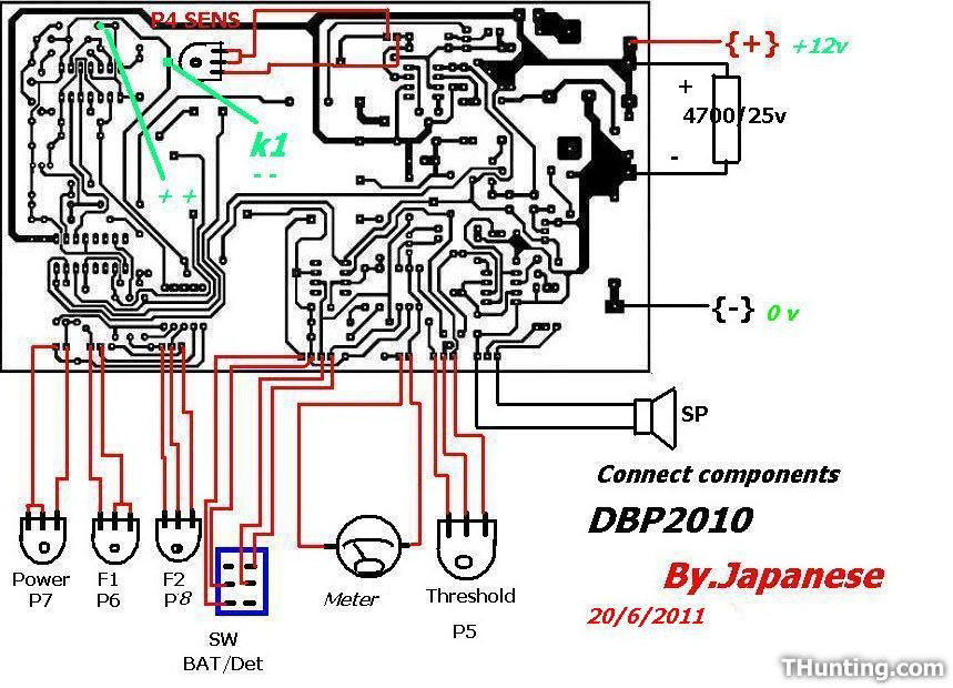

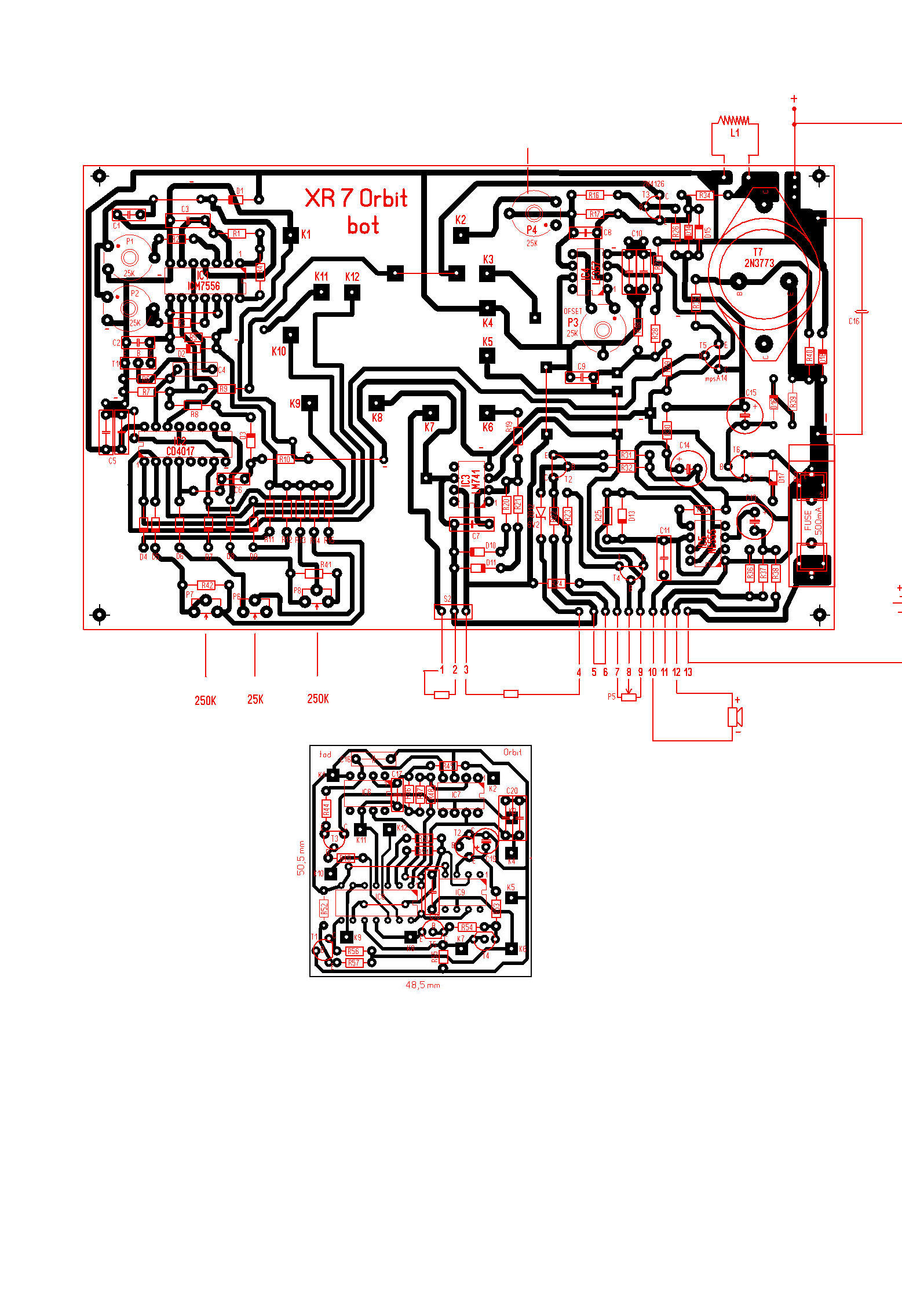

                      • Eric, I belive this is what you are looking for

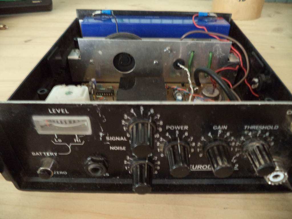

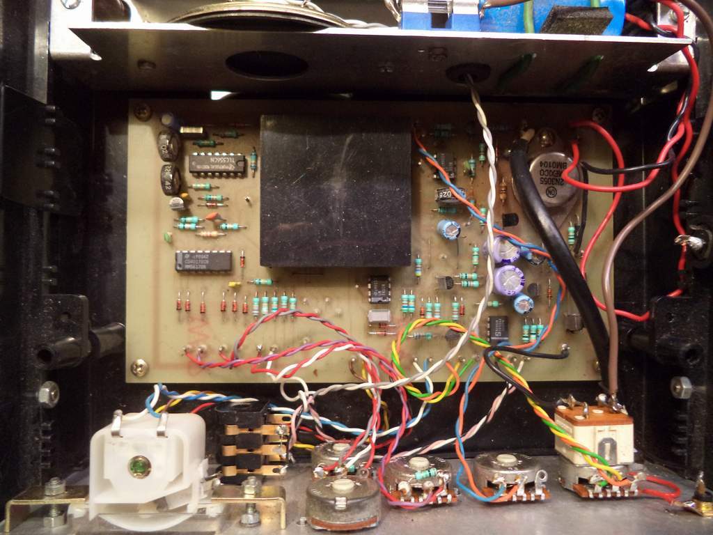

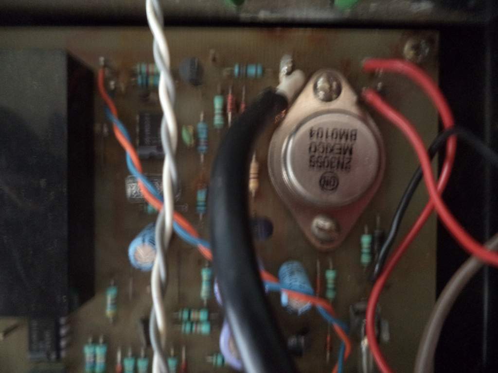

                            I'm afraid the attachments don't open. Your pictures are very useful though.
                            Eric.

                              Sorry, now its ok
