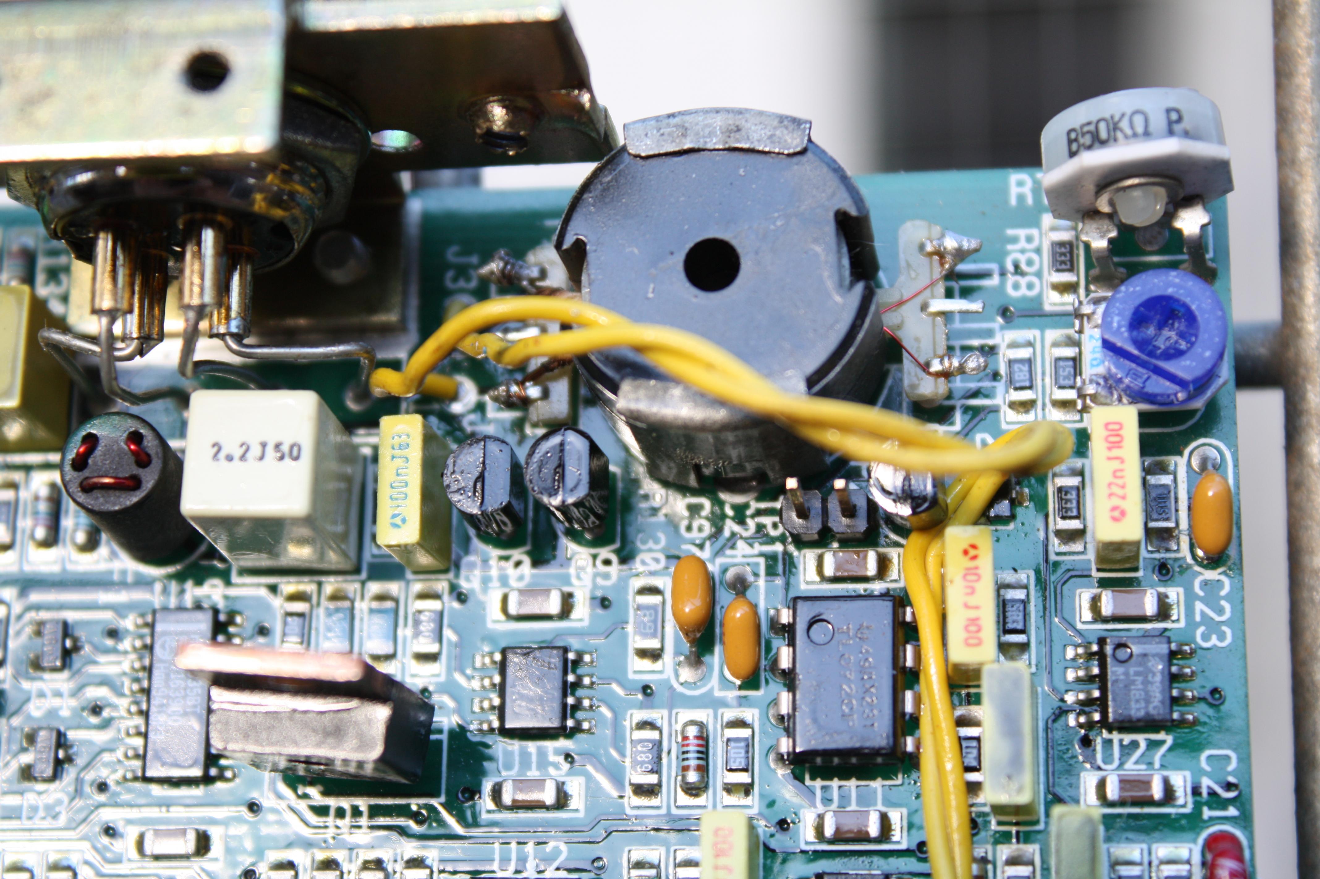

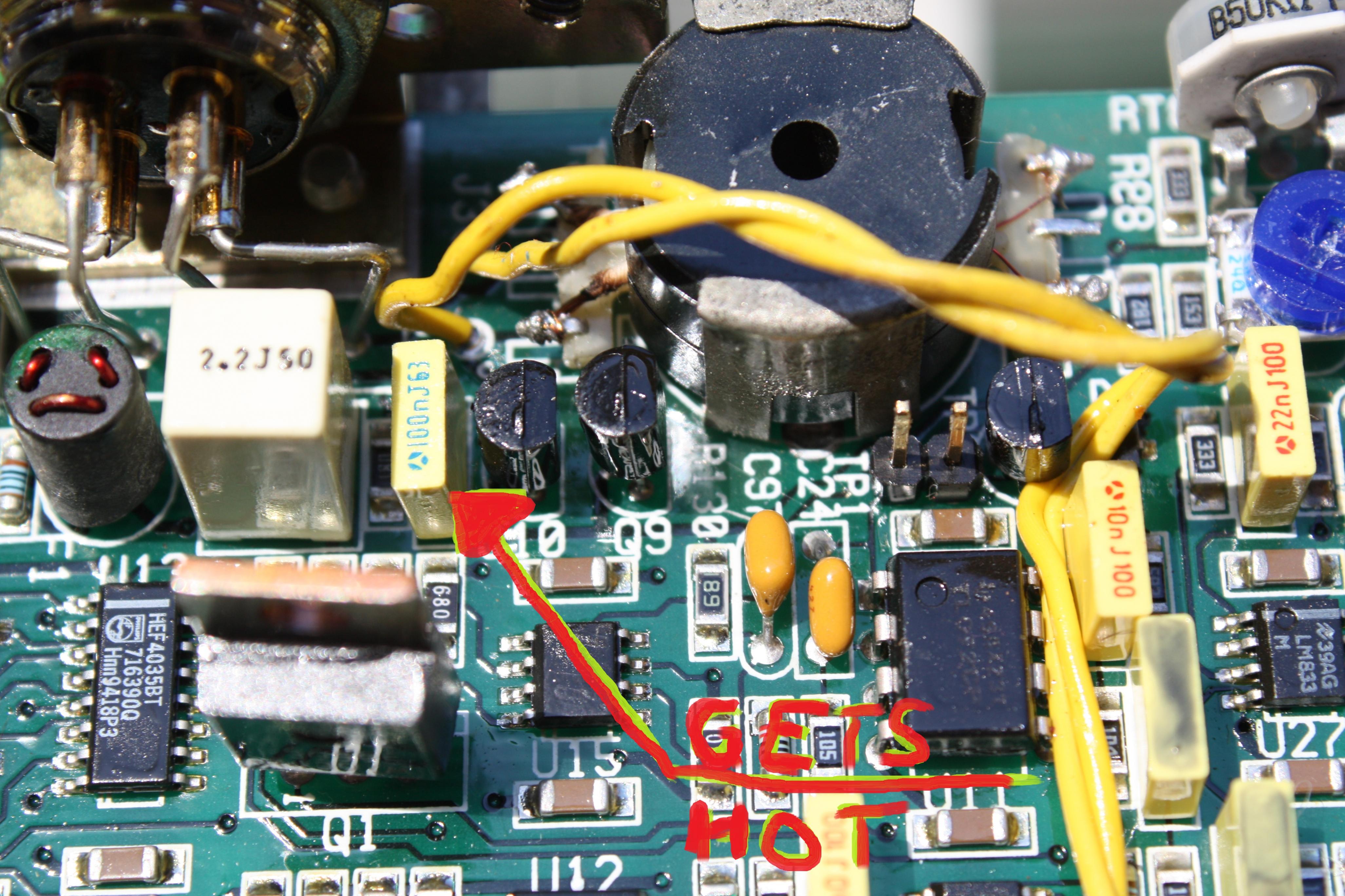

    I'm getting way way out of my leuge on this machine. It has a problem starting up. It only running with lots of speaker noise and with the scope shows it running at 930hz in stead of 32khz. now I'm thinking a capacitor/s has died in the tank circuit. This little fella (0.01uf 63v polyester film box capacitor BF014D0103kdd) get very hot. before it would some times fire up and run sweet as, other time runs but unstable lots of chatter, but now it has a sad face all the time
    Most of the numbers have been wiped of critical components.
    If a capacitor getting hot could that be from working to hard or shorting out internally? just trying to get a feel of where in the circuit I should be looking.

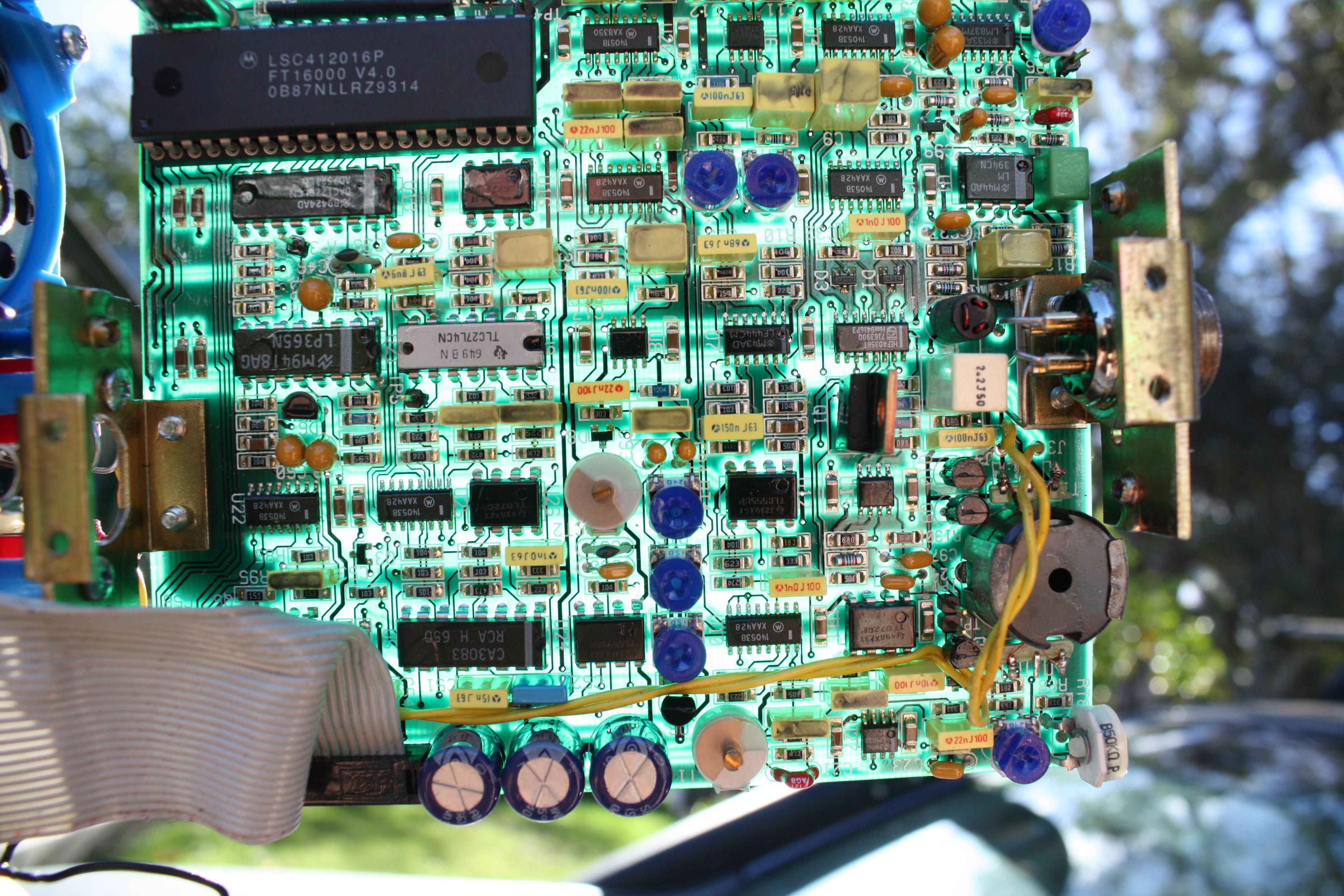

    will get some pic of the board when I get a chance so you all can see what I'm looking at
    couple quick snaps

      a 10nF cap should not be getting hot. It does sound like it has gone bad.

          not a problem kt315 will get better pics later on as need to get the light right as its been painted with some type of clear lacquer that makes the lot very glossy, got to get the light just right. have been taking a few macro shot of the chips that have been wiped with what ever to get rid of the id marks and with the right settings I can bring the numbers out enough to get id on them,
          thanks Waltr I was thinking that was the problem one been hot as, burns when touching it, first pic is of the tank circuit all in that corner going to draw it out on paper to try and make sense of it all, as there is a switch in the tank circuit for switching between 32khz to 6.5khz which still works when have it on the scope so narrowing it down slowly back to that one cap

              If a Cap is getting hot it shorted.
                Quite likely to be a faulty capacitor
                Could be high amps running through it.
                  It is a tank capacitor, so hundreds of mA are running through it.
