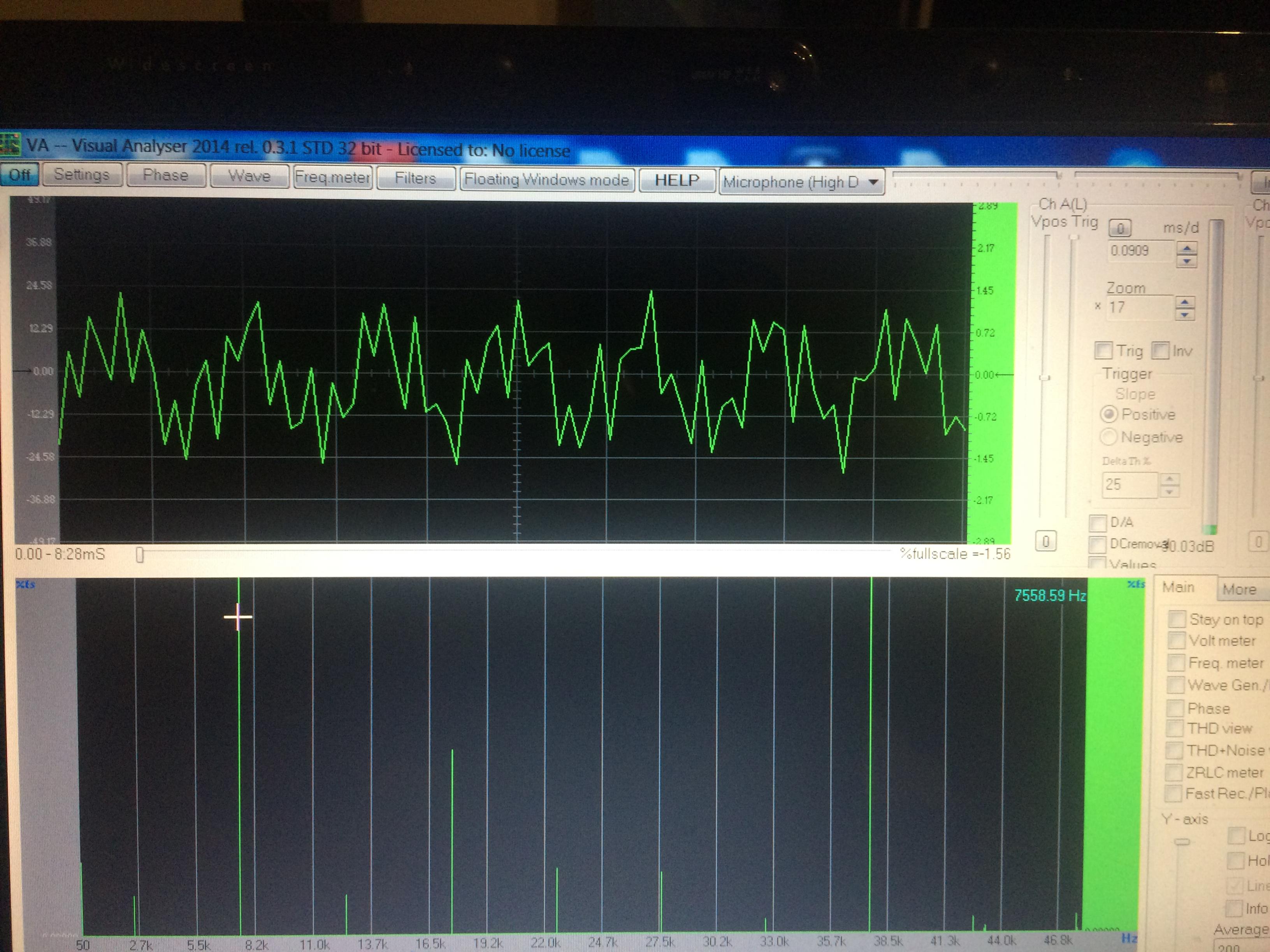

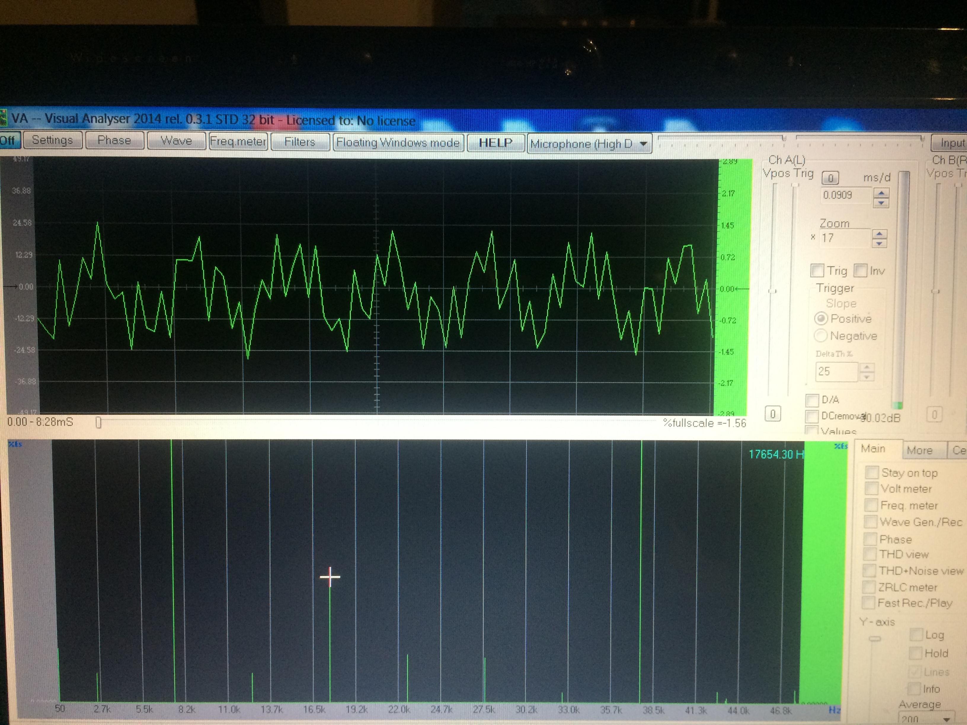

  • I'm using DxO Optics Pro 8 to modify photography, I'm going to analyze individual programs over the weekend - and I'm trying to do a screen scan.
      37740Hz is highest freq. What about the exact freq. of the other two?
      Guessing 18870Hz & 6290Hz.
      the frequency values are slightly different in a small range depending on the type of multi-frequency programs.Click image for larger version
Name:	Januar 3 Iphone5S 2019 005.jpg
ID:	352745Click image for larger version
Name:	Januar 3 Iphone5S 2019 006.jpg
      • Originally posted by EL NINO View Post
        the frequency values are slightly different in a small range depending on the type of multi-frequency programs.[ATTACH]44934[/ATTACH][ATTACH]44935[/ATTACH]
        This could easily be due to frequency resolution of the software sampling rate and FFT binning.
        Good stuff though.

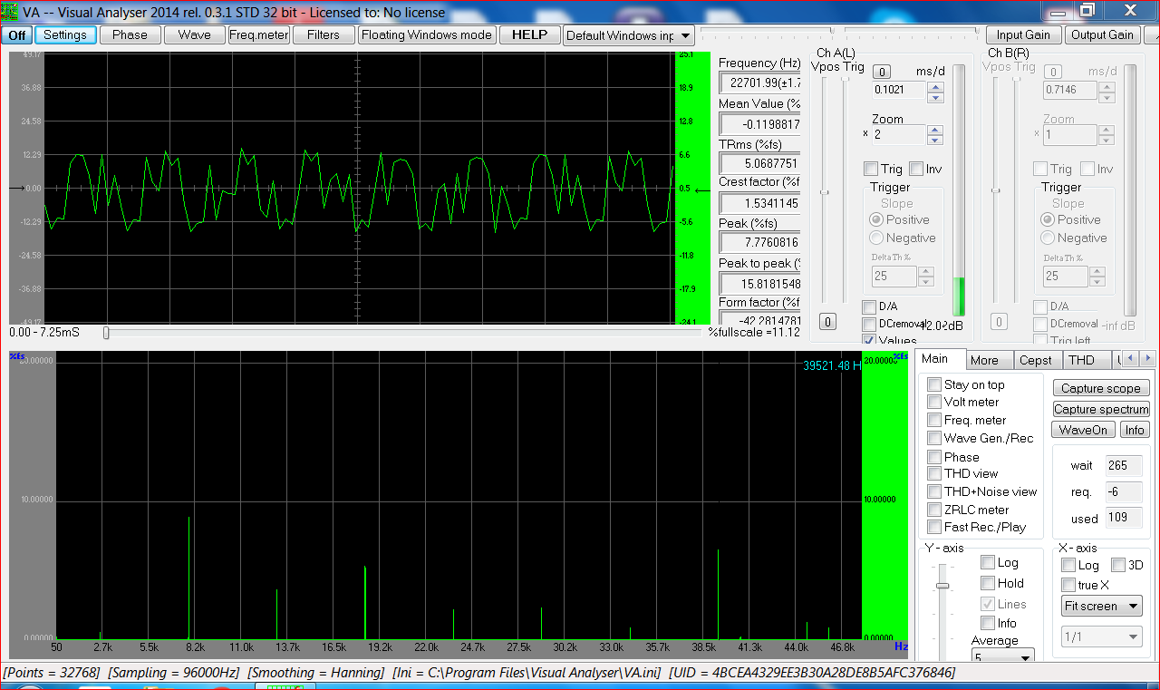

        • with the VA program will not be a problem to do a lot of stuff .., I do not think the FFT would have been inaccurate in this direction, but I try to compare it .. On Screenshots I used Lightshot program ..Click image for larger version

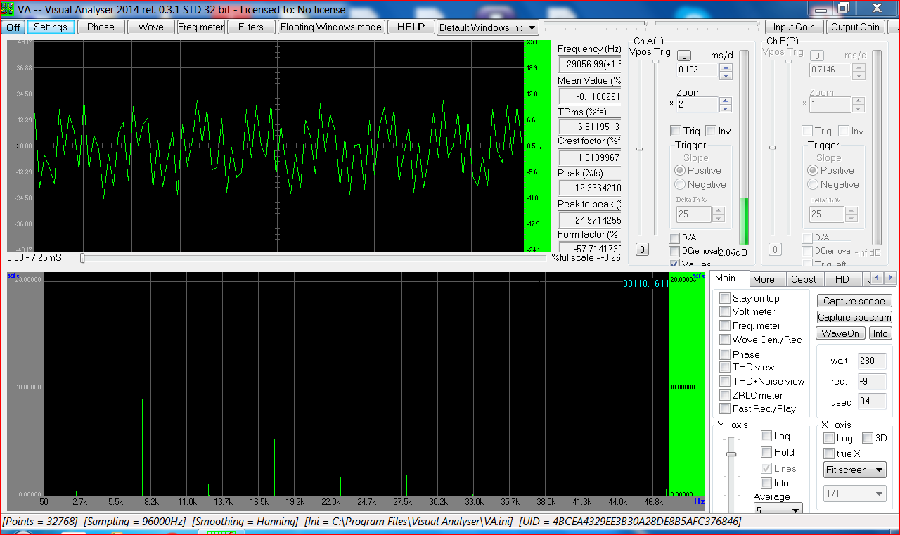

                  • Equinox Programs In Multi F :
                    Park1Click image for larger version
                    Park2 Click image for larger version
                    • Beach2 Click image for larger version
                      Beach 2 -in overload Click image for larger version
Name:	Beach 02-in overload.PNG
                      Gold 1 Click image for larger version
                      Gold 2 Click image for larger version

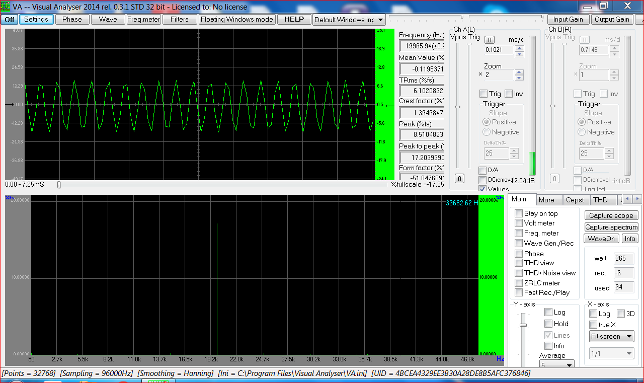

                      Gold 2 -20khzClick image for larger version
Name:	Gold 02 -20khz.PNG
                      Gold 2-40khz Click image for larger version
Name:	Gold 02 -40 khz.PNG

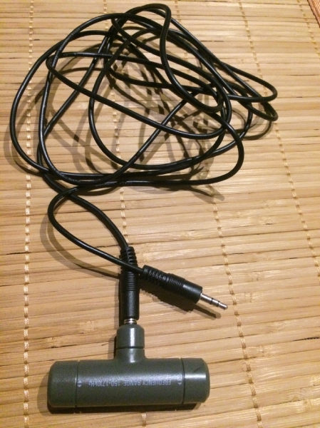

                        in these new Scan Tests I used the probe as the external ferrite AM antenna-from Tescun pl 365 - I think the measurement results are quite accurate ..,Click image for larger version

                        • El Nino, you're sample rate is too low to capture these signals at decent resolution.
                          • Do you have 192kHz sample rate as an option, Nino ?
                            Do you think it will make any real difference to the spectrum analysis ? At 96k sample/sec, he's (just) sampling more than two samples per cycle of the highest freq of interest, 40kHz.

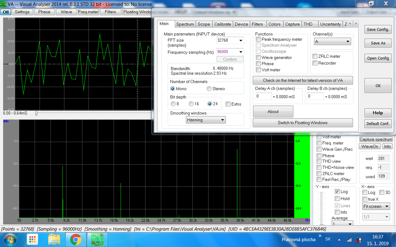

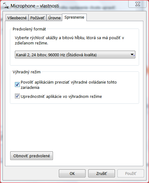

                              Hi ... Carl ... thank you for warning .. something is not quite ok, .... .... my laptop's sound card - it allows sampling up to 96 000 Hz / 24 bit, and in the VA program alone -mam set-up up to 96000 Hz / 32500 FFT-24bit ..so I'll have to buy better an external sound card...or new laptop..
Name:	Equinox- Va -setings.PNG
ID:	352789 Click image for larger version
                              • Originally posted by Skippy View Post

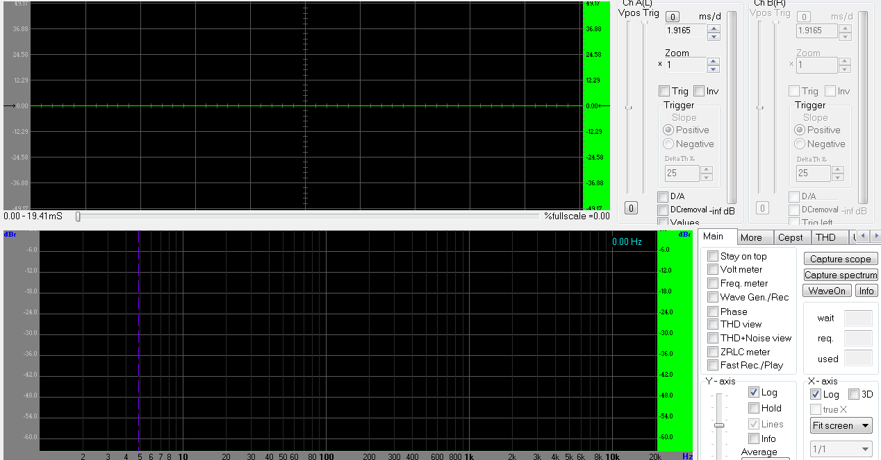

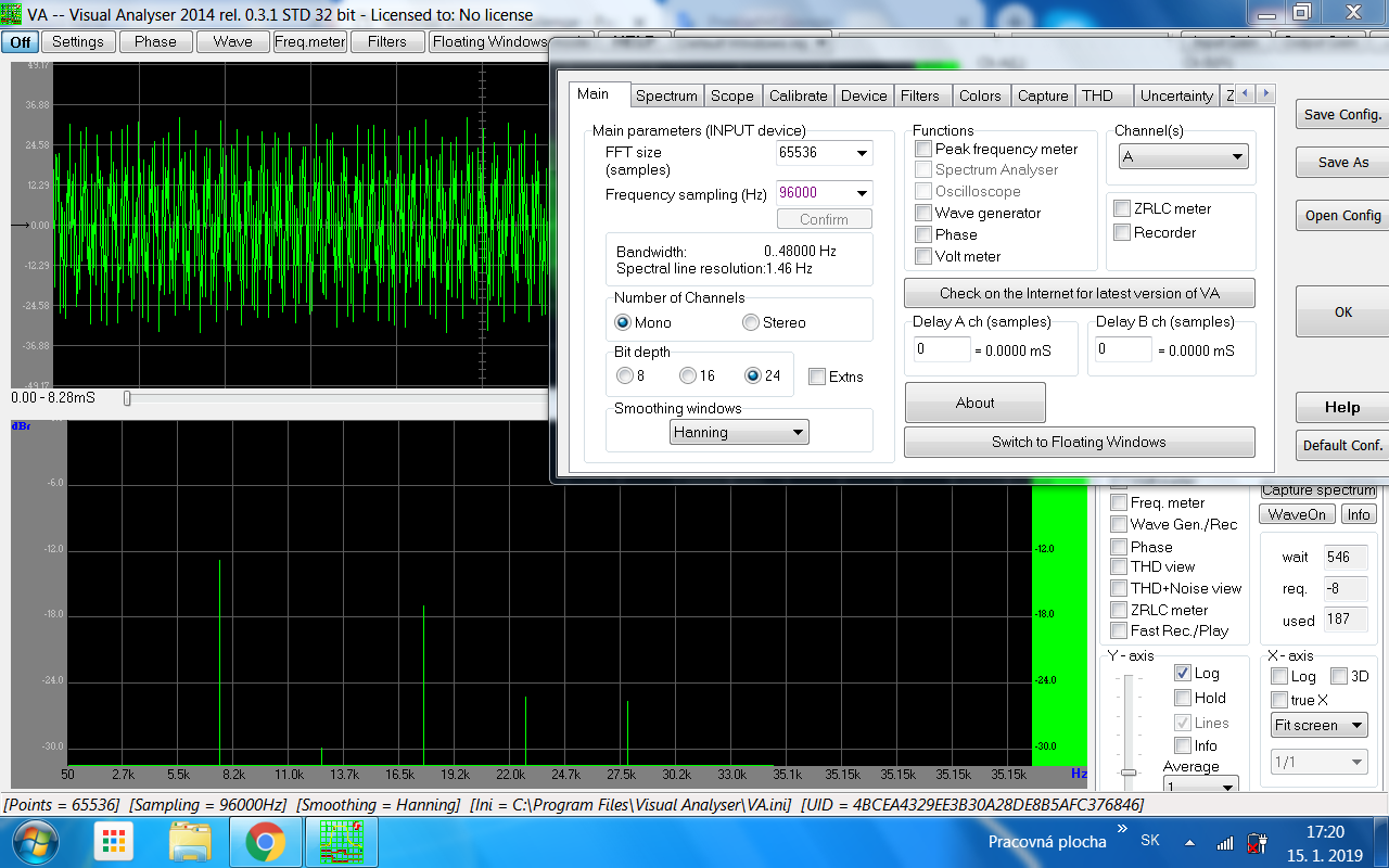

                                Hi Skippy... I think the setup can be 96kHz / 24bit limit, because in VA program my good working maximum setting is: 96000 Hz / 32500FFT-mono-24bit ... if i change to 96000 / 65000FFT ... I'm losing the signal from the highest 39kHz frequency..Click image for larger version
Name:	NO optimal settings VA- for Equinox.PNG
