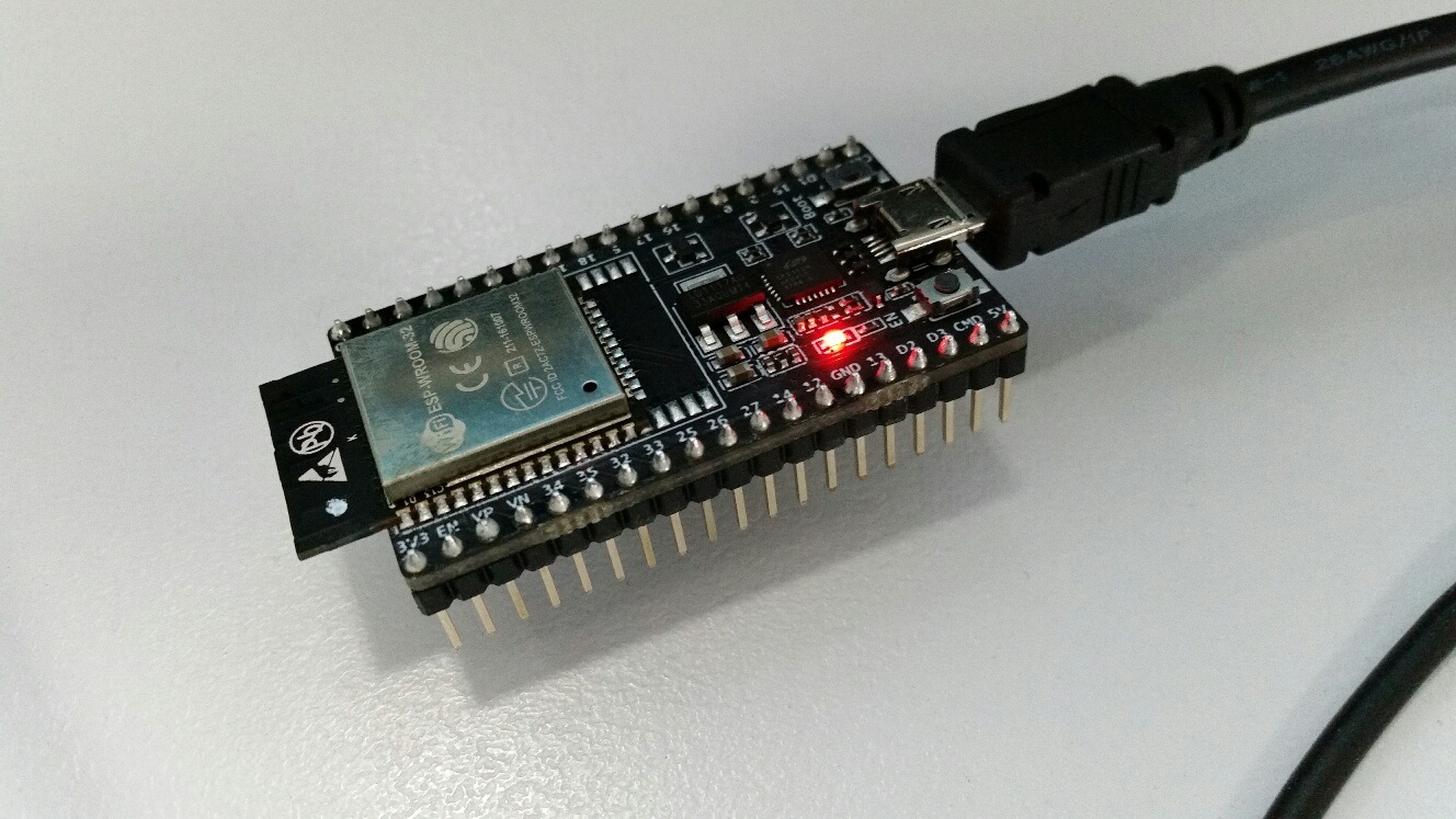

            • Well I ordered a few esp32 modules to play with and have the toolchain loaded and its talking through the serial port .... so far so good .....

              • Hello World .... program compiles and loads ... so fingers crossed its working

                • hello world sample program loaded and running ....
                  Observations so far ....
                  1. The ESP32 development tools setup is not for noobs.
                  2. The easiest setup is using a virtual machine running on Vmware or Virtualbox.
                  3. Theres bugs ....
                  hello world runtime output below ...

                  • The ESP32 has an internal Hall Effect sensor ... you can read it on ADC1 with a call to
                    adc1_config_width(ADC_WIDTH_12Bit);
                    int val = hall_sensor_read();
                    It definitely picks up fridge magnets LOL.

                    • I have moved to the esp32 also the adc's are a bit average I am building a adc test module based on the http://www.ti.com/product/ads127l01 adc.
                      What ide are you using?
                      • Using the toolkit from the espressif site and good old vi editor running on centos virtual machine in virtualbox on win 10. That adc looks ok ... I was going to try out the ads12621 from ti.
                        • A suitable windows development IDE for ESP32 is called PlatformIO its an extension module that is loaded into Microsoft VisualCode.
                          This uses Arduino framework.
                          Both are free and theres lots of examples. eg simple web server in ESP32 flips bits to drive LEDS
