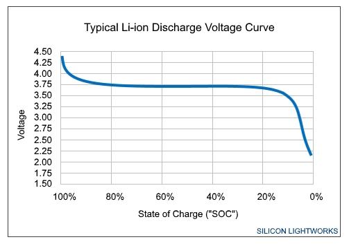

                            I have new 18650's and 4-cell battery holder, ready to install, some were saying that 4x 18650's (14.8v) is safe for this machine, now you're saying it will smoke the Sniffer? I don't want to come even close to cooking this machine. I will do 4 18650's charged at 3volts each then, this will be safe, correct? These are 2000maH batteries, Westinghouse brand
                            • #44
                              An 18650 at 3 volts is considered flat, a good quality fully charged battery straight out of the charger should be around 4.2 volts
                              to preserve the long life of the battery and maintain maximum capacity you should stop discharging around 3.5 volts
Name:	Li-ion Discharge Voltage Curve Typical.jpg
