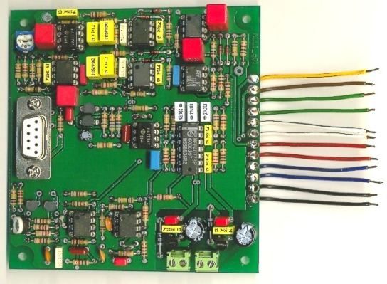

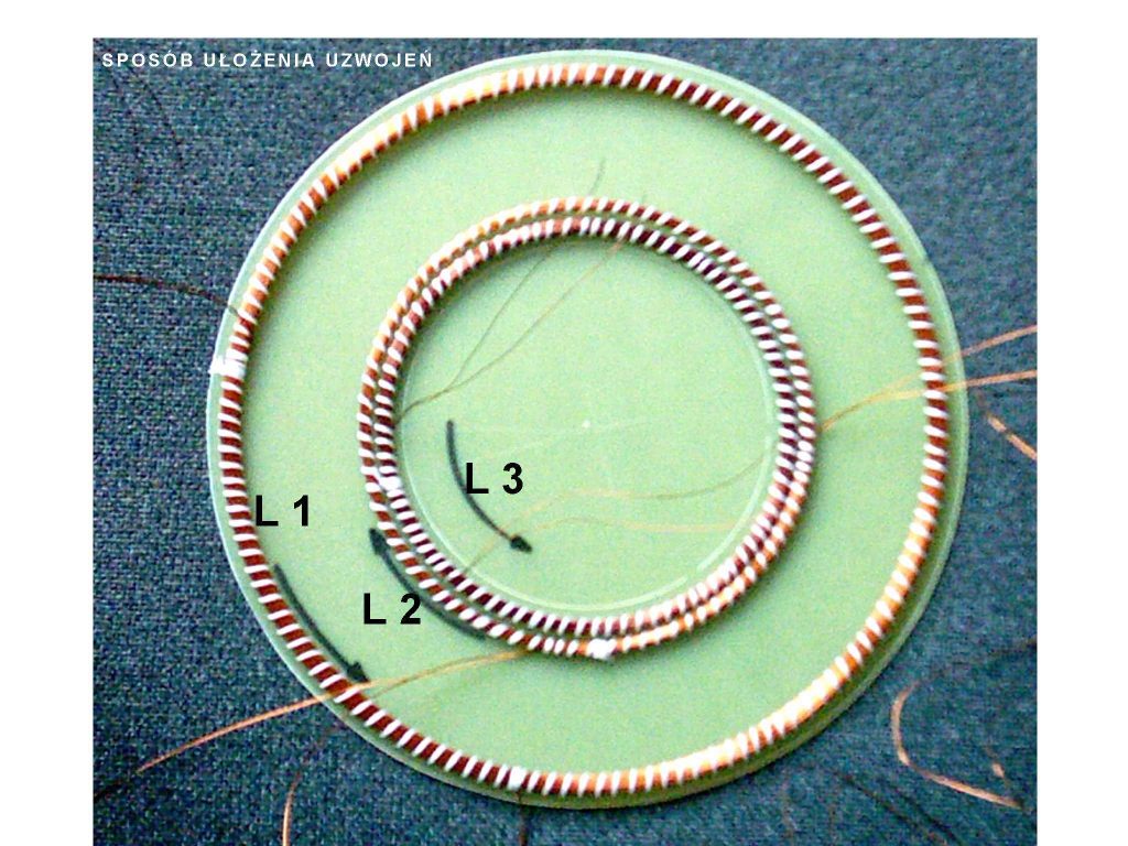

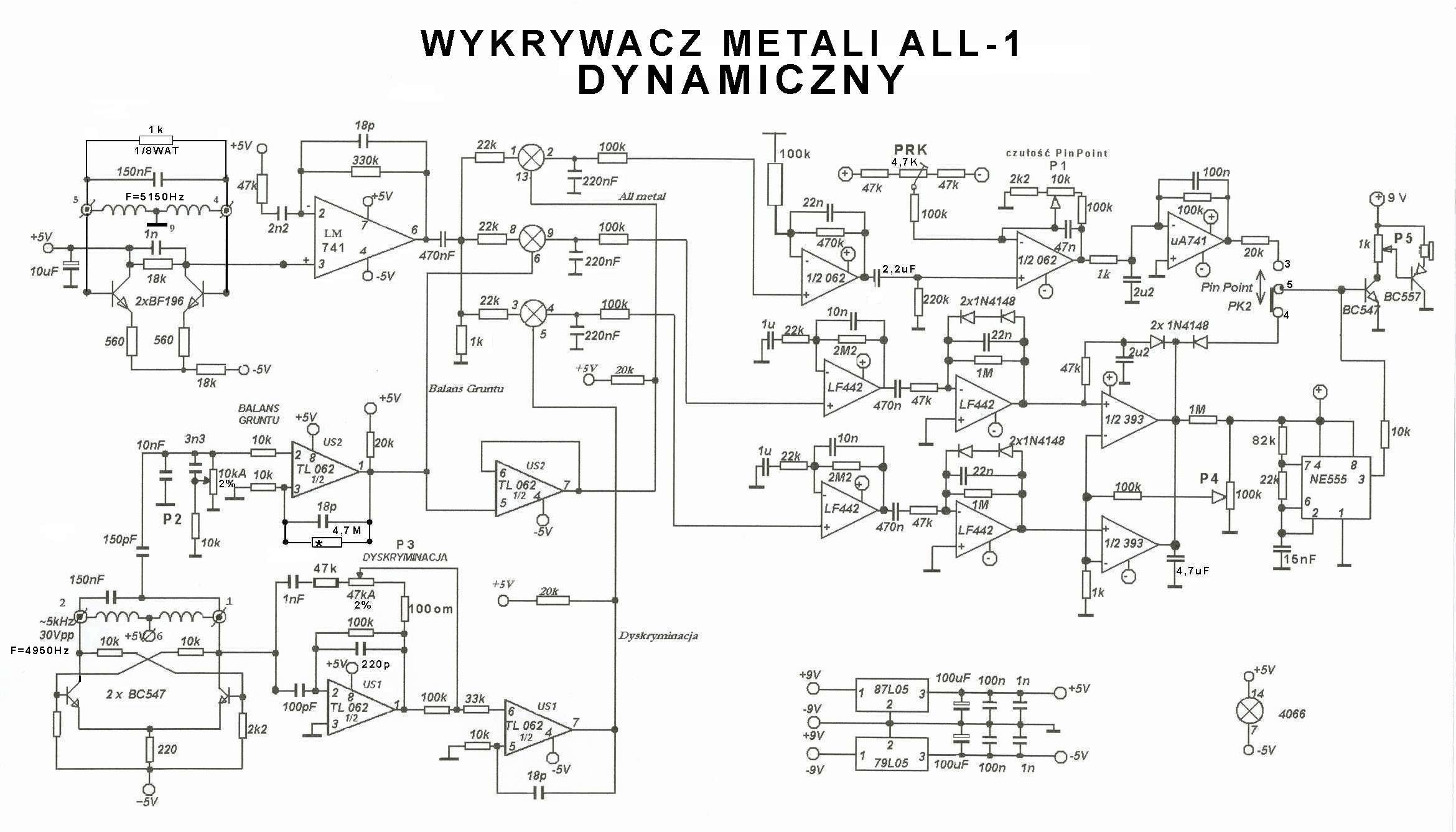

      • to information
        poliaki copied fisher 555 (or 553 -?) and recall it ALL-1. ALL-1 uses this tipo of coil. open folder in Fisher_Gemini -> 555> All-1 and look
        files. i mean archive DVD.
        • poland polish ALL-1 detector and their coil
            to information
            The poliaki circuit uses a centre-tapped coil, but it's not a Hartley oscillator. The TX oscillator is an astable multivibrator. The intention is most likely to provide a more powerful signal.

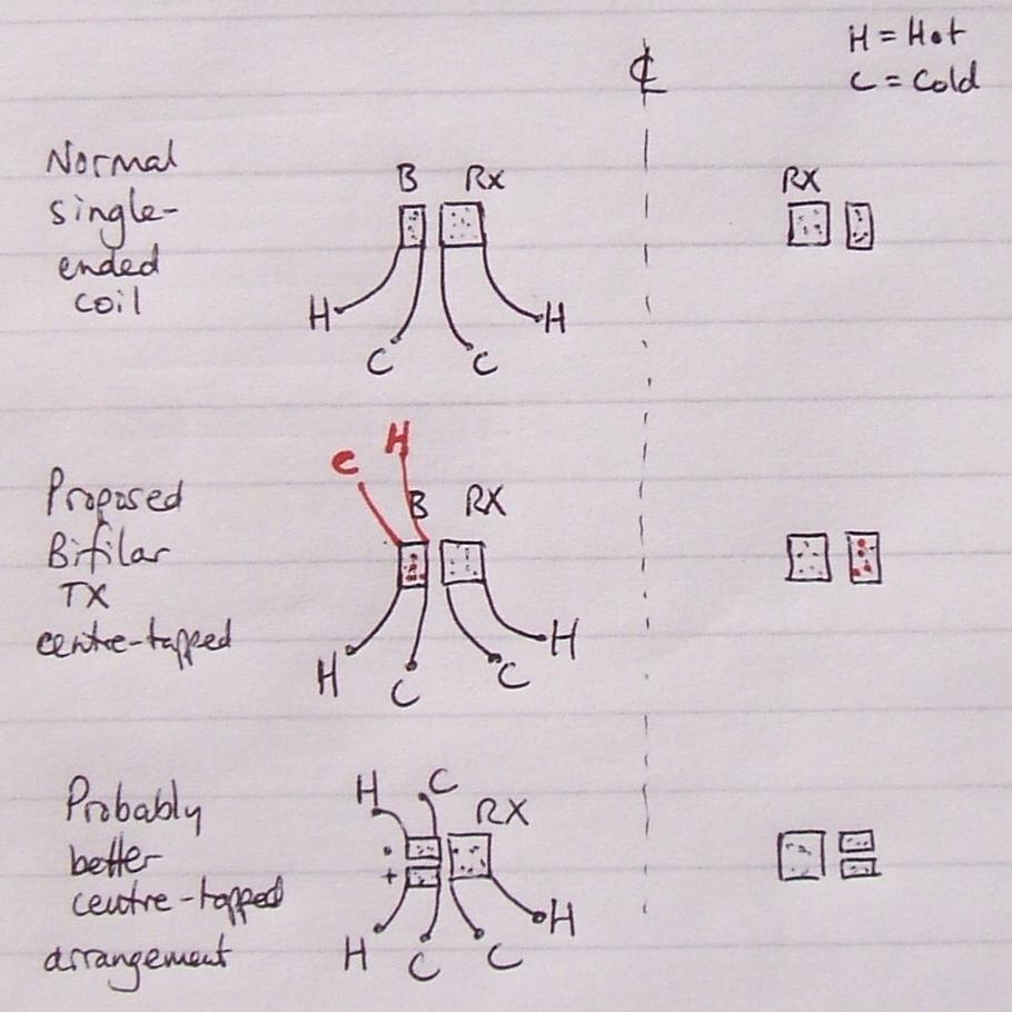

            • Here's what I'm trying to describe:
              (see attached pic)
              With a single-ended bucking coil, wound outside the RX coil, you see that the outer-most windings of the RX are grounded, and the inner-most bucking coil windings are grounded ( or some fixed DC voltage). This results in minimal capacitive coupling between the two - only magnetic coupling.
              If you wound the bucking coil bifilar, you wouldn't be able to achieve this. There would be a 'hot' winding next to the RX.
              But if you wound the bucking coil as TWO SEPERATE coils, side-by-side, with one wound the opposite direction to the other, it is possible to join them up so they are centre-tapped, with BOTH cold ends of the bucking coils being next to the RX outer cold windings.
              This is probably not too hard to make in mass-production, with machine-wound coils and self-bonding wire, but a bit of bother for home-built gear.
              ( What Melbeta said about the bucking coil being wired up opposite to the main TX is correct ..... but it wasn't what I was referring to. Hopefully the diagram explains it..)

                • I'm not trying to describe the 2b coil, I've no idea how he's made them, I've never seen one, I can't make out much from the blurry photo posted earlier.
                  I'm trying to explain how I think a suitable coil COULD be made.
                  In the second diagram, the two 'C' wires would be joined to form the centre-tap.
                  And in the last diagram, you would also join the two 'C' wires together, to form the centre-tap. So a 'theoretical DC current' would flow from:
                  'Ha' to 'Ca' to 'Cb' to 'Hb'
