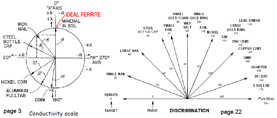

Most stock Tesoro detectors will not separate a copper penny and dime even when using a 10 turn pot for discrimination.
Higher frequencies tend to expand the low conductivity part of the scale but compress the copper/silver high conductors closer together. The 6.592kHz White's could pretty easily separate copper cents & dimes, the Tesoros tend to run 10/12kHz and may have more trouble.

Copper cent and dime are very close, separated by only 10 degrees phase shift.
always wondered how these figures hold up in different ground conditions
For example a button top on wet sand moves from being discriminated out from 5 on the dial in air tests to 3 on the beach. Is everything else moved exactly 2 position down on the dial
