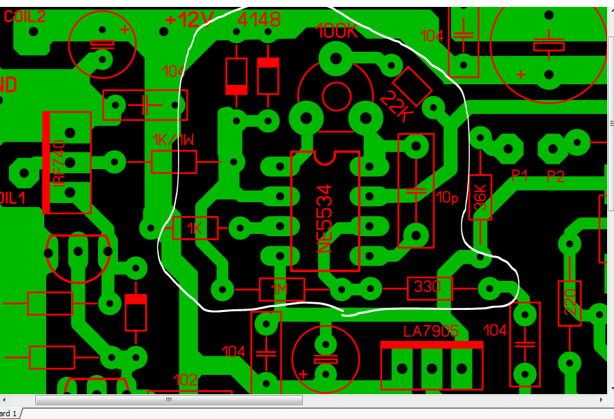

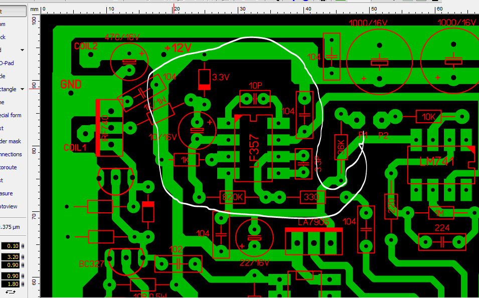

              LF357 is no direct pin to pin replacement which is good as 357 other than LF356 but no good as 357, what I do is I used NE5534 with a little modification which give best result to 357 or better.

                Very interesting ne5534 has no where near the performance characteristics of lf357 slew rate and noise are far worse how did you modify them?

                  I've done this to some Pi Md's but not in all pi..

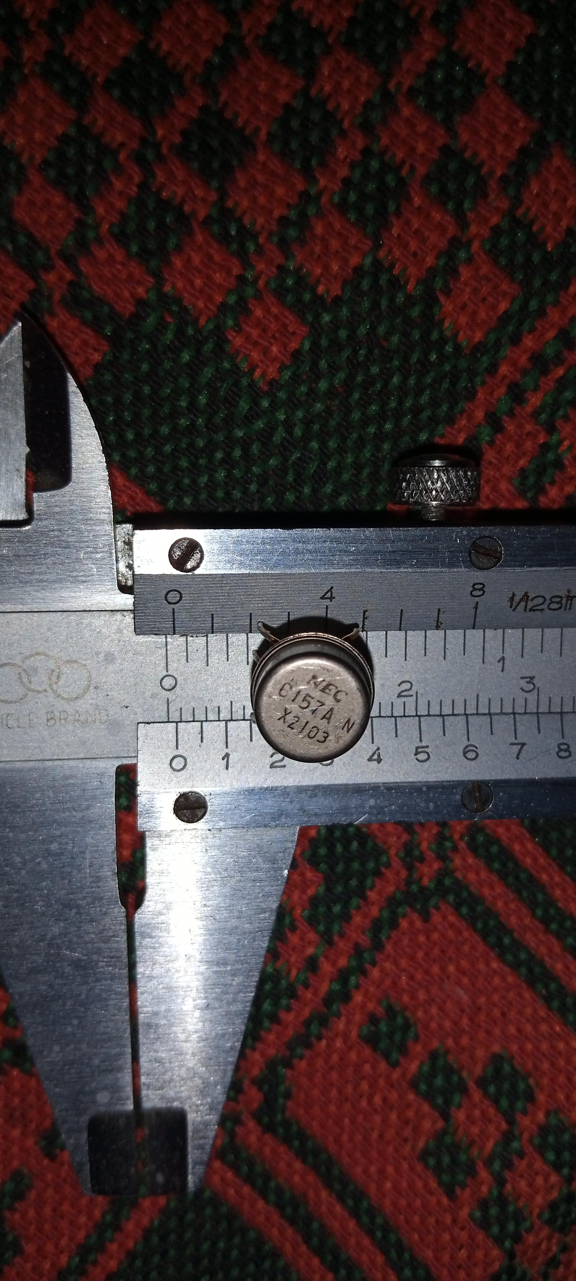

                    Is this a substitute for LF357.
                    Someone post datasheet of this part whatever it is.Click image for larger version

                      https://datasheetspdf.com/pdf/616245/ETC/UPC157/1
                      • #56
                        I have visited the link but does not make sense to me as it is not in English.
                        Can you confirm that it is a good substitute of LF357?
                        • #57
                          Try it
                          • #58
                            It is working. Will experiment more to see how good this performs.

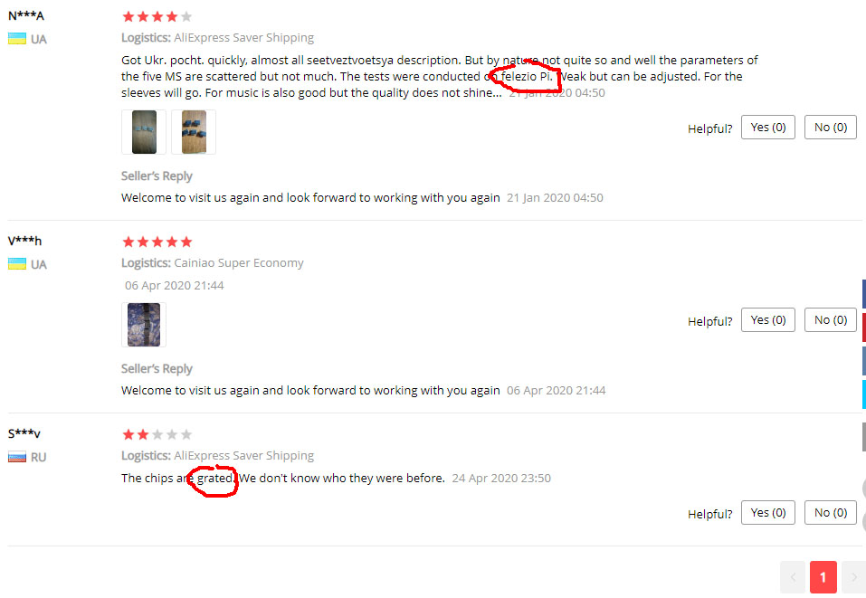

                              i am looking aliexpress... situation is crisis. if before covid i could read customers reviews and do a choice so
                              after covid, now, all listings had refreshed, zeroed, there are just 1...2...3 reviews in some.
                              • #60
                                just an example. what we see here in reviews... guy in UA tested in felezio. i see his resume in original, in russian.
                                poor result. second guy wrote the chip is remarked.
