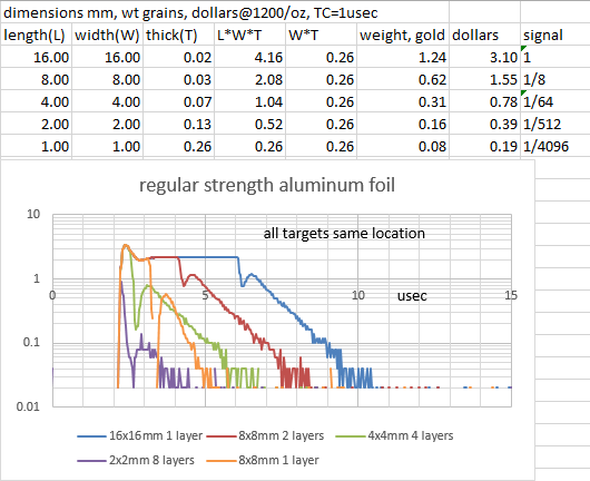

    I read reducing the target size by a half reduces the sensitivity to one eight. Did a test this morning, appears to be true if I double the thickness to keep the TC the same. The 8x8mm 1 layer projects a higher amplitude than the 8x8mm 2 layer at 3usec. Test is with a PI, would a VLF show different? What am I missing or doing wrong?

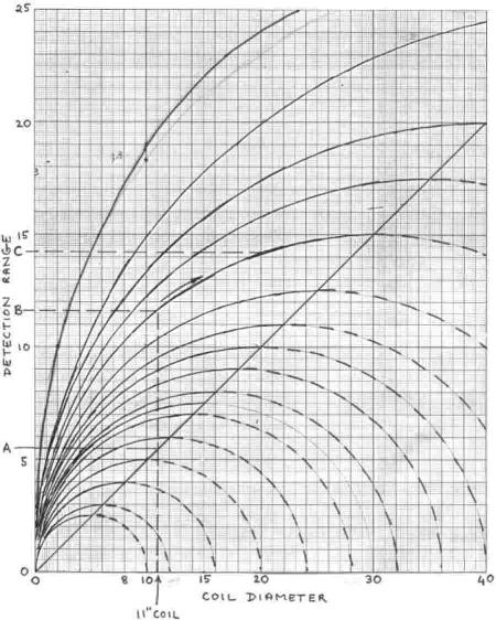

    Here are the curves I have used for many years. The range reaches a maximum when it is equal to the radius of the coil. Coils larger or smaller than this optimum will result in less range. To show how this works, along the bottom axis you see coil diameter, which is obviously 2 x the radius. So for an 11in coil, if we go up the vertical scale to A, we have 5.5in. Also note the diagonal line and the series of ever increasing semicircles. Everything to the left of this line shows increasing detection range up to the maximum where it intersects the line, then decreasing range to the right, where the semicircles are shown dashed.
    If a certain metal object is just detected at 5.5in with the 11in coil, then going larger in coil size will cause a reduction (going down the dashed side), and going smaller in coil size will have a similar effect. Initially, it won’t be much, i.e. going from an 11in to an 8in coil will only make 0.5in difference but below 4in diameter, the range will drop rapidly.
    Now, suppose with the 11in coil, you can detect an object at about 12.5in (B on the vertical scale. This indicates that the coil is not an optimum size for that particular object. If we carry on up the curve (direction of arrow) we can see that by using a 20in coil, we could gain another 2.5in (C). The curve peaks at 15in with a 30in coil. But the extra inch gained hardly makes such an unwieldy coil worth while.
    Other factors come into play of course. The curves assume that the number of turns and the coil current is the same in all cases; which it isn’t necessarily. For the same inductance value, a smaller coil has more turns, which counteracts to some degree the loss in range. Also a smaller coil will pick up less electromagnetic noise, earth’s field noise and ground effect, which make for a smoother threshold.
    The end result is, that with a small nugget that can be detected at between 5 and 7in with the 11in coil, so that it is on the top part of the curve, an 8in coil may well give a similar range. That is not to say that smaller coils do not have other advantages. Small coils and probes are very useful in rocky areas or searching in undergrowth. They have less drag too for water hunting, and less pickup from mineralised soil or conductive sea water plus better signal separation on close or multiple objects.
    One other point regarding PI, is that the small object sensitivity is largely determined by the sample pulse delay. If an object is so small, or thin, or made of high grade stainless steel, such that all the signal has decayed before sampling takes place, it would not matter how small a coil you made, it would never be picked up.
    Eric.

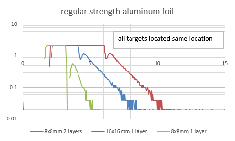

        Not sure what you are asking... are you wondering why the 8x8x1 has a stronger response than the 8x8x2? Also, your 16x16 target dimension is 2x, but the area is 4x. Not sure if this is intended.
          One of the reasons for trying to understand the physics. I have a gold nugget, 4 grains(TC=3.1usec). I read about detecting lot smaller nuggets. Wondering how small is detectable and what the nugget TC might be. Thought I would make a target with 1usec TC. Some data, think it is correct. Signal for 2x2mm 8 layer target less than needed but looks like it might parallel the other targets. Assuming 1x1mm 16 layer would parallel with 1/8 the signal of 2x2mm 8 layer target. Maybe 1usec TC is to low? Loose 90% of signal if delay is increased by 2.3usec for 1usec TC target.
            Trying to understand(Coil Sensitivity) page 247 ITMD. Where as sensitivity is approximately equal to the cube of target diameter. Statement doesn't mention thickness. Just trying to understand what and how much effects target strength. Maybe I'm looking at it wrong, wouldn't be the first time.
            When I reduced the width in half and doubled the thickness to keep the TC the same the signal reduced to 1/8(cubed). The smaller single layer target has a larger signal if sampled fast enough, not reduced signal.

                I don't have an exact answer, but I expect "sensitivity is approximately equal to the cube of the target diameter" is valid for higher conductive coins where skin effect is not a major factor. For low conductors, skin effect does play a bigger role and has to be accounted for.
                The reason you see a stronger signal with the small single layer target might be due to the exact configuration of your circuit. The step response of an eddy target is generally t*e^(-t/tau) which shows a characteristic peak followed by the exponential decay. Sampling exactly on the peak gives highest sensitivity, but only for that tau. Many PI designs are more sensitive to low conductors than high conductors; they almost always detect nickels deeper than quarters, even though quarters are bigger. The preamp design also plays a role, especially the bandwidth which alters the step response. Play around with bandwidth, sample delay, and sample width and you'll see this effect.

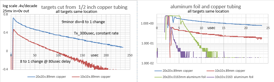

                      Thanks for the reply. Is there a best VLF Tx frequency for a 1usec TC target? Cut some targets from aluminum foil and copper tubing and charted data. Thicker targets are closer to diameter cubed during normal PI sample times. Would the change in TC effect the cubed change with diameter with a VLF?
                        Quote:"Is there a best VLF Tx frequency for a 1usec TC target?"
                        A 1 microsec TC target would be equivalent to a 159kHz corner frequency. So in principle, a detector operating in this sort of range should be best. However, I assume a 1 usec target is the smallest target you're realistically trying to find, you would rather hope to find ones with 5 or 10 usec TC ? So a typical VLF 'gold' machine operating at 35 - 70 kHz would probably be a realistic choice.

                          The 16x16mmx1 layer target(TC=1usec)is chartable, so easy to detect. The 2x2mmx8layer target(TC=1usec)almost chartable, maybe detectable with 200mm coil. Don't know if I could detect the 1x1mmx16 layer, .26mm thick(TC=1usec)with a 200mm coil, wondered if anyone could detect it. Need to finish the detector to try. A piece cut from an aluminum can side 5x5mmx1 layer has a 1.1usec TC, should have a Rx signal more than 125 times the 1x1x.26mm aluminum target.
