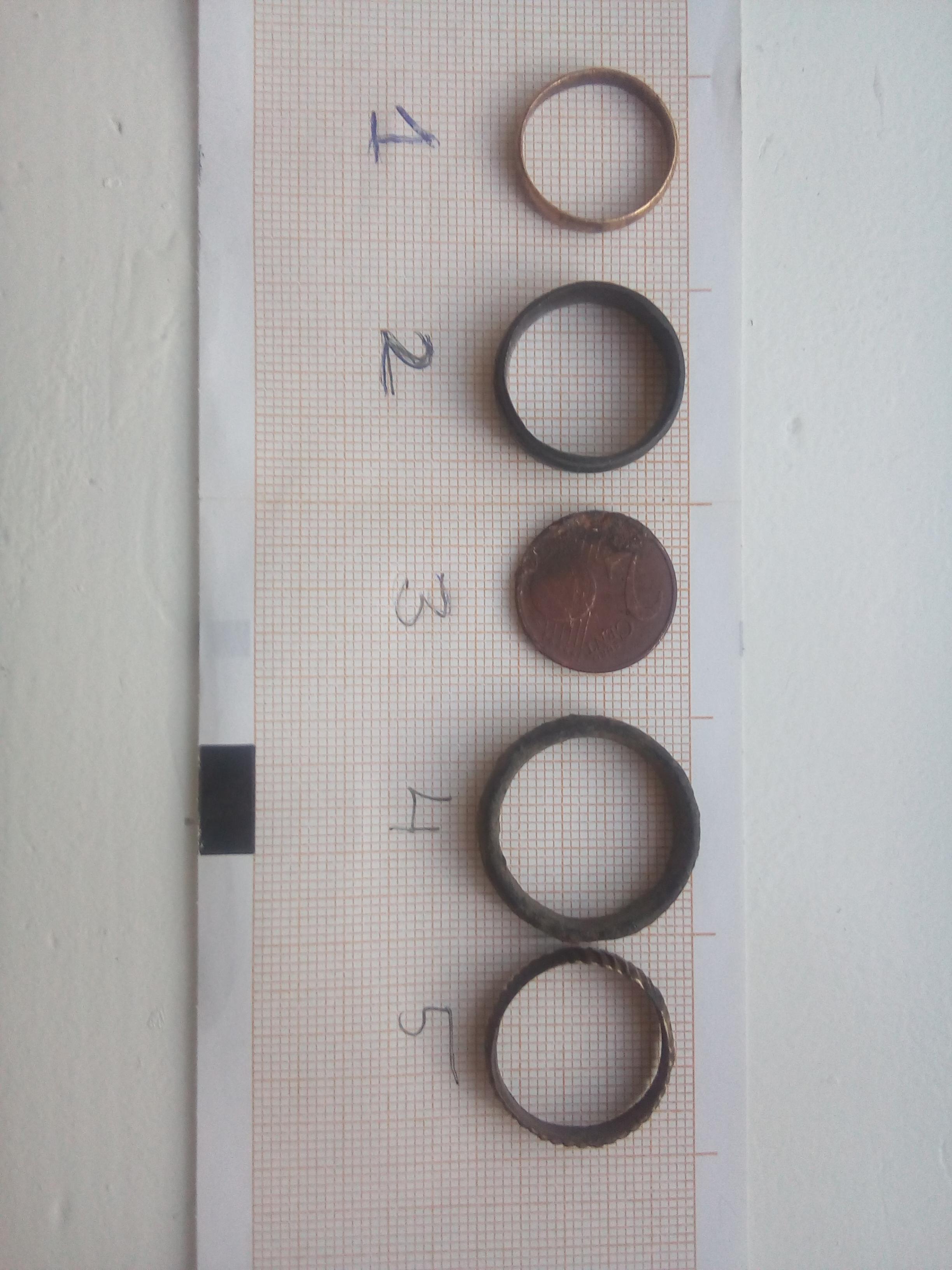

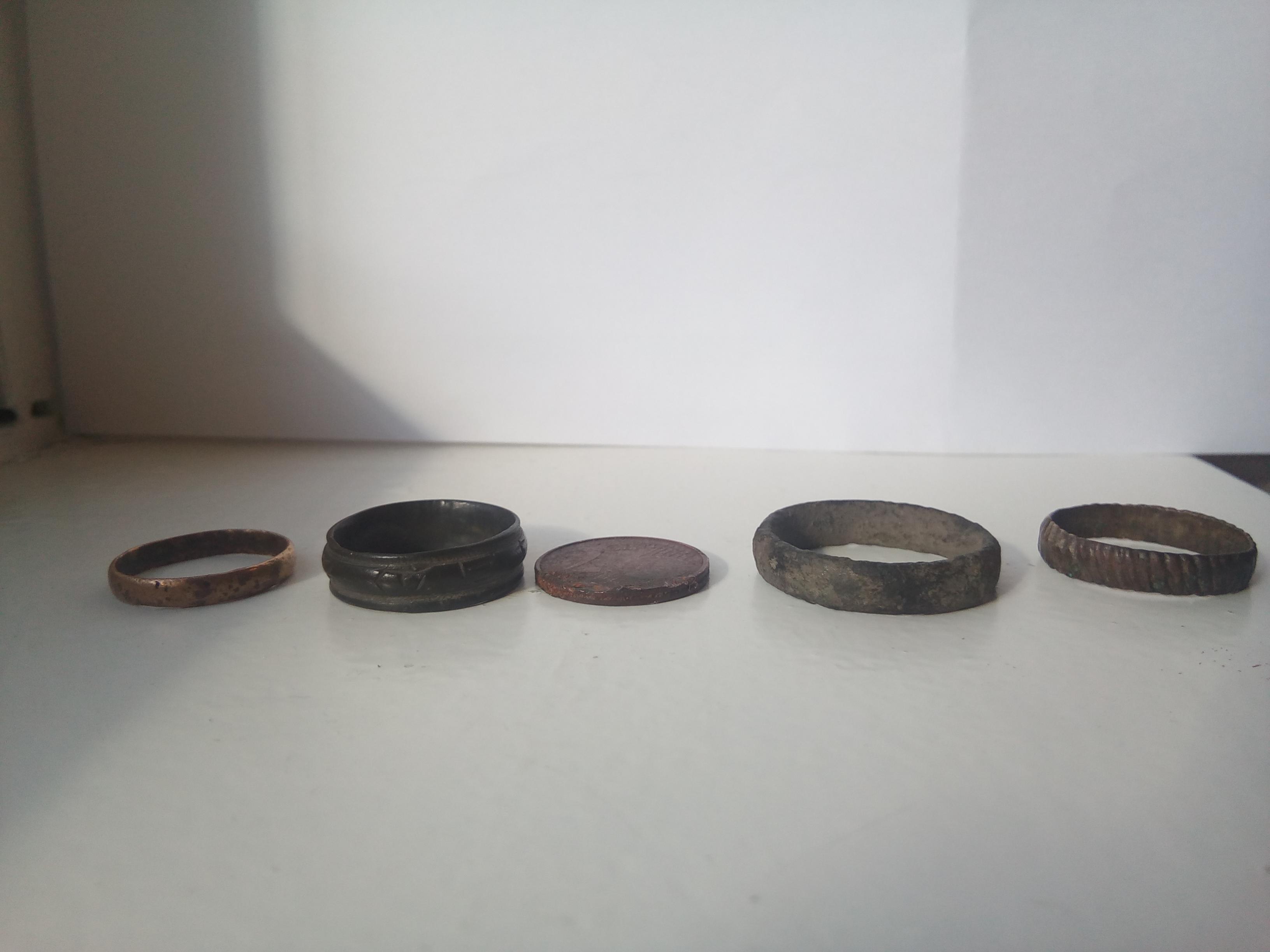

              Will add results in graph. Asked my friend K. Märtens. Unfortunately in Estonian. Horizontal unit 10 micro sec, vertical signal strength. 1. item -gold gilded baby copper ring 1,6 gram, 2. Bronze with nice patina 2 gram, 3. 2 euro cents for comparison, 4. Bronze with nasty Cu2O 4 gram, 5. Roughed copper ring 2,4 gram. Will post graph and pictures. When I made measurement with Vallon I also understood my mistake in interpretation. I measured those two rings at normal mode when changed to mineral the results are very similar with the graph. As I have understood Vallon is designed to find pcb tracs related to IEDś which are copper coated with.... It is probably because otf that internal firmware tuning that there is this enermous difference in normal mode.Click image for larger version

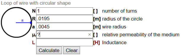

                        What do I enter for relative permeability?
                        • #57
                          Relative perm = 1.00 for air or a vacuum

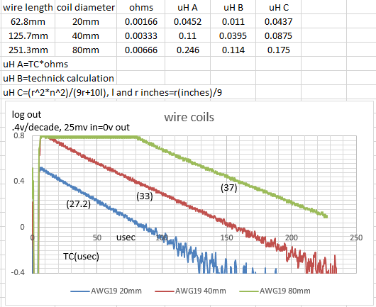

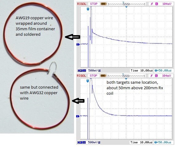

                              Wondered how close to calculated inductance some wire loops would be to L=TC*R and how much the soldered joint would effect loop resistance. Tried technick calculation and one I've used in the past, LuH=r(inches)/9 for a single loop. Nothing close, wondering what I am doing wrong. Cut some AWG19 wire to length, wrapped in a circle and soldered. Recorded decay.
                              targets same location, centered on one of the 200mm fig8 coils.

                                Gotta admit, I don't like the idea of soldering a loop of high-conductivity copper up with a random blob of low-conductivity lead alloy. Maybe it was not leaded solder, but lead-free? Was it a neat butt joint, with flat faces, or did you just chop the wire with cutters and leave that distinctive chopped taper etc? Did you file the solder down afterwards, or leave a spherical ball on the join ? Etc Etc?
                                Anyway: Case C , with the 10a + 9b bit in the formula is no use for single turns, ... it's for solenoids, I think?
                                You've obviously got L calculation problems, you're miles out, but your R value looks good.
                                Here's my maths for the 40mm coil:
                                Loop resistance = 3.25 mOhms ( using 1.68 x 10-8 for resistivity )
                                Loop inductance = 97 nH = 0.097 microhenry
                                So Time-constant = L/R = 29.9 microsecs. Which fits nicely with the measured value of 33 usec.
                                The effect of the solder join could be investigated by making rings with 1, 2, 3, 4, 5 joints, and seeing how TC varies ( increases) ... the trouble is making a perfect cut without removing much metal.
