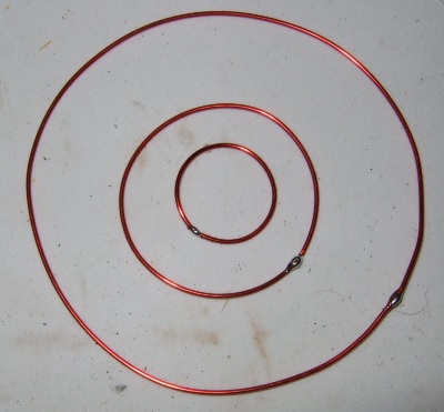

    Used kester 60/40 solder. neat butt joint, with flat faces, spherical ball on the joint. AWG19 magnet wire.

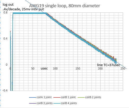

      Made another 80mm diameter coil(coil B). Recorded coil A and coil B, 1 join. Cut coil B and joined with 2, 3 and 4 joins. Recorded after each join. My cutter cuts a flat on one side of cut, then cut other side flat. Loose about 1mm cutting other side flat for each of the 2, 3 and 4 joins. Don't see much change in TC.

        Your coils look OK, I guess the resistive loss caused by the solder that's between the ends of the copper is offset by the extra solder around the outer of the wire? I guess for large loops like 40mm+ the contribution to R from the solder is small.
        Example: if solder has conductivity of 10% IACS, then 0.1mm of solder in the joint is like 1mm of copper, which out of, say 120mm ( Pi x 40) is only a small error.

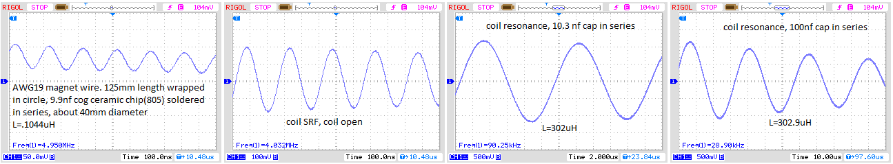

                      Tried soldering a 10nf capacitor(measured 9.9nf)in series with 125mm AWG19 magnet wire and measured resonance with my tester. Calculates .1044uH, Technick calculates .0974uH, L=TC*R=1.1uH. Cut the wire 125mm with the added capacitor instead of 125.7(approximate) when measuring TC, not sure what length I should have cut.

                        Here's the maths for damped LC circuits, lots of it is hideous, but the 'change in resonant frequency' formula is simple. If damping is reasonably light, the change in freq ( to a lower freq) is very small. Your 40mm diam loop calculates out at Q = 1000, ( XL = 3 Ohms, R = 3 mOhm ), so no change in freq there.
                        https://en.wikipedia.org/wiki/RLC_circuit
                        One potential problem is your C value. a 10n in an 0805 package is going to be pretty temperature-sensitive, a few % drift is easy, plus there's the unknown factor of the effect of heating the little blighter to solder it in. And what's the series inductance of the cap? Obviously pretty low, but if it's just 5 nanoHenry, then add that to 97nH, you see how errors of a few % creep in.

                          Thanks for the formula. I looked at wiki/RLC but wasn't sure that was what I needed.
                          a 10n in an 0805 package is going to be pretty temperature-sensitive, a few % drift is easy, surprised me, I've used cog caps before and they were stable.

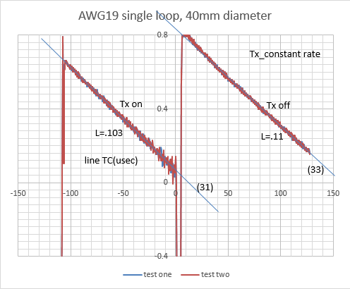

                          Another scope picture of the 40mm loop, Tx on and off. The slope with Tx on is steeper than when Tx off. Calculates L (L=TC*R)closer to L from resonance and Technick. Slope with Tx on is usually a little steeper(usually straight line decay from start) than when Tx is off(after straight line decay linear-log, could be steeper at start of decay). Any idea why that would be? Your TC measurements with a VLF are usually lower than my TC with Tx off so that would make them closer.

                            I don't know about the turn on /off difference, that's a PI thing, I know little.
