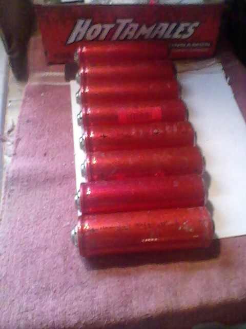

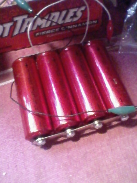

              Not to rob the thread but these could work . Been messing around with some 38120 LiFePO4 Cells. These things can produce some crazy Amperage. 4S have Zero Issues starting a car. They weigh less then half that of a SLA battery. Click image for larger version
ID:	352447 Click image for larger version
Name:	HeadWay 38120.jpg
ID:	352448 http://www.litrade.de/pub/HeadWay%20...fications1.pdf

                    another way we run to LIPO matter and i had know people LIKE this one to disput here but that absolutely does have not relation to your subject.
