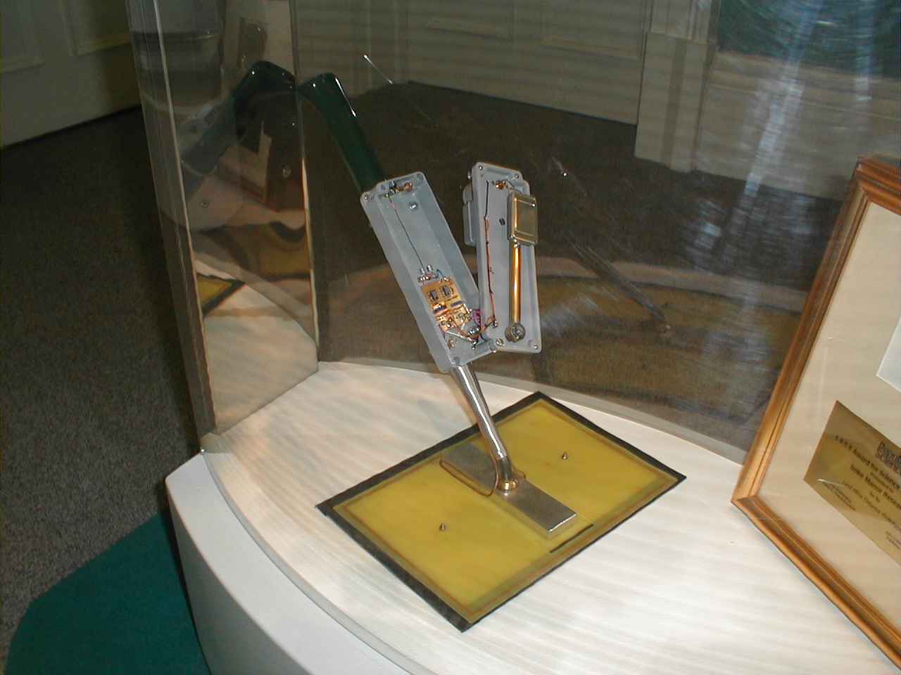

                    Google 'mine detector with kinetic generator' and you will find such a beast in the January 1999 edition of Popular Science.
                    Eric.
                      Any volunteers for field testing?
                        how about a windup one wee don't get much sun lol, how about charging a super cap?
                          Eric.
                          I saw that particular detector at Roke Manor where Chris Richardson worked. They had it in the lobby in a glass case, so I pulled out my camera and took some pictures. They promptly confiscated my camera as photos at Roke were strictly forbidden. I got it back though, with photos intact.
