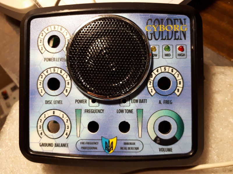

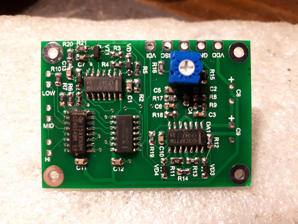

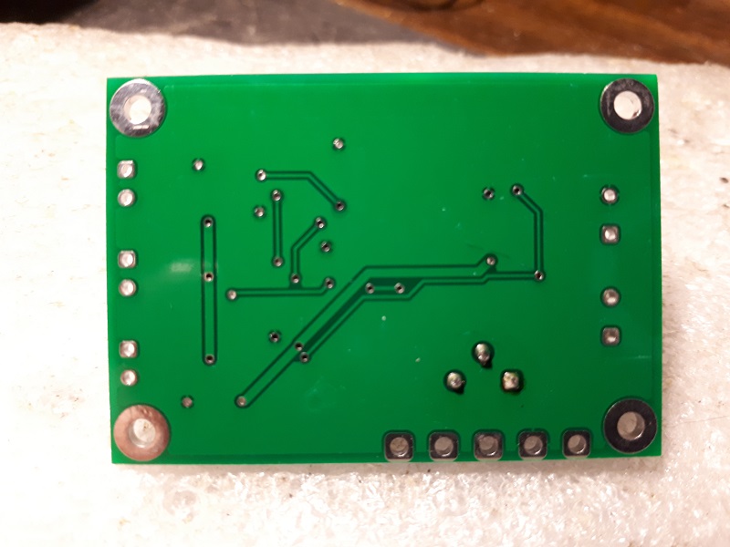

                    Good evening! I assembled the VDI 3 LED prefix, connected the Golden Mask-4 to the metal detector, (even if the ALL and DISK channels are not connected to the MD circuit) the BOV LED is constantly on, the other two LEDs do not react to anything, the SMD transistor, the other There are no changes in the circuit. What could be the reason? What voltage should be applied to the circuit
                      You have to connect the virtual ground. You need to add a resistive divider formed by two 10K resistors. It must be connected in parallel with C8 and C9. I used the virtual ground of the IDX-PRO.
                        Good evening! I connected + 5V and -5V, virtual "0", the result is the same, 1 LED LOV is on. Removed CD4070, when you touch this chip with a finger, the LEDs turn on and off in different sequences. What does not work? Irritating to the fact that the circuit is small 3 parts, but not rnabotaet. Maybe there is somewhere an error in the scheme, well, for example, "-" running in virtual "0" or vice versa ???
                          VDI
                          The scheme has no errors. You can post here some photos of your work?
                            Foto-

                              You have to check your PCB well, because it surely has some error.
                              The scheme is correct, because it worked for me correctly.
