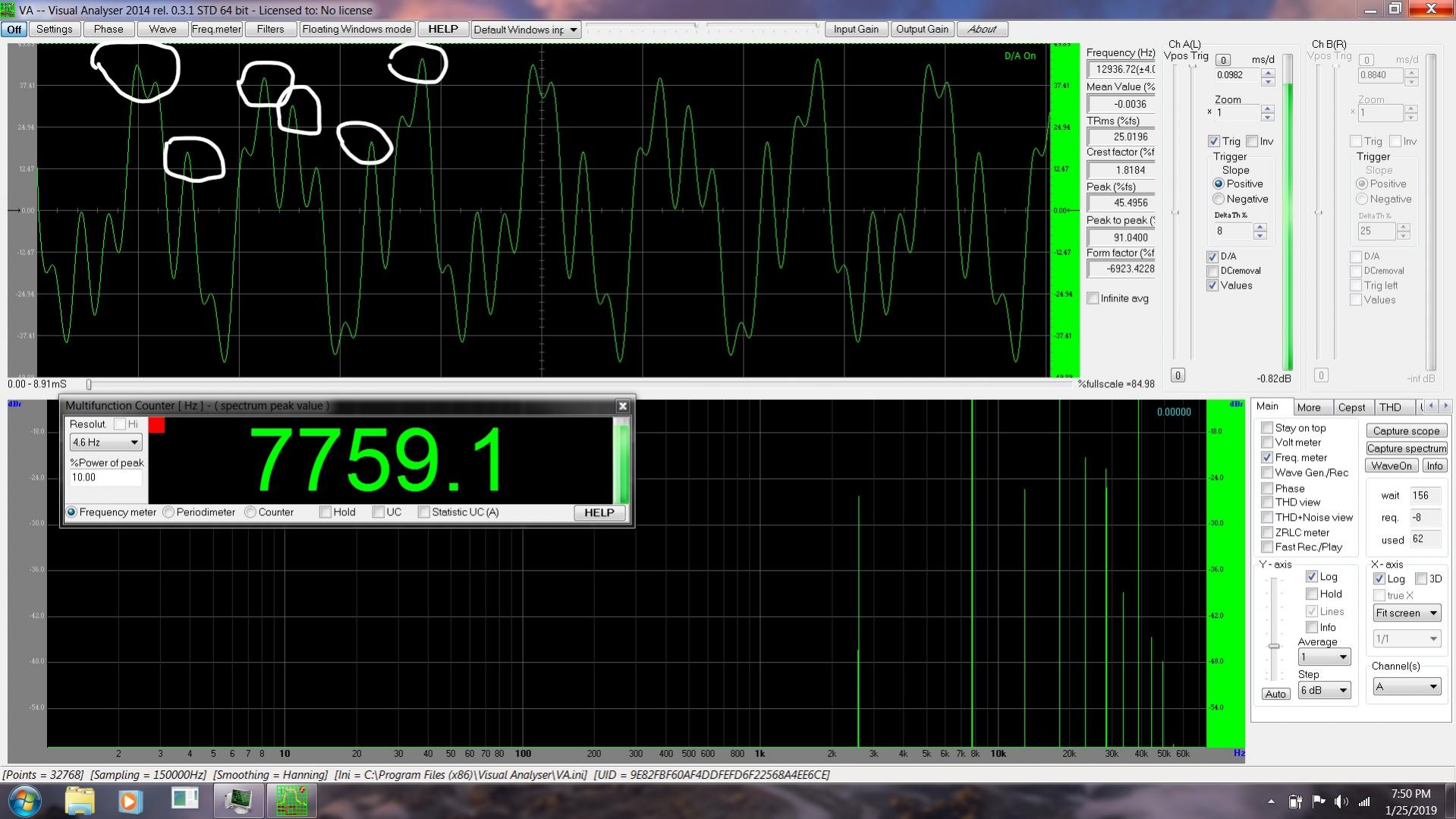

    With all the discussions about the Equinox and the multi-frequency features. Many down right arguments about what is or is not transmitted. I'd like to be instructed as to how many frequencies are actually being transmitted. I circled each of the frequency peaks I captured from my Equinox 800.
    The criteria that proves a frequency is transmitted or not. Click image for larger version

    Mark, why have you started another pointless thread on the subject, when there are already two perfectly good ones in existence?
    And if you don't understand what you're seeing on your Virtual Analyser screen, just ask , or read the user guide ( I assume there is one ..?)
    Do you even know what 'frequency' is ? It has nothing to do with those heavily-rounded-off features that you have drawn circles around.
    The bottom 'window' shows the frequency components.
    The top 'window' attempts to show the actual waveform, albeit severely low-pass filtered. The 'Equinox Challenge' thread shows what it's supposed to look like if you read through it ... specifically Qiaozhi's Spice model, or my re-creation, showing one whole cycle of about 385 microseconds length:

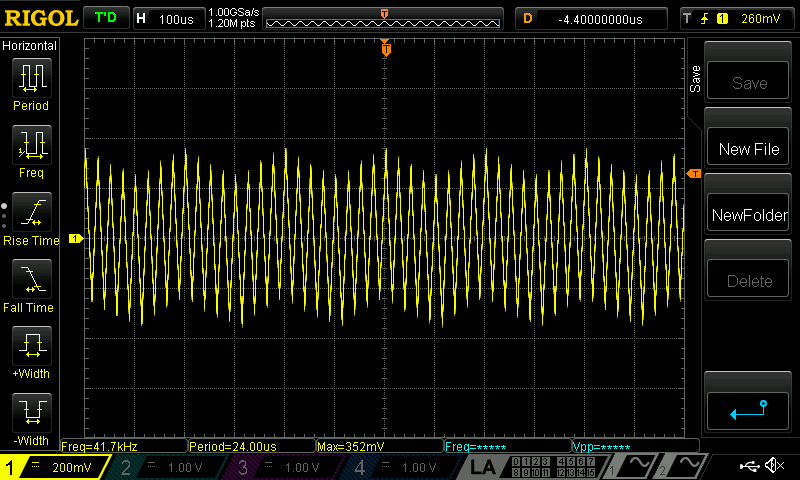

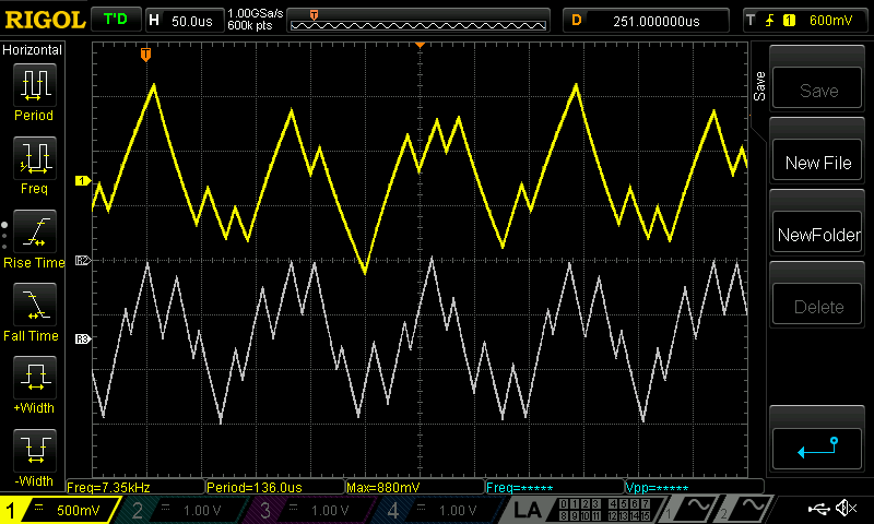

      Ugh, the sample rate is just awful. Here is what you should see:
      Top trace is Beach-MF and bottom trace is Park MF. Here is Prospecting-MF:
      Note the 40kHz is slightly modulated at 5kHz.

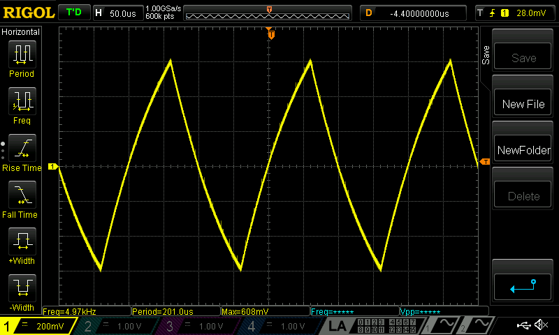

      Here is single-freq @ 5kHz:
      The tau of the coil really starts to show up here. If Minelab bumped this up to 7.8kHz as some people claim, it was probably to improve battery life.
        He's 'complaining' about your sample rate because it's extremely poor at showing what the transmitted coil voltage/current/magnetic field ( take your pick) really looks like. However, you are (just) sampling at a rate that's higher than twice the maximum frequency that we are interested in. Maximum Nox frequency of relevance is 40kHz, you/Nino are sampling at 96000 samples/second, or greater. So provided you take enough samples ( eg. many thousand ) to do your frequency analysis maths on, you should get a faithful result produced.
        And this seems to be the case, your spectrum results look good, your sampled waveform is awful. The main flaw in your spectrum result is the amplitude levels it shows. The '39kHz' should be stronger. It's lower because of the sound-card being designed for hifi/audio purposes , not laboratory instrumentation.
          thanks, I'll experiment with the different sample/second settings tonight
          thanks for the added information.
            There's little point experimenting further with the settings, it's a PC sound card, that's all. You're lucky it can do what it does, maybe it's a 'HD' card ? many soundcards flat out ignore any frequency above 24kHz, as it's beyond audible, and also not reproducible with the highest 'standard' sample rate of 48k samples/sec ( DVD standard).
            You need sample rates of 1 Megasamples/sec minimum to see the details of the Multi-Freq waveform, combined with a signal bandwidth of 500 kHz. And even then it will have some small flaws visible.

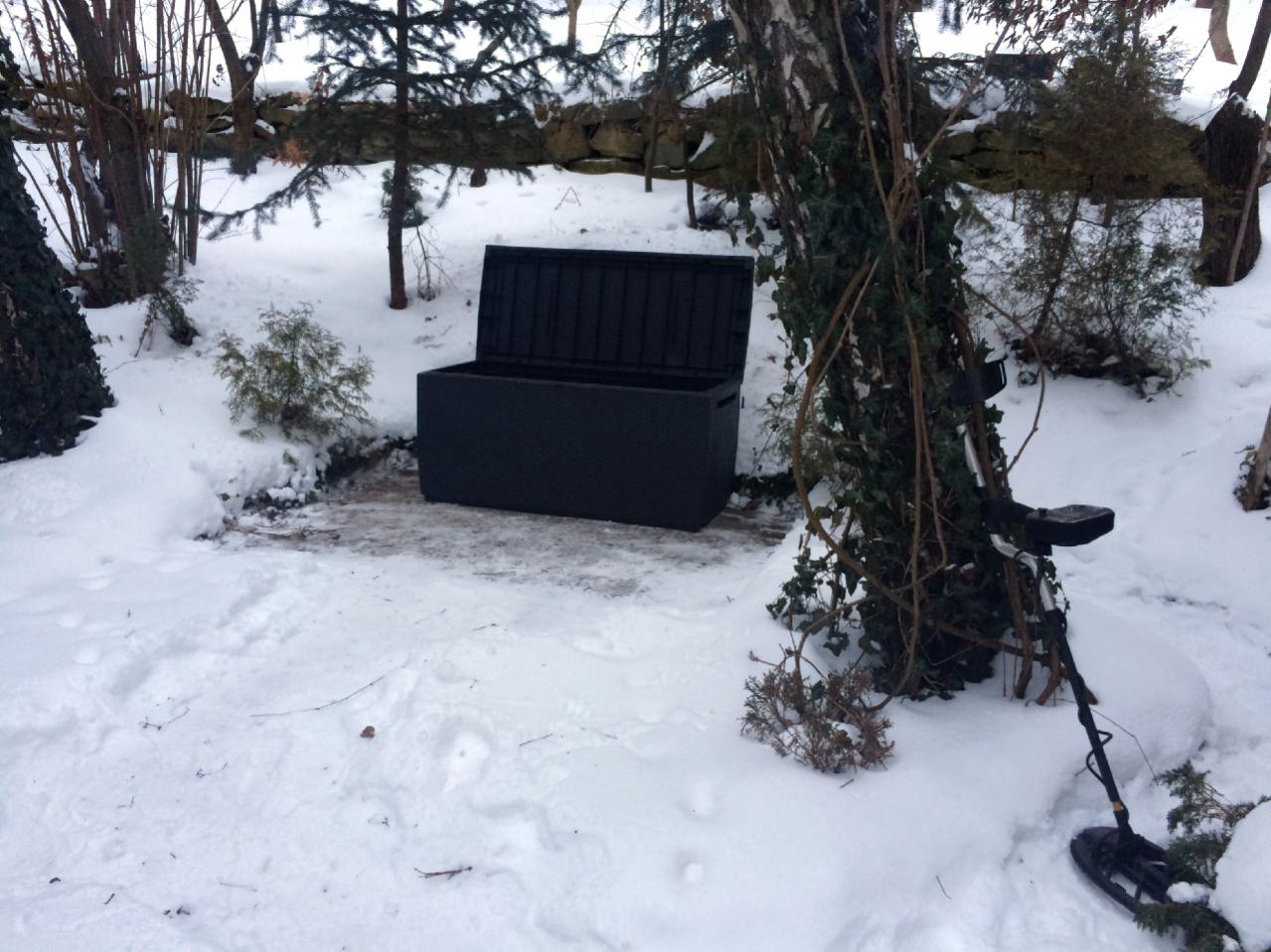

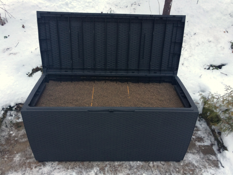

                Skippy .... Thank you for explaining the problem ... ... actually, we can be glad to have such a simple equipping something quite well-orientationally measured .. If we want to be more ... we need better instruments-oscilloscopes-it will be another step for me...Meanwhile, I checked ....for practical tests and verification of certain theories similar to Liapor-Ceramic Mineralized Substrate-Test Box as colleague WM6 ..
