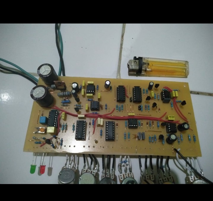

              I've made XR71 for a long time and with 35cm results for 9mm caliber bullets. But it looks like your design can be better than that.
              I'm waiting for your photo of the pcb

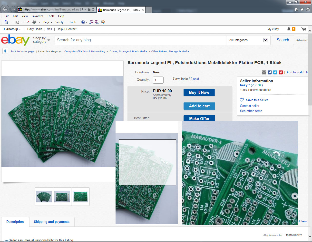

                      i can but i would like to tell you one case from my practic. i shared gerber files to one guy. then he went at ebay to sell the batch.
                      after this case i do not want more share gerber files be cause people do not appreciate my resource wasted.
                      they simply do NOT WANT to waste cents on my future projects. yes, i do a marauder,
                      but WHY those people want do A MARAUDER OF THE MARAUDER???
