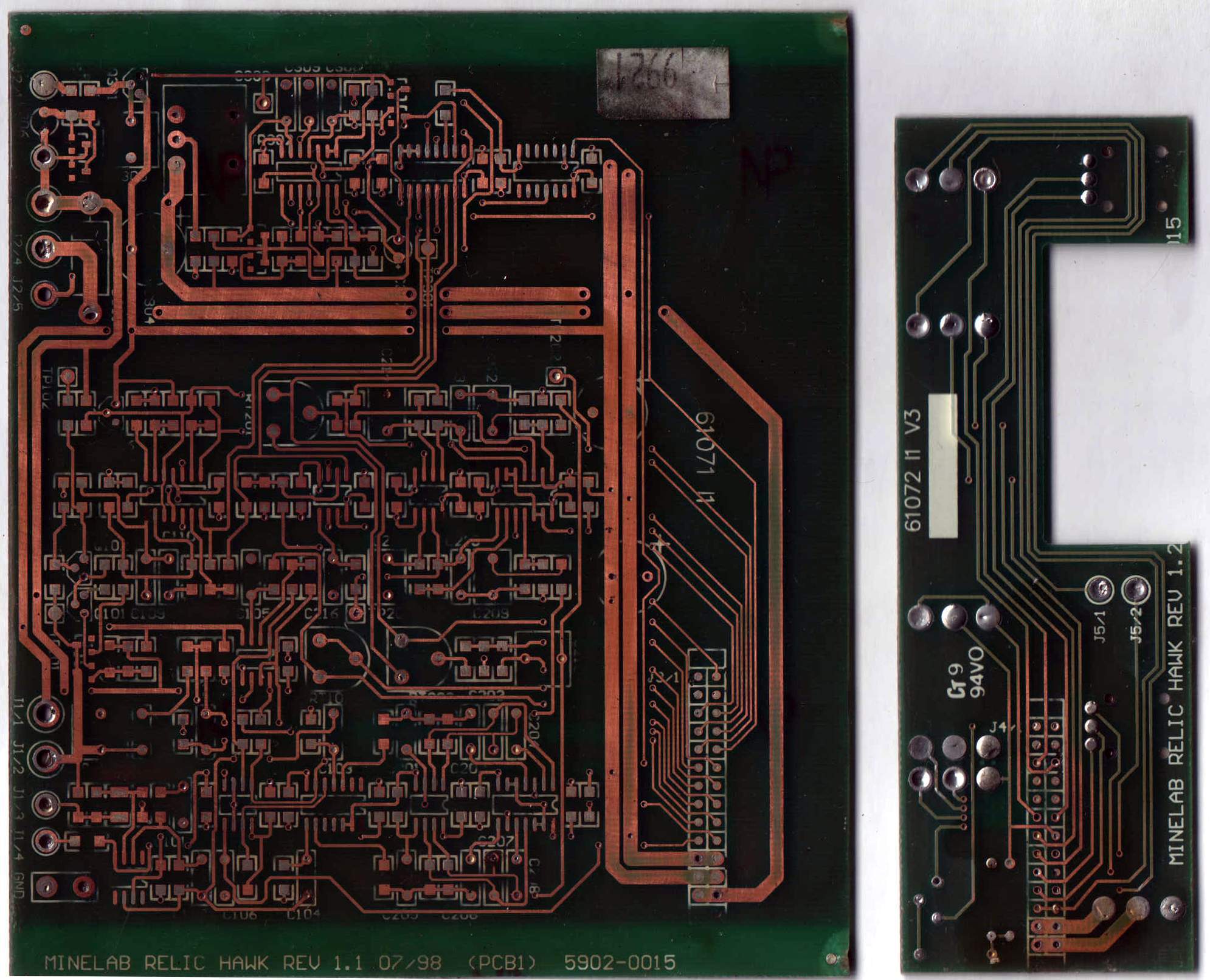

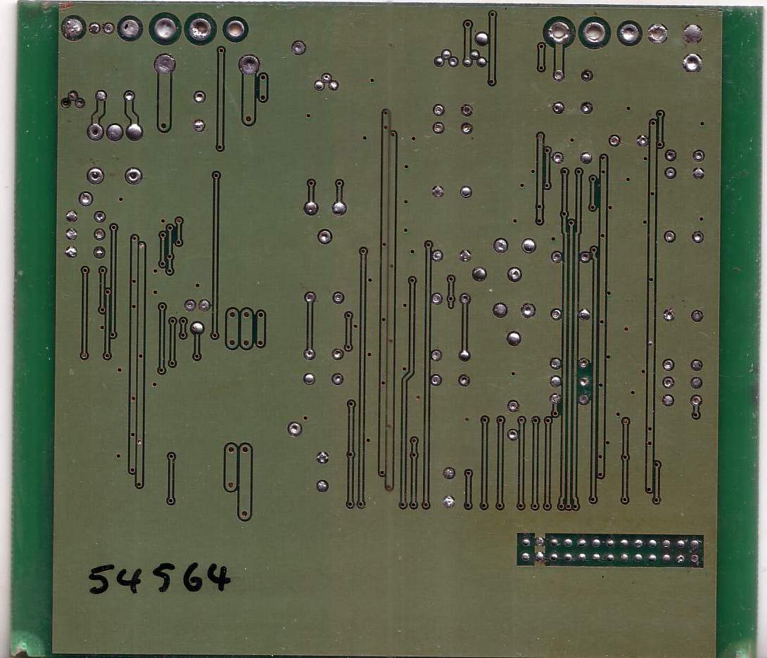

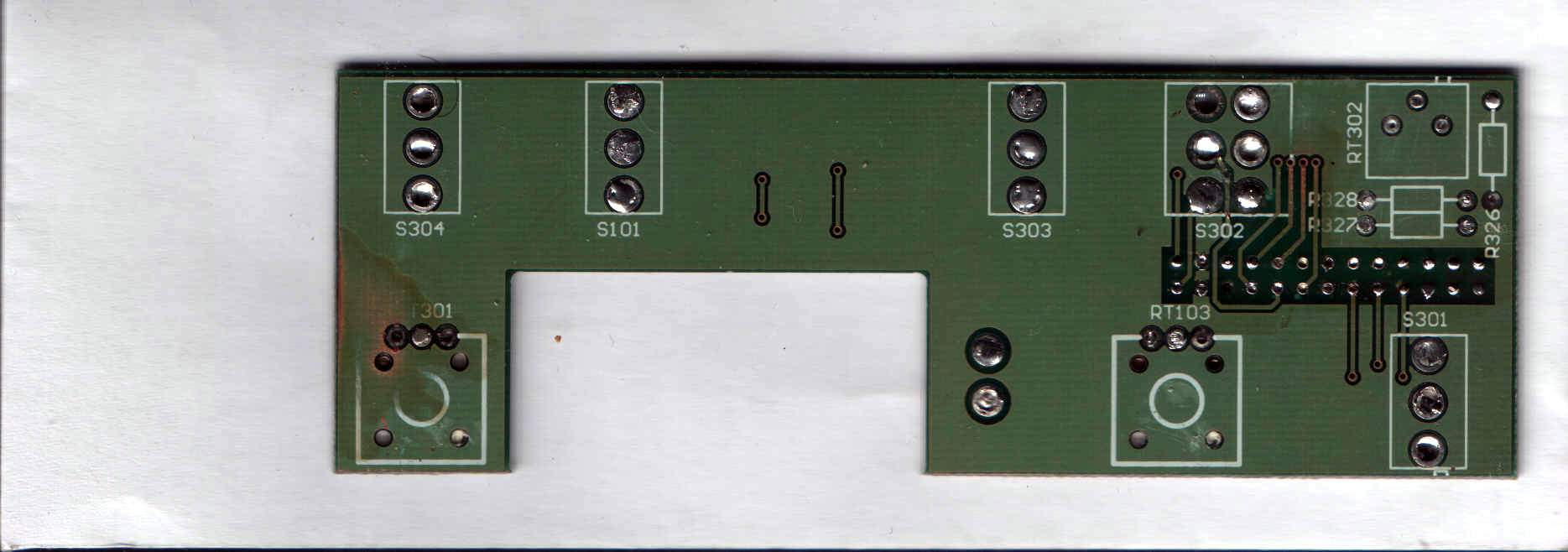

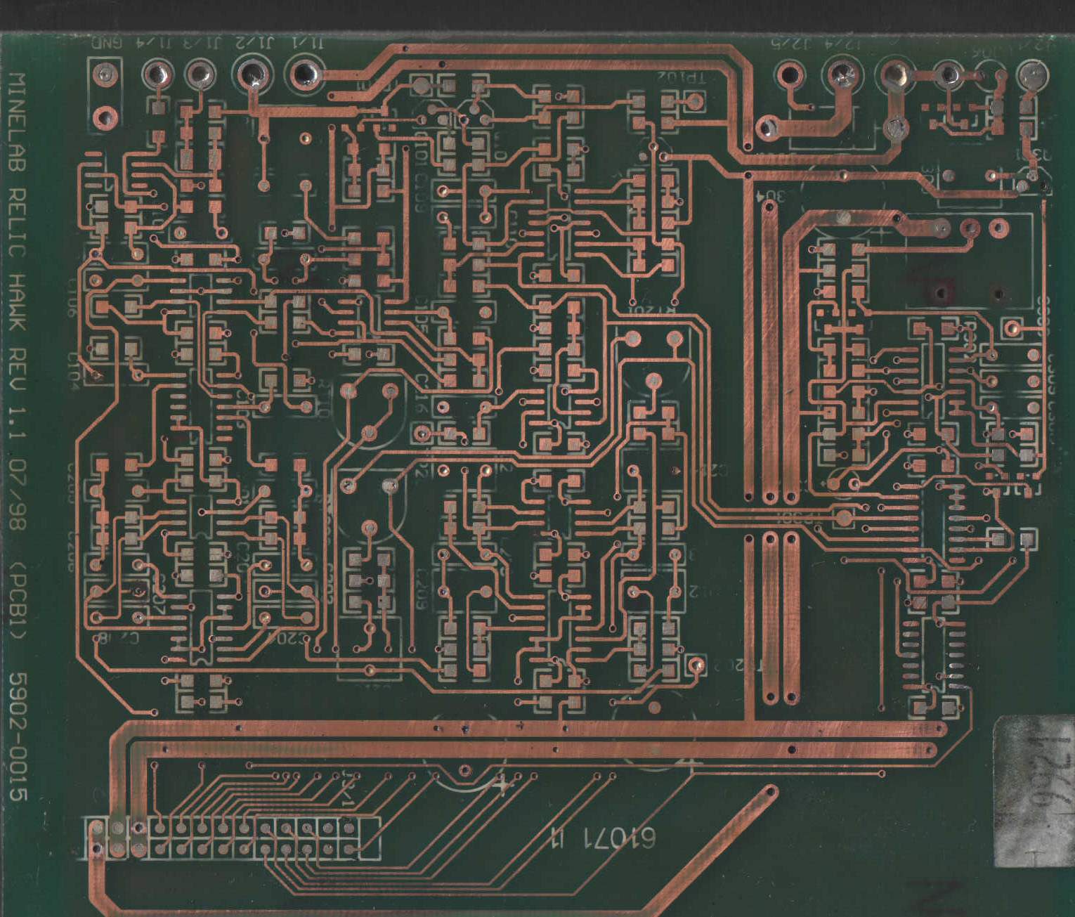

              electrostatic problem. can you give case inside pics i could see the right connection of interior shielding to the ground?
                Hi Guys and thanks to everyone who made suggestions and posted board pictures.
