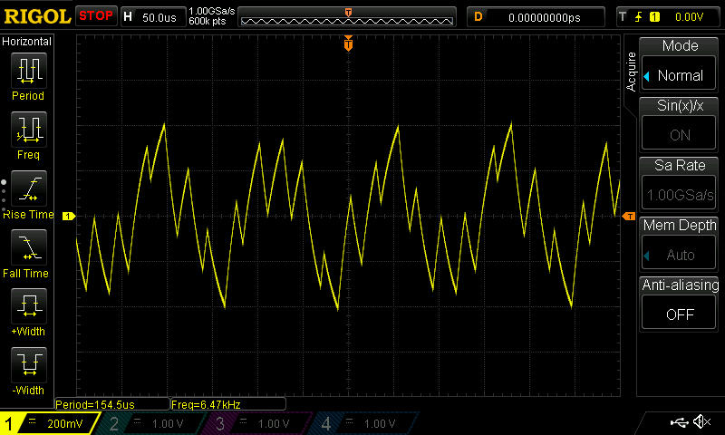

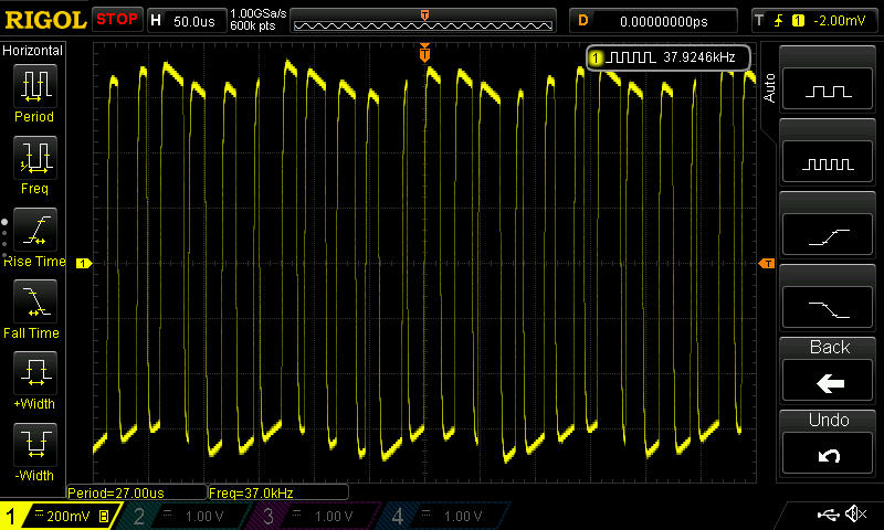

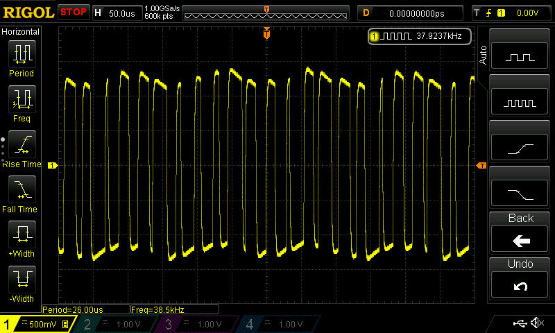

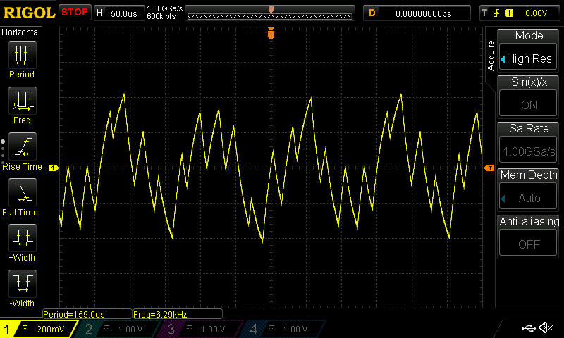

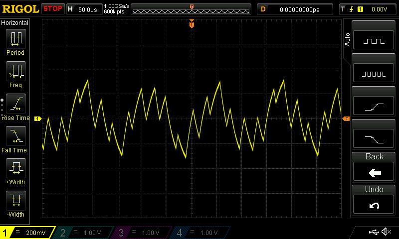

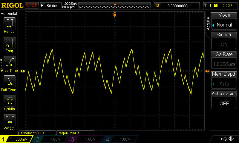

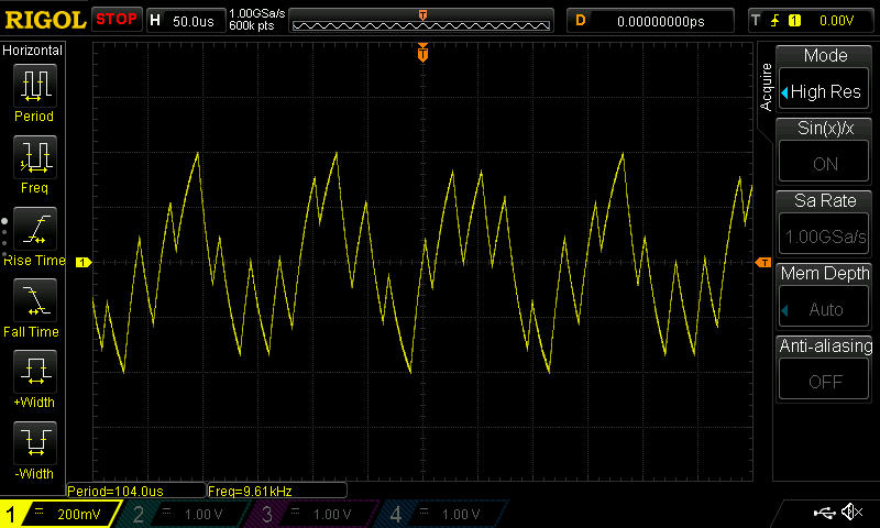

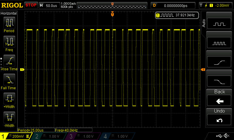

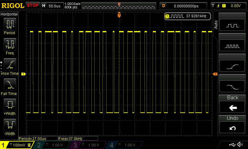

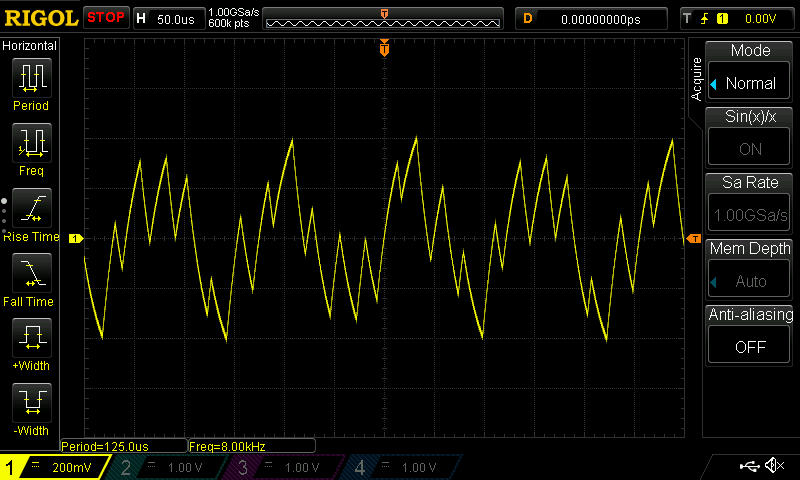

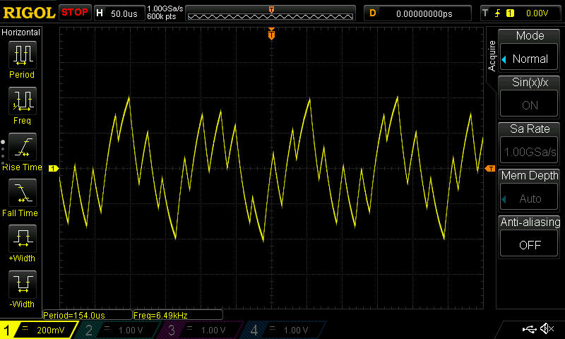

            When measuring I tried to use a paralelly placed 330 R resistor, the sweep coil is located very close to the Equinox coil in Park2 program:

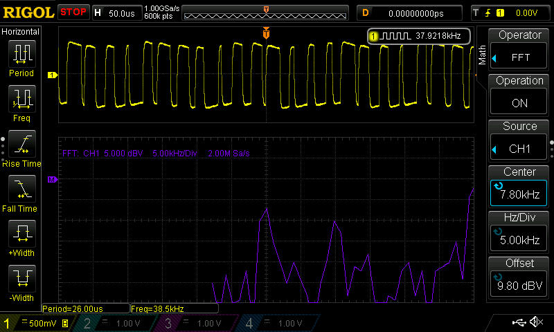

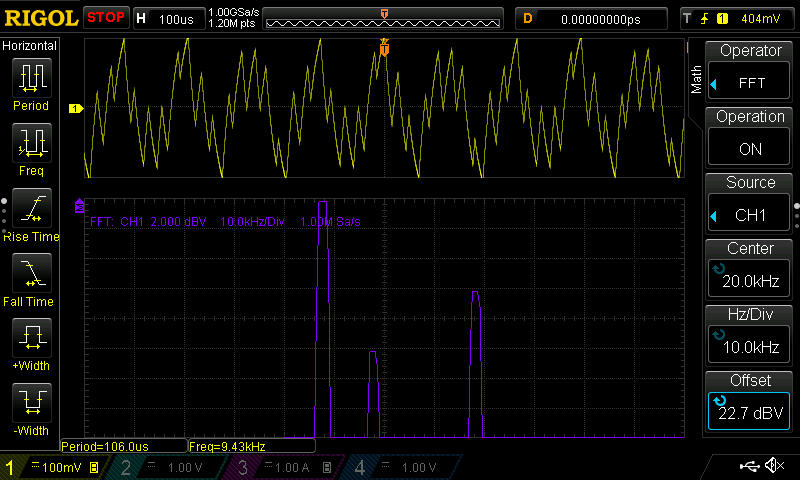

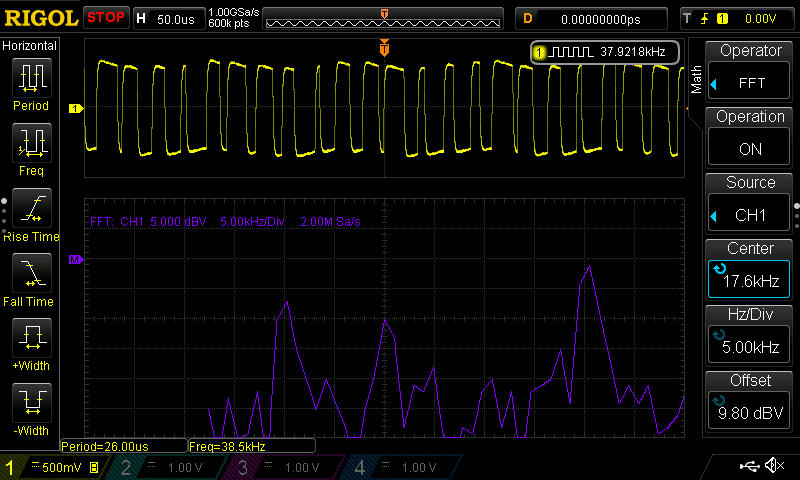

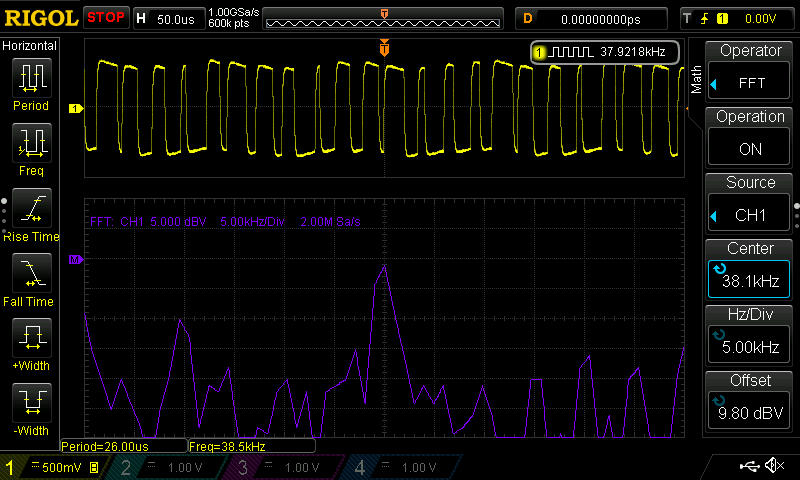

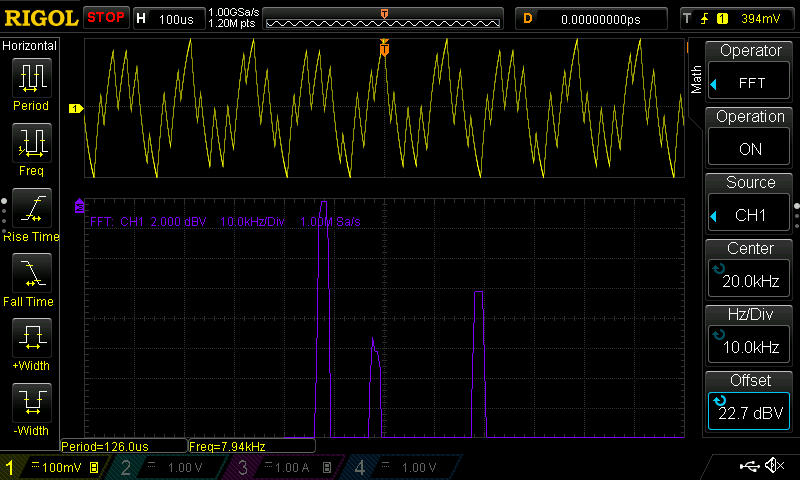

            I also tested the frequency measurement in Math -FTT in program Park2:

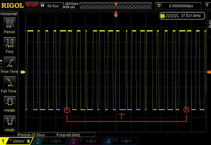

              That's better.
              I have marked on one of your waveform captures where the wave repeats. It takes 15 cycles of the dominant 39 kHz signal to repeat, every 385 microsecs.

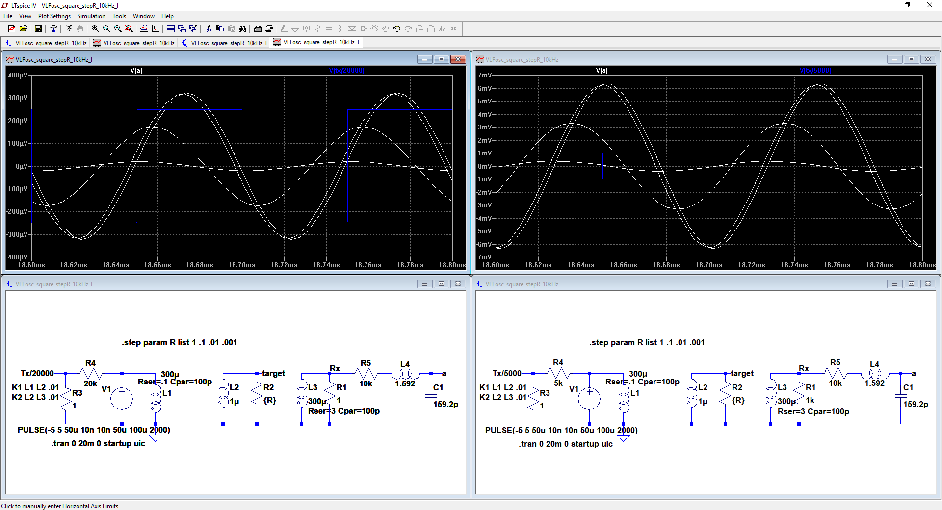

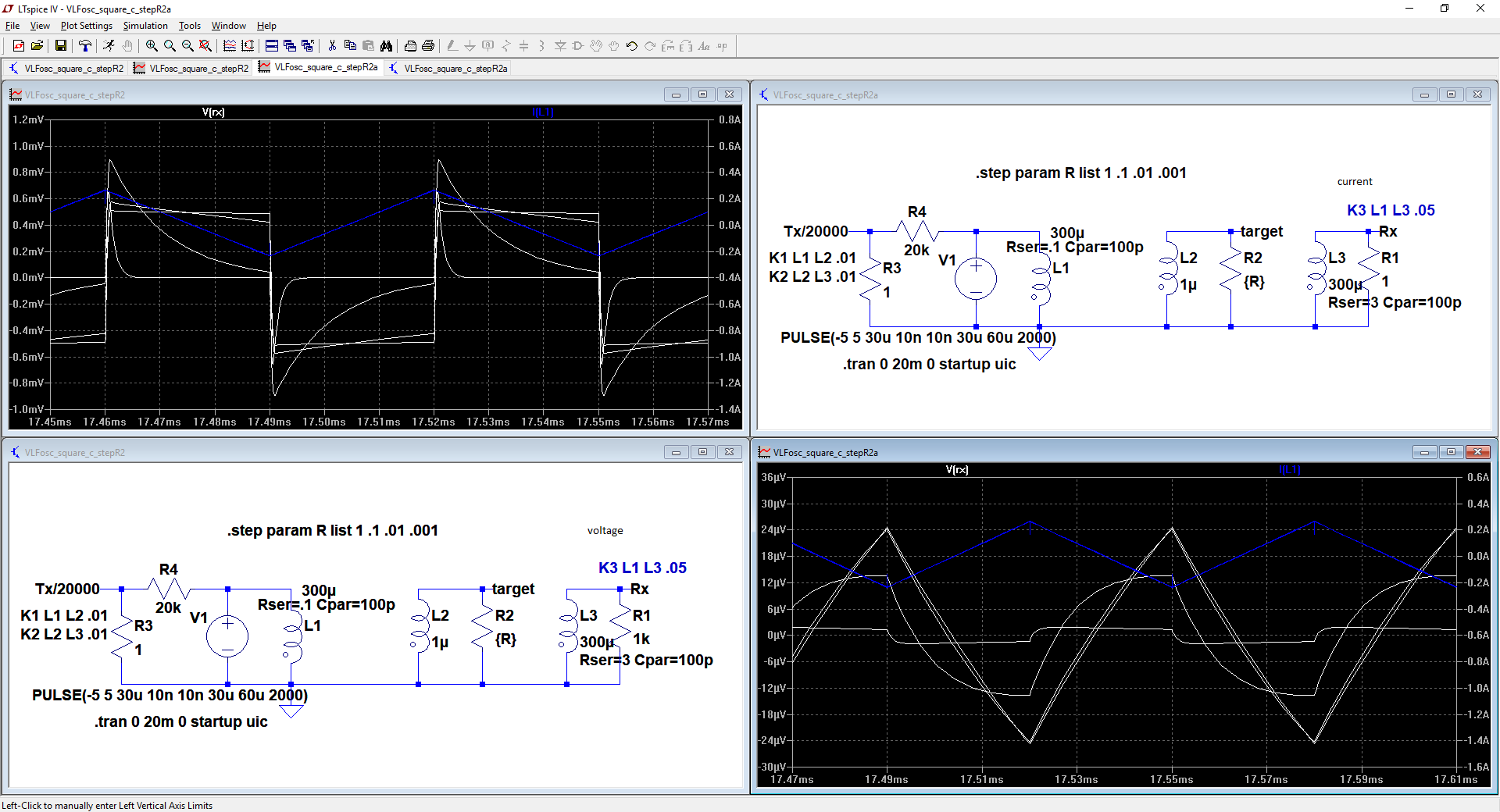

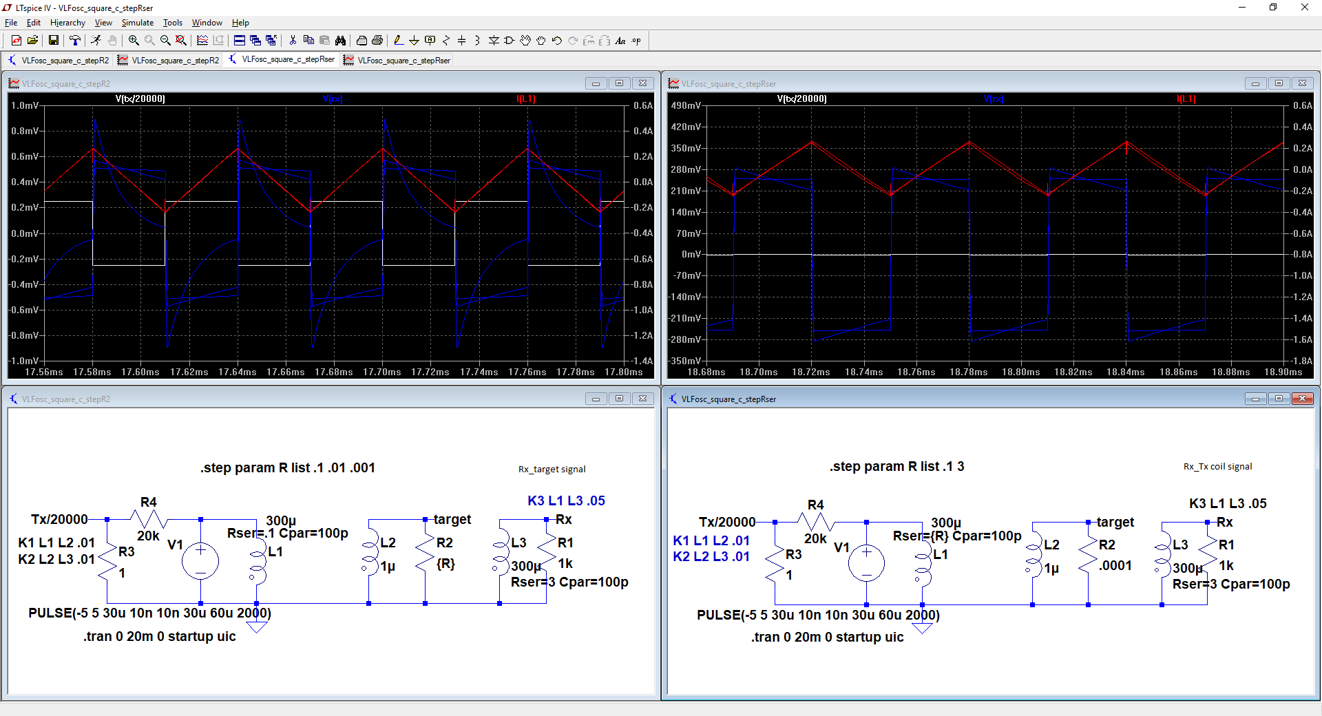

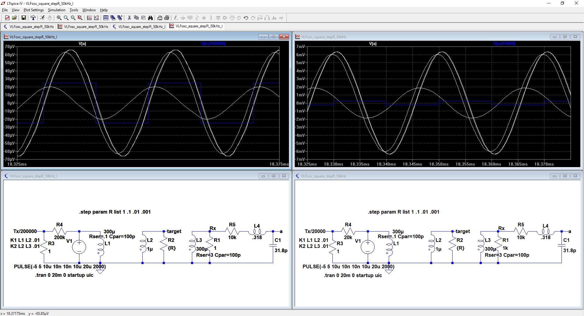

                Tried some spice simulation to see if I could understand what happens. Some thoughts.
                square Tx right chart: stepped Tx coil R(.1 and 3ohms). With constant Tx voltage, Tx current is constant rate(I/T=E/L)not effected by on time. Increased Tx coil R causes rate to decrease with time(IR drop). EL NINO's scope picture shows flat top, high L/R Tx coil? Easier to see the R effect in the voltage trace, maybe doesn't matter?
                left chart: stepped target TC(10, 100 and 1000us). Rx voltage trace same as Tx voltage trace inverted for the 1000us TC target. Rx voltage for lower TC targets droop with time, 1000us TC target would with enough time.
                square Tx_2 stepped target TC(1, 10, 100 and 1000us)
                right chart: Rx current(R1 one ohm). Rx traces for higher TC targets same as Tx current trace inverted. Traces for lower TC targets increase with time, flatten out and decay.
                left chart:Rx volts(R1 1k ohms). Rx traces for higher TC targets same as Tx voltage inverted.Traces for lower TC targets decay with time.
                Do simulations make sense?
                      You're on your way to designing time-domain single or multi-frequency detectors!

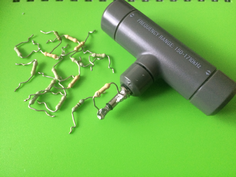

                      Carl, are you suggesting the detector should look at Rx coil current or just the pickup coil for recording Tx coil current with a scope?
                      There are 3 potential approaches:
                      1. Use a current probe; they are expensive so most people won't have this option.
                      2. Add a small series resistor, 0.1 - 0.5 ohms. This is really easy and, though it does very slightly change the waveform, it is probably unnoticeable.
                      3. Use a pick-up coil, connected in a current-mode amplifier.
                      I have a current probe that I use for development purposes, but when I want to measure the TX waveform of an off-the-shelf detector, I use the pick-up coil.

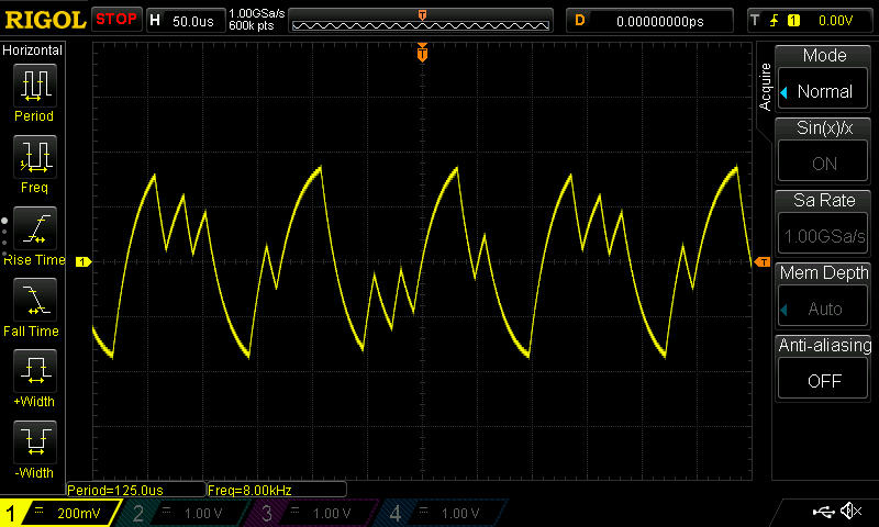

                        In the following measurements I used a parallel 10 ohms ( Mr Green s" suggestion) resistor:
                        Program Park1: Click image for larger version
                        Program Park2: Click image for larger version

                          Measurements I used a FFT:
                          Program Park1:
                          Program Park2:
                          Program Field1:
                          Program Field2:
                          Program Beach1:
                          Program Beach2:
                          Program Gold1:
                          Program Gold2:
                          Program Gold2: 1F 20 khz
                          Program Gold2 1F 40khz
                              Much better!

                                More spice. Added a band pass filter with a Q of 10, I think. Easiest way I could think of in spice. 10kHz and 50kHz Tx. Don't see a difference between Rx current(R1=1) and voltage(R1=1k)other than phase shift compared to Tx voltage. Maybe band pass filter with a Q of 10 isn't the way to look at Rx? Not planning on building VLF, just trying to understand how.
