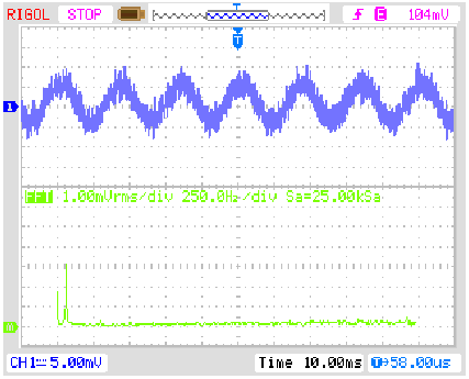

Scope trace(60Hz_3)with soldering iron by Rx coil. Tx coil disconnected, 60Hz+noise.

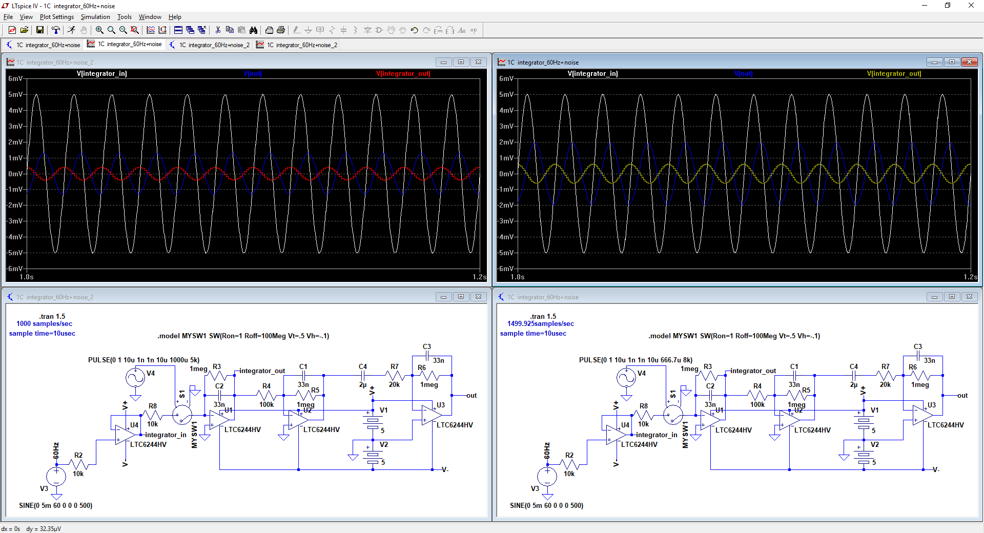

spice simulation(60hz)60Hz sampled at 1000 and 1499.925 samples/second. Don't see a difference other than 60Hz signal is higher with 1499.925 sample rate due to higher integrator gain.

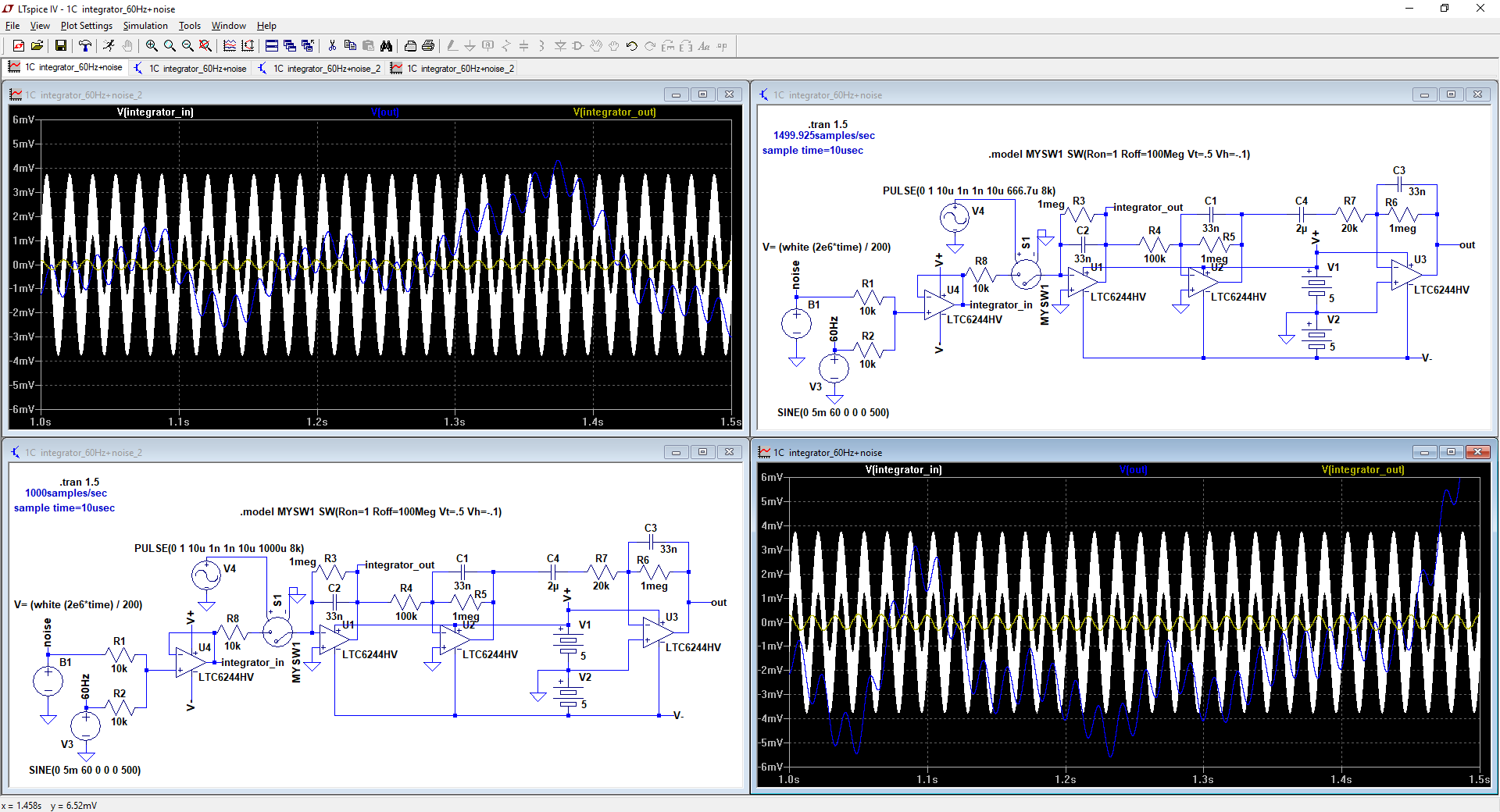

spice simulation(60Hz_2)60Hz+noise sampled at 1000 and 1499.925 samples/second. Don't see a difference other than 60Hz signal is higher with 1499.925 sample rate due to higher integrator gain and sample rate effected noise signal.

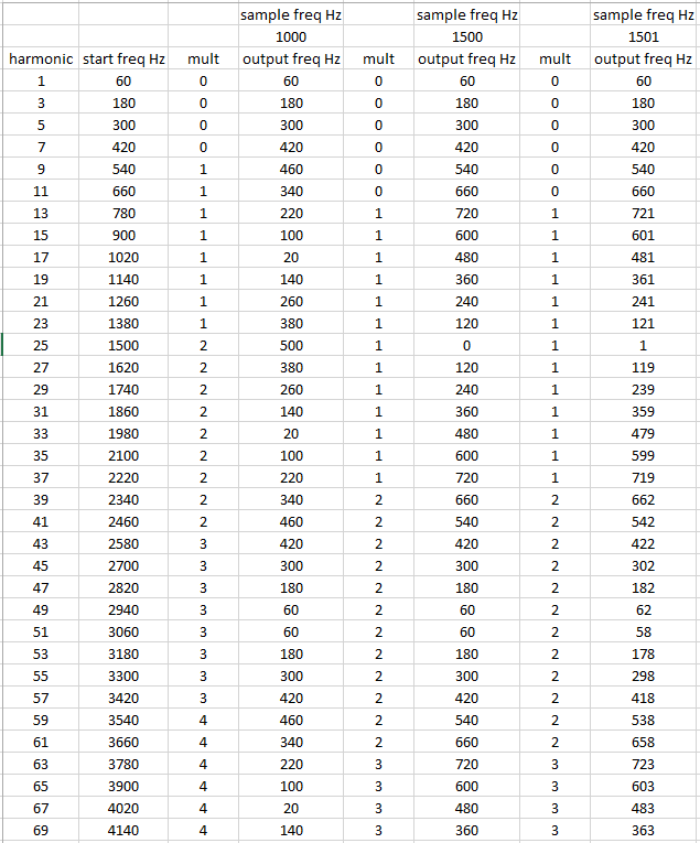

Yes, it's due to aliasing. If exactly synchronized to 60Hz then it becomes a DC offset. If very slightly off, then the beat frequency can be low enough that the SAT circuit removes it.If chart(aliasing_1) is correct the only odd harmonic that becomes DC offset is the 25th.
Don't know if simulation would be the same as detector. Don't see a difference but maybe can be heard? https://www.geotech1.com/forums/show...116#post239116 maybe waltr could show a scope trace of amplifier out and integrator out with sample rate in and out of sync.
I believe it can be heard, just don't see why. I would try but the only circuit working right now just has amplifier out, no integrator. Didn't have a 60Hz problem when detector was working with 1000samples/second. I wouldn't have heard it because I turn a led on when signal>threshold(bad hearing). Didn't see any beat frequency when looking at last integrator stage with a scope.
