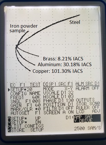

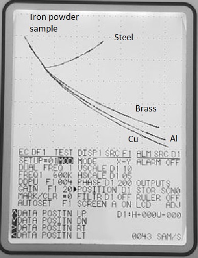

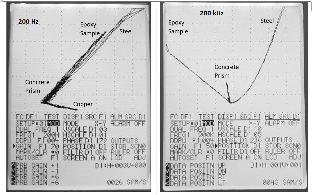

I used device with probe, like that from Bartington. I used eddy current probe from ZETEC ?MIZ-21B (link) to find the difference in response at various frequencies (from 200Hz to 200kHz) in these samples. I will post some of the impedance plane graph in response to another post. That would give more clear indication of what material I am trying to measure exactly.
