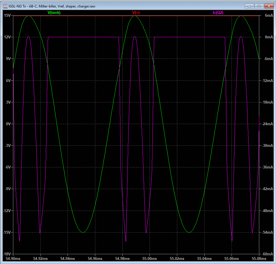

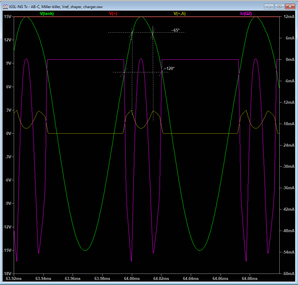

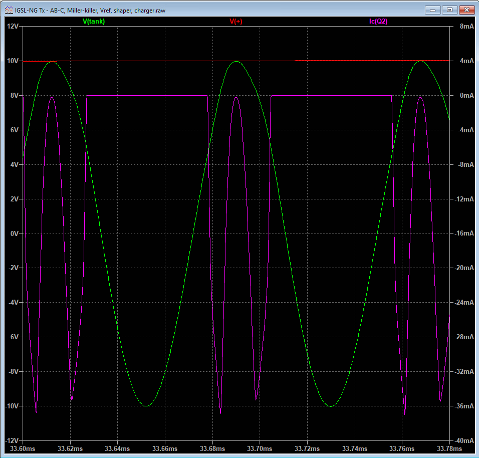

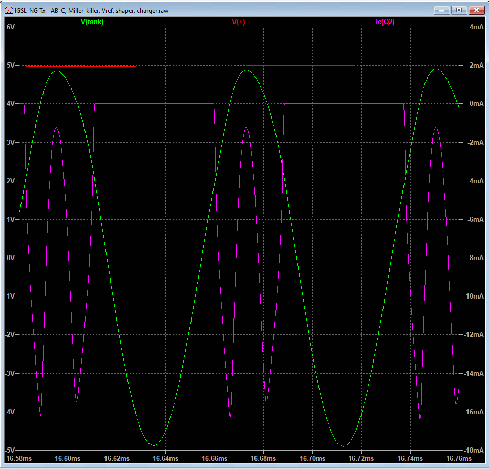

    Conduction angles:
      Transient responses during a slope:

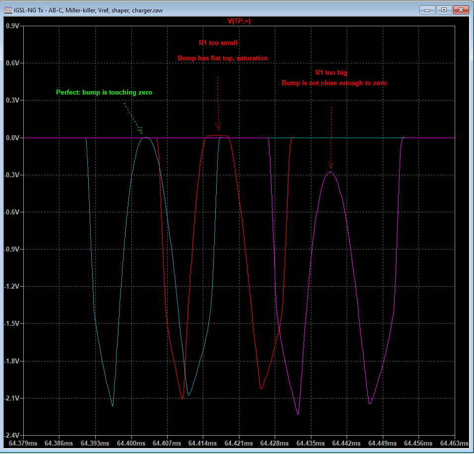

        R1 must be tuned properly to maintain amplitude stability and signal purity. It should be made as 22 ohm in series with a trimmer potentiometer of 50 - 100 ohm. For the purpose of tuning, I indicated a TP on a schematic. Oddly enough, the same procedure sould be applicable to all other single-ended oscillators with transistor in output. So when in doubt, try this method.
        Perfect value is obtained when the bump that forms in a middle of a conduction period does not cross 0V. It may get a bit flat, but the transistor current should not go reverse.

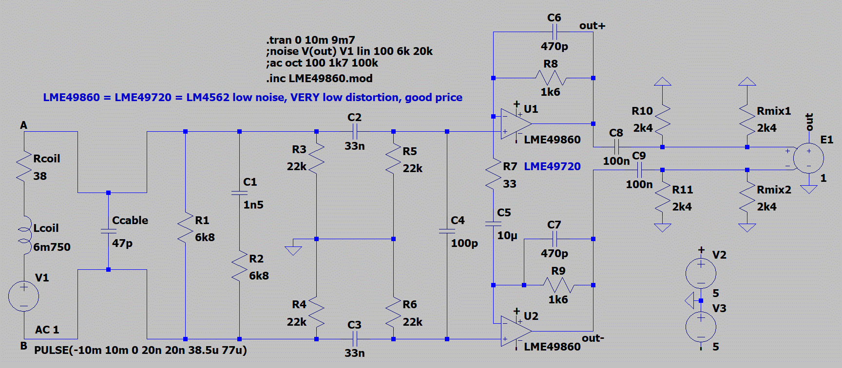

                          Back to the drawing board. The Rx preamp will be a fully differential amplifier, in aperiodic configuration. A few details, and a stream of thought...
                          Instrumentation amplifier has a fully differential input, but a single ended output. As I need a differential output for a double balanced mixer, I'll simply omit one stage and get a fully differential amplifier. Because it may work equally well for any kind of input topology, I'll be able to use it with just about any kind of coil there is, including centre-tapped shieldless ones that I prefer.
                          Aperiodic means non-resonant. By introducing a resonance, as most classic detectors have, it is possible to improve input referred noise by ~3 dB, shifting a resonance away from the working frequency without getting into trouble with phase shift. It is possible to improve noise by some more, but only by going to the very resonance. But there are two problems: noise is limited by the coil resistance, and the phase shift is all over the place. So scratch that.
                          Because nowadays opamps came close to the noise limit of the very coil, why not discarding the resonance concept altogether?
                          Advantage of aperiodic front end is that every coil you hook up will work immediately, without any tuning. Plug and play.
                          Disadvantage of a fully differential input is 3 dB more noise than a single ended input. I think it is worth it.
                          Because turning an aperiodic front end into a resonant one is only a single capacitor away, I'll leave the choice to the individual builder. If you have more than one coil, you are better off leaving it aperiodic. If you have only one coil, and want to squeeze the most out of it, then play with capacitors. Your choice.
                            Moving on.
                            After some consideration, I opted for a middle path, basically an aperiodic preamp, but with heavily damped frequency-dependent parts.
                            The prefered IC here is LME49720. In PDIP form it has a same pinout as NE5532, and many others. But LME49720 has a far superior distortion.
                            It is fully differential in a sense that it will happily work with differential or single ended coil, producing differential output with only 2% error (gain is ~50) in case of single ended coil. Not bad at all.
                            A few details...
                            Gain is about 50 per output, and hence differential gain is about 100.
                            R1 is the main damping resistor. It defines the impedance the coil sees. It has basically the same purpose as the damping resistor in PI machines. C1R2 are a "damped resonant capacitor", which is not so much resonant as it is good for fixing the higher frequencies. R3-R6, and C2-3 take care of biasing and act as a high pass filter to reduce mains hum entering the mixer.
                            C4 is to reduce RF influence.
                            R7 not critical, should be metal film, but hey, aren't they all, and C5 should be bipolar.
                            R8 and R9 should be from E24 or better, hence odd values, and preferably the same within 1% tolerance. It is OK to put 1k5, or 1k8 from E12, but check their resistance first.
                            C8 and C9, with R10 and R11, and mixer input impedance form a high pass to further reduce hum, but also to eliminate any offset by preamp.
                            I'll send LTspice files in the next mail.
