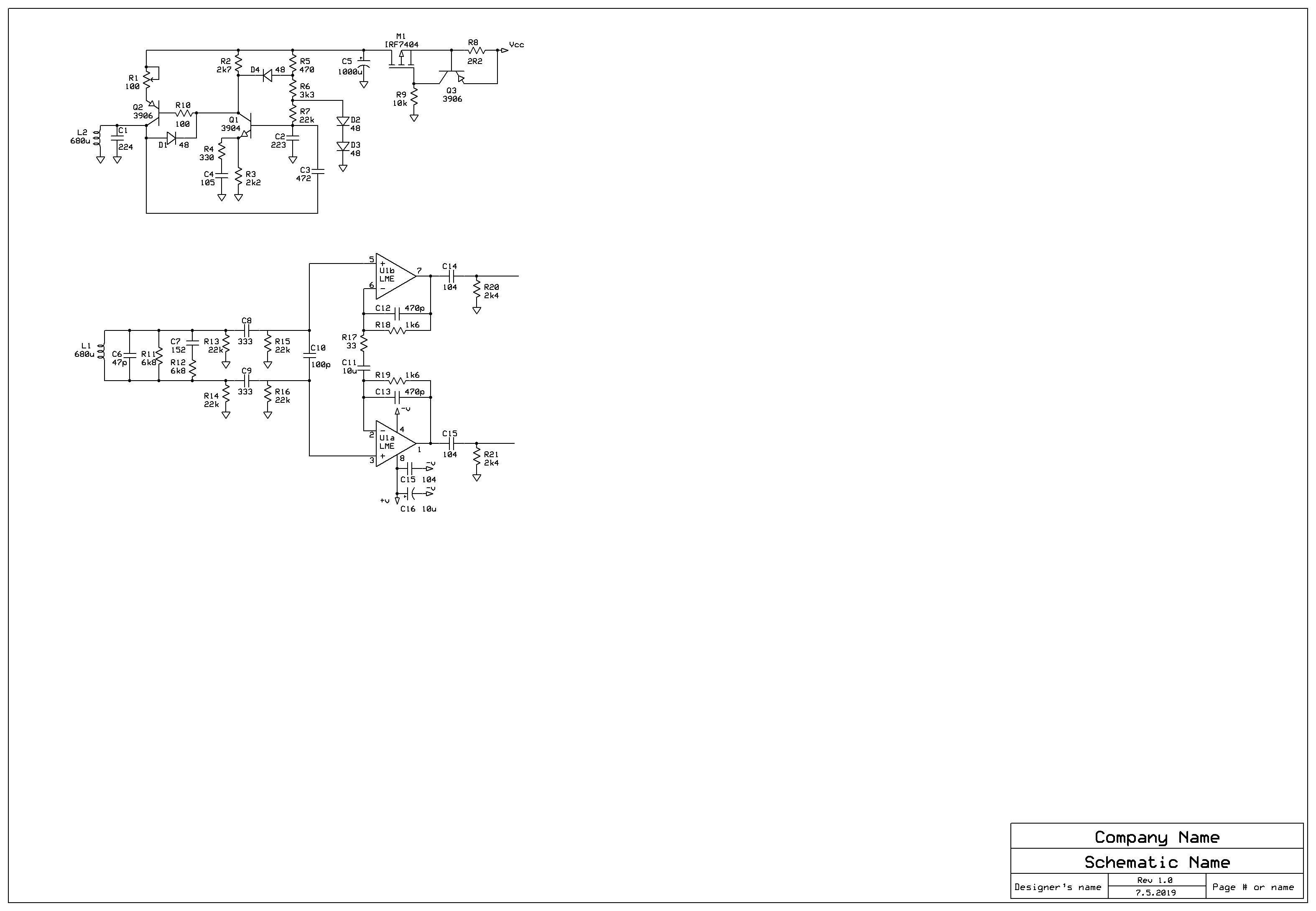

IGSL-NG
    Here are the LTspice files for convenience. If someone wishes to make it into a PCB, and use it as an independent project, please note that resistors and capacitors that are not numerated with plain vanilla numbers do not belong to this circuit, but to a coil/cable, or a mixer.

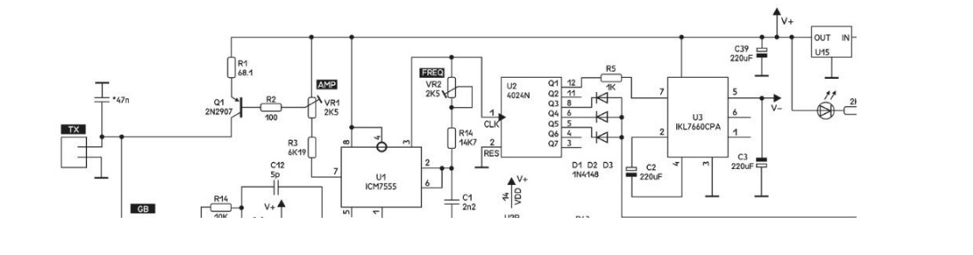

      I propose to your attention this preamp I made; pheraps this contribute could give some hints...
        I forgot to attach the schematic, as it is so far:

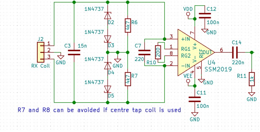

          if you make the preamp a separate PCB there would be an option to place it closer to the Rx. There must be a noise reduction. Difference might be to small to bother about ?
            Originally posted by Altair View Post
            i like your fontend design.
            This should work well, but I need a differential output. Also I wanted to pay less, so I'll stick to my solution.
            BTW, I'd replace 4k7 resistors with larger values, and also add a single 10k resistor to dampen the resonance, centre tapped or not. This configuration is less affected to switching between balanced and single ended coils.
            I also intended to go with a DC connection, but decided to go with AC to reduce mains hum pickup.
            Anyway, you have a nice clean design.
              At MD frequencies, and with little care about the terminating impedances it should not matter. You have to pay attention to everything that is terminated with 100k or more, as any extra wire will pick hum from proximity of your hands, and just about any kind of interference.

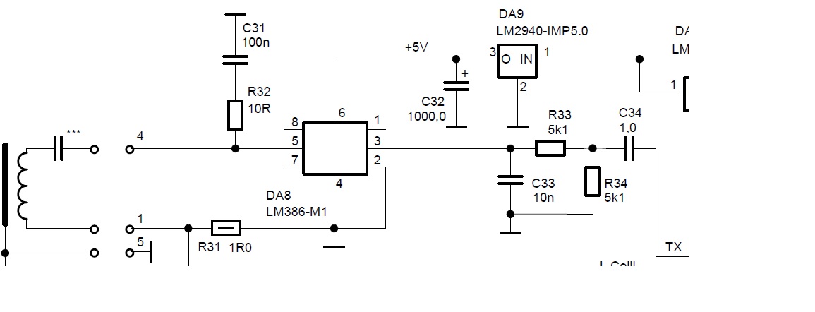

                hello, it would be possible to improve tx through a capacitor and an amplifier lm386, it would also be necessary to modify the samples gb and discrimination? ,,
ID:	354163 are some images of modern tx cirtutos ,,,, that we could see how to make functions in tgsl?
                      This configuration is good for a MCU controlled Tx, and that's precisely what I wish to avoid here. Of all classic detectors I think only a Gold Bug has a forced oscillation. Its advantage is you know precisely what frequency your Tx is on. But the free running oscillators have a better efficiency. Then again the forced oscillators may be free from certain harmonics, and 1/f noise... (not Gold Bug).

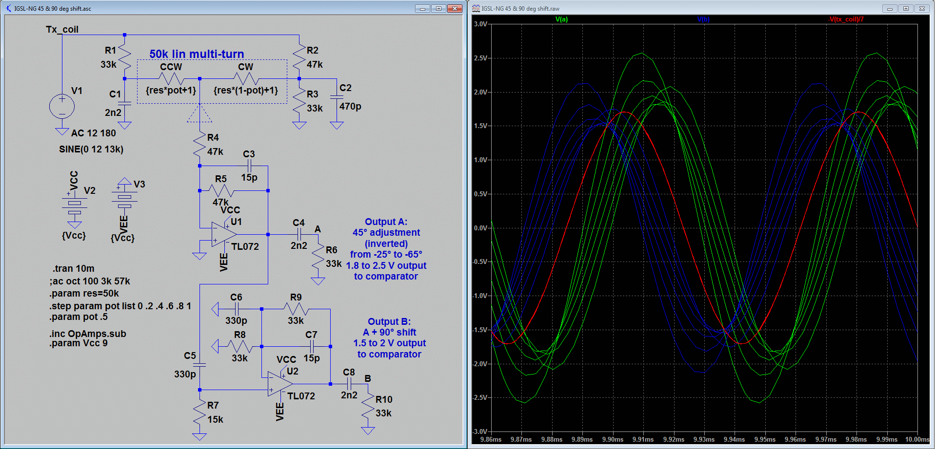

                            Next, a phase shifter.
                            As noted before, I need one phase at 45 degrees against a ferrite response, and another one 90 degrees away from the first phase. It is because I'll use a CD4052 type CMOS switch. Unlike simple switches that are used with 180 degrees conduction angle, 4052 has 90 degrees conduction angles, and therefore its mid point is at 45 degrees shift.
                            Because there is always some extra shift introduced in a preamp, and it depends also on the coil, some adjustment is necessary. As I decided to go with a single tuning point, it will be done at a 45 degrees shifter.
                            Design is a bit more elaborate than an usual shifter, but with 5% components (or better) it should do just fine.
                            Adjustable 45 degree shifter is realised with a 50k (trim) potentiometer, ideally a multi turn, R1-R6, C1-C4, and U1. To "uncomplicate" it, I used U1 in inverting configuration for flexibility. It ensures operation in input common mode as long as its output does not saturate. It also buffers the phasing circuit. Its gain may be adjusted by modifying R5, but for the sake of BOM simplicity just leave it be as it is.
                            The very phase shifting is done by a bridge R1-R3, C1-C2, a pot, and R4 for equalisation. The left branch R1/C1 provides big phase shift, but at low amplitude, so the other side has amplitude reduced by R2/R3 divider, and a low phase shift is provided by C2. A potentiometer thus slides from more to less phase shift, but the amplitude variation is very little. Perhaps the adjustment in opposite direction from the shown is more logical.
                            fixed 90 degrees shift is a 2-C non-inverting differentiator made with U2, R7-R10, and C5-C8. I chose this one for stability. Similar to a 2-C integrator, it consists of 2 high pass sections, one in non-inverting input, and the other in inverting branch, tuned to the same corner frequency, and the result is a differentiator with predictable stability. Its gain is determined by R9:R8+1. With modestly accurate components it should provide very close to 90 degrees shift against the U1 output, over a wide frequency span.

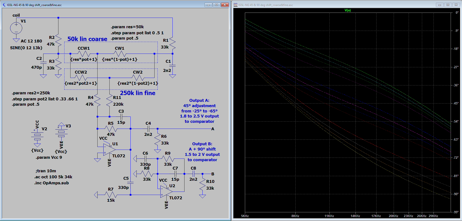

                            • #44
                              Just a small correction and a feature for a phase shifter. Instead of a multiturn trimmer, you may use a coarse and a fine tuning normal trimmers. Or if you prefer multiturn, simply omit the fine tuning trimmer, and use a multiturn instead of a coarse one. The picture shows the AC plot, and as you may see it is OK for tuning in a frequency span between 9 and 18 kHz.
