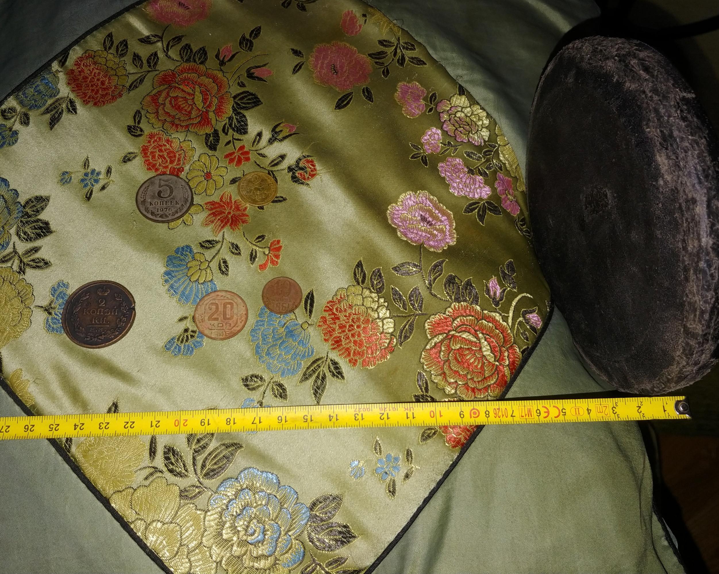

    I gues my Cscope TR 200 see coins deeper than this mode, may be someone show test on video?

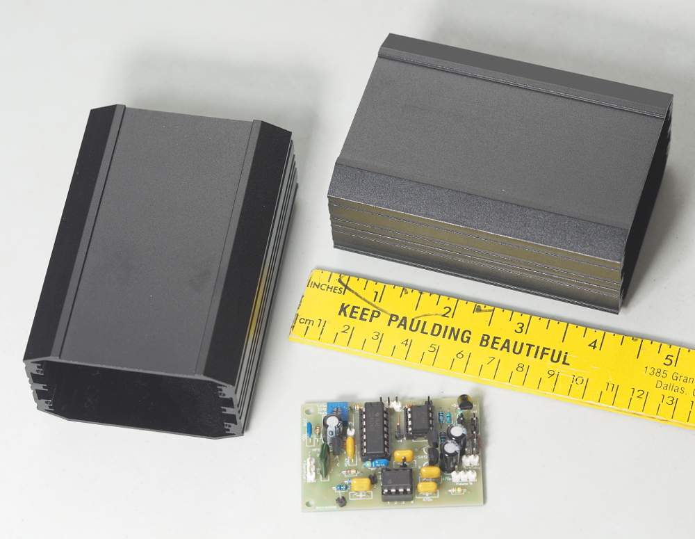

                        Just rec'd a couple small enclosures to use with mine.

                          Nice one Sven, I put mine in the same enclosure,,,fits nice and dainty! Regards, Marty.
                            [ATTACH]53711[/ATTACH]

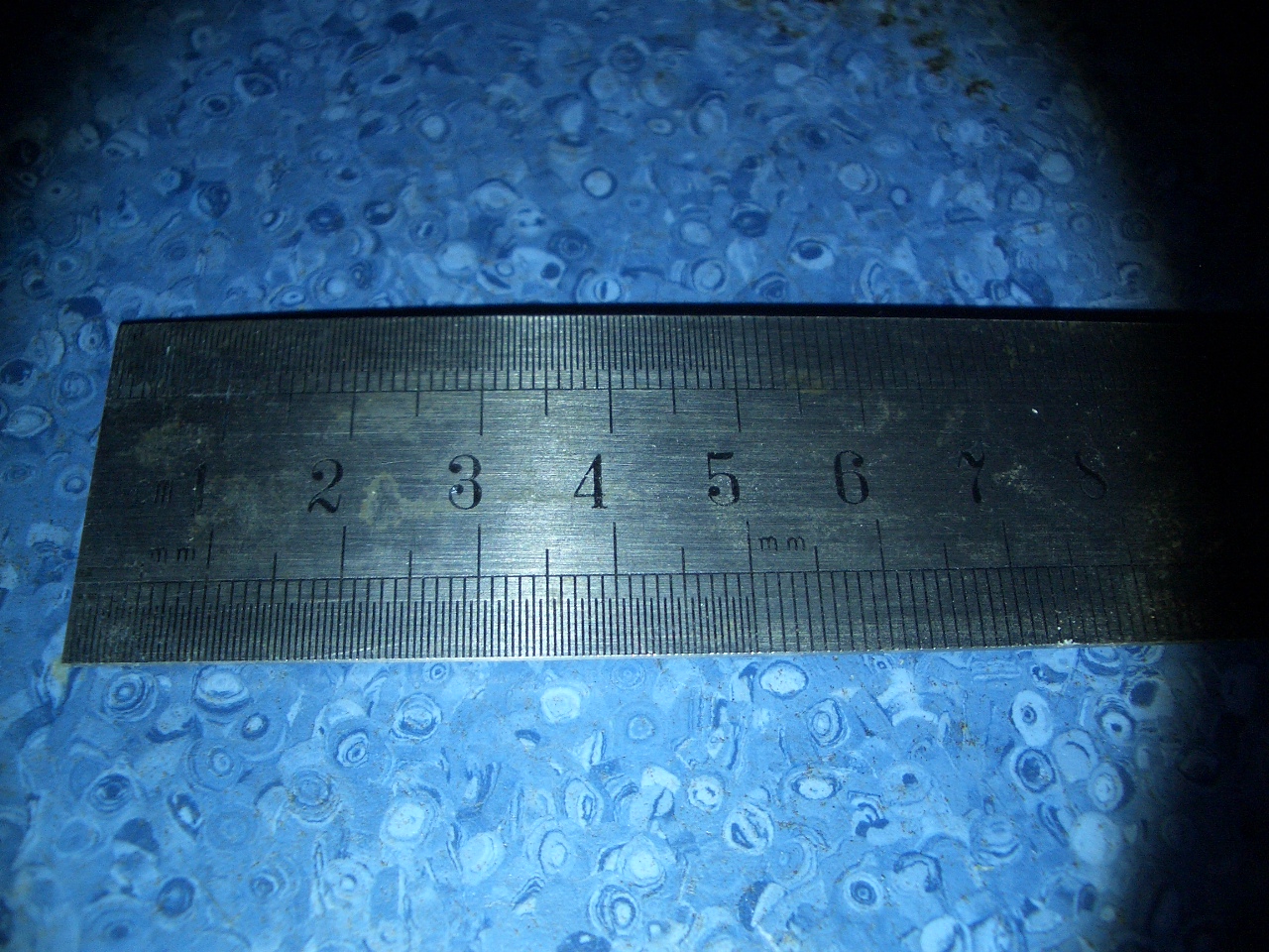

                            your ruler in metric side is amazing LOL!
                            • #74
                              it is mine one. just for a comparison.
                              • #75
                                At work, I use a metric caliper to measure down to 0.01mm. An do use metric rulers like you have. So yeah, the yellow inch-cm ruler I just grabbed off the shelf for the picture. Makes it easier for those that don't use the metric system.
