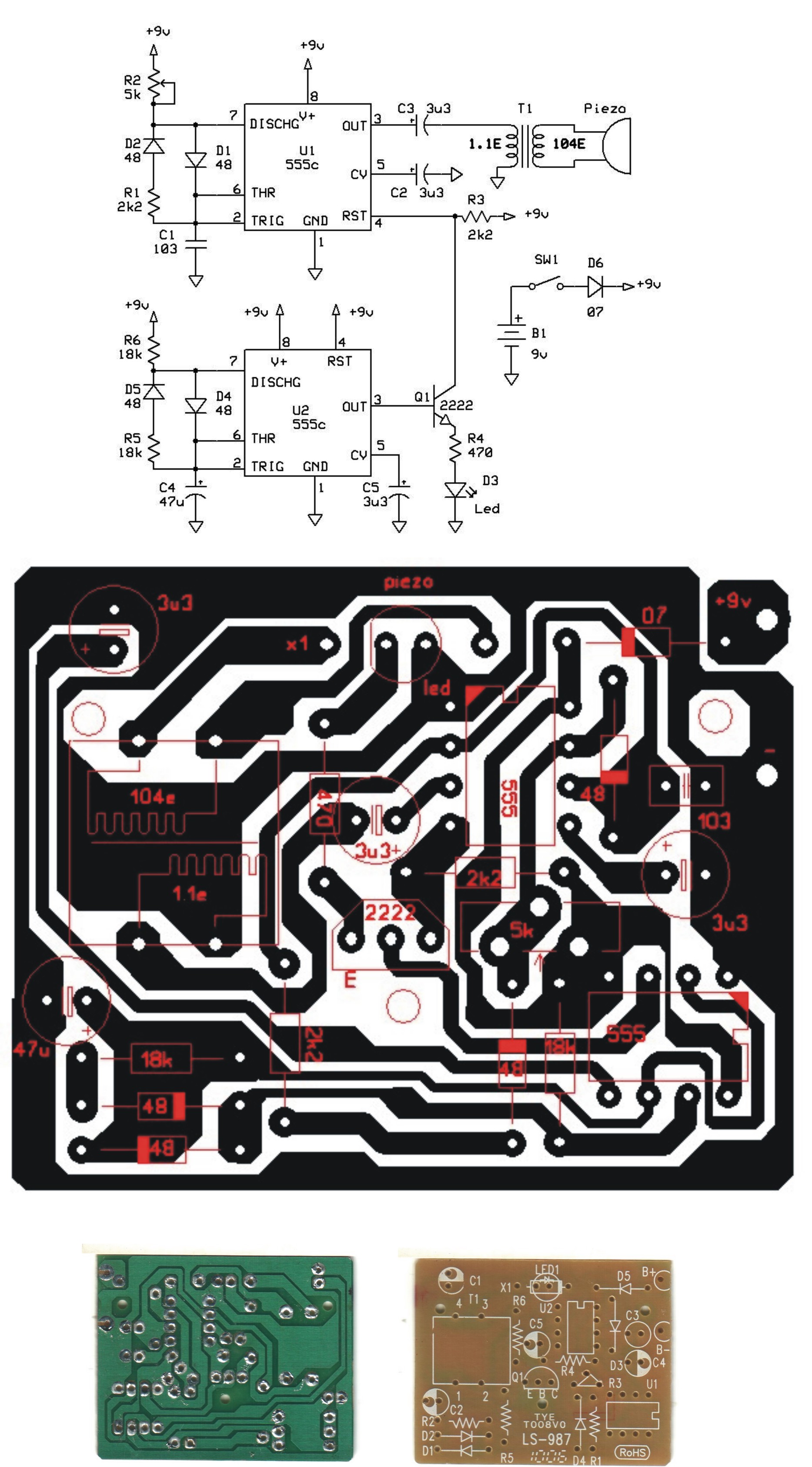

    Here are two schemes that I found online some time ago. I have not tried it and I do not know if it is efficient.
    I made one of those. Not efficient.
    Probably because of the suitable speaker which i didn't have.
    Whole trick at those and similar schematics is in speaker.
    It must be designed for frequencies above 22kHz... up to 40-60kHz.
    Here is one very interesting old schematic. So called "pain field generator".
    Designed for different purpose, but can be adapted and modernized for this purpose.
    I made the pcb, put most of the components. But than i gave up, couldn't obtain proper speaker.
    Also not sure if i made proper transformer.
      And here is the one "original" device from market.
      I bought several different "commercial" devices, NONE efficient at all.
      Than i did reverse ee on this one. Because it is the very standard and basic approach.
      Almost ALL other commercial repellents are based on the same principle.
      They just redesign different enclosures for the same electronics inside.
      Than advertise them under different brands and names.

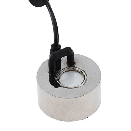

                  That SmartBam machine is interesting. I happen to have experience of ultrasonic fogger electronics. It's likely that this machine uses such tech to evaporate a water-based scent containing animal sweat concentrate. A small fan would help disperse the odour into the area. The CO2 is simply generated from a gas bottle with a control valve.
                  And once attracted, they can be dealt with mechanically, such as the air vaccuum in this Bam device, maybe a high-voltage zapper could be useful too.
                  Foggers:
                  https://www.pondandgardendepot.com/1...er-mist-maker/
