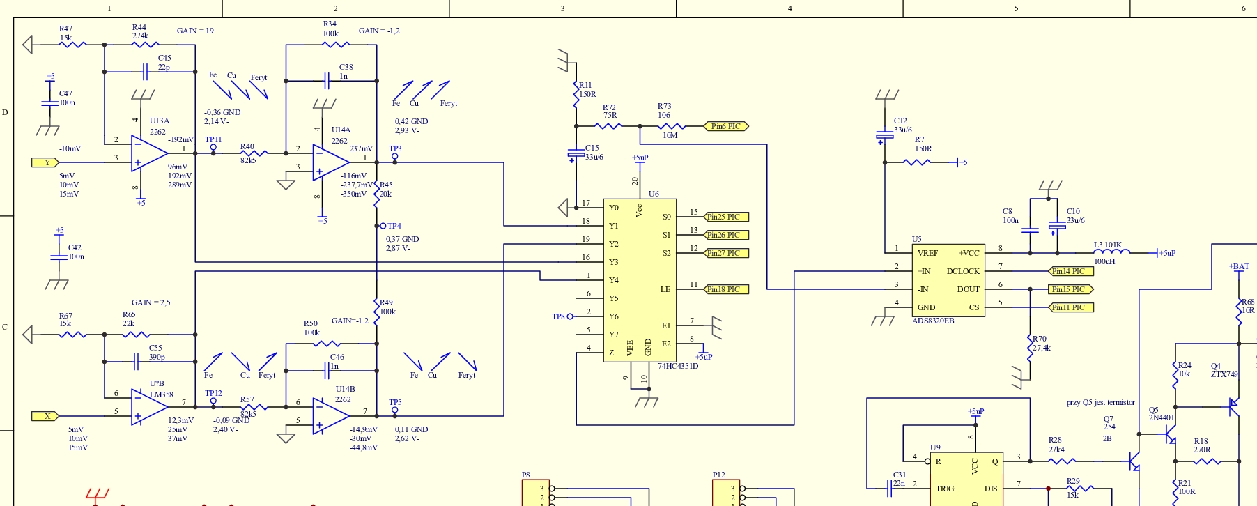

Nokta Simplex copy White's MXT? Why?
  • Nokta Simplex copy White's MXT? Why?
    https://www.youtube.com/watch?v=vjhDP4Rfj2o
    Comparison schematic:
    http://www.taktykpulse.com.pl/2019/0...s-makro-racer/
    Why this way is good...?

          Here is schematic MXT - my schematic, reverse engineering:

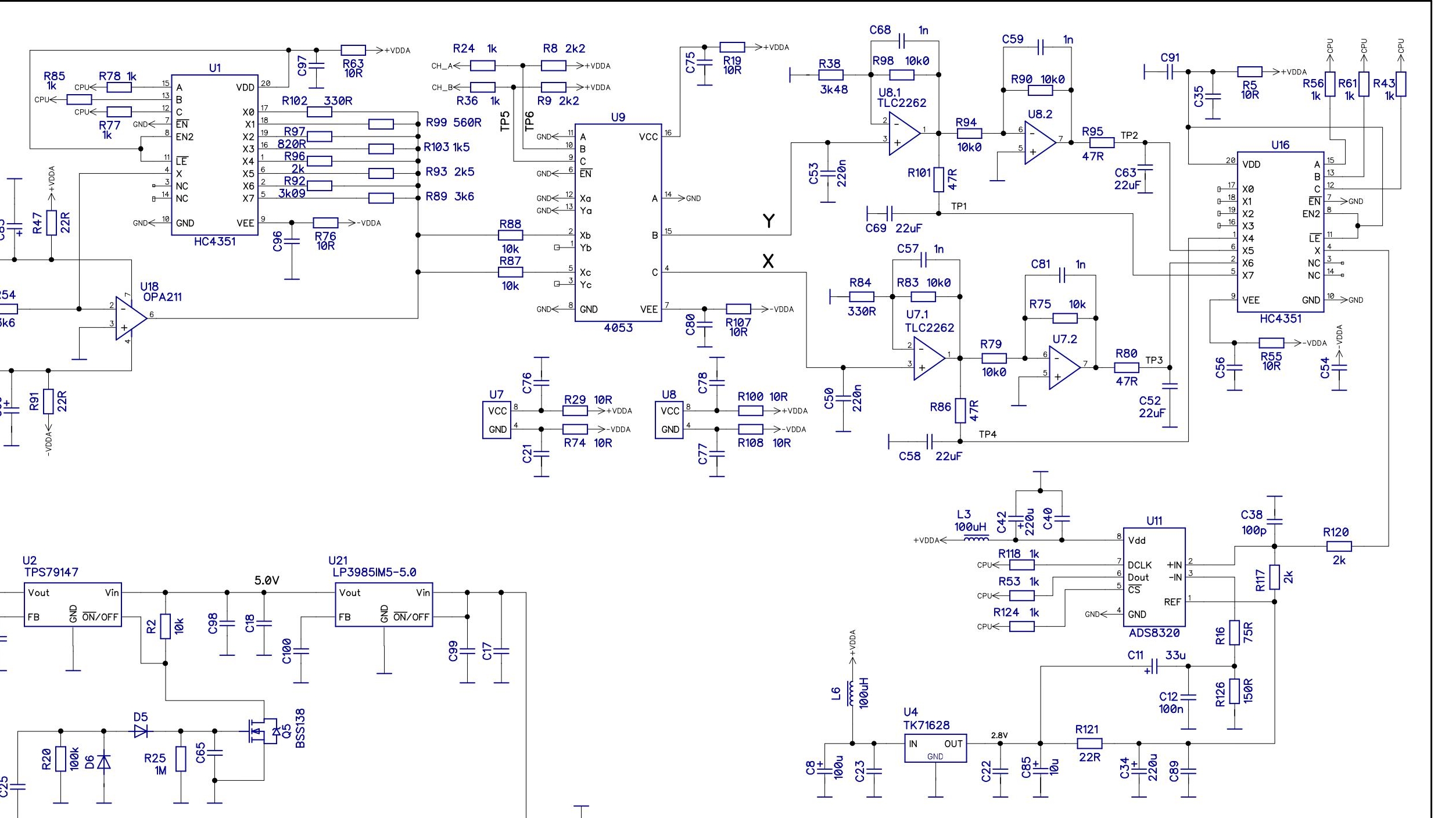

          Now shematic Makro Racer, from this forum:
          Identical chanels structure and junctions, from multiplexer 4053, trough opamp to 4531 (sampling), to ADC converter ADS8320. This is identical.

            You are right.
            But why inventing something new, if it can be stolen with impunity from other creative genuine inventors?
            At the end Rutus (assume well known to you?) muddle the same thing around Whites schematics, solutions and ideas.
              They all steal both whites and blacks MD3030 - Fiser 1235 mxt - macro2

                  These MD-circuits are since 30 years more or less the same - some little improvements
                  here, some a few better improvements there. In other words: There is not much choice
                  as long as you don't focus on some total new EM-field-detection area as GPR etc. does.
