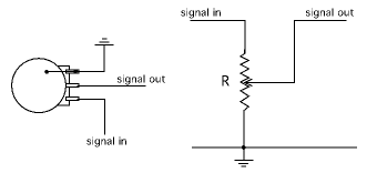

I used a 1K potentiometer for sound control on my IDX PRO.
1 leg is for audio in the middle goes to the Speaker and the 3rd leg goes to Ground. Search in google if you dont get it
