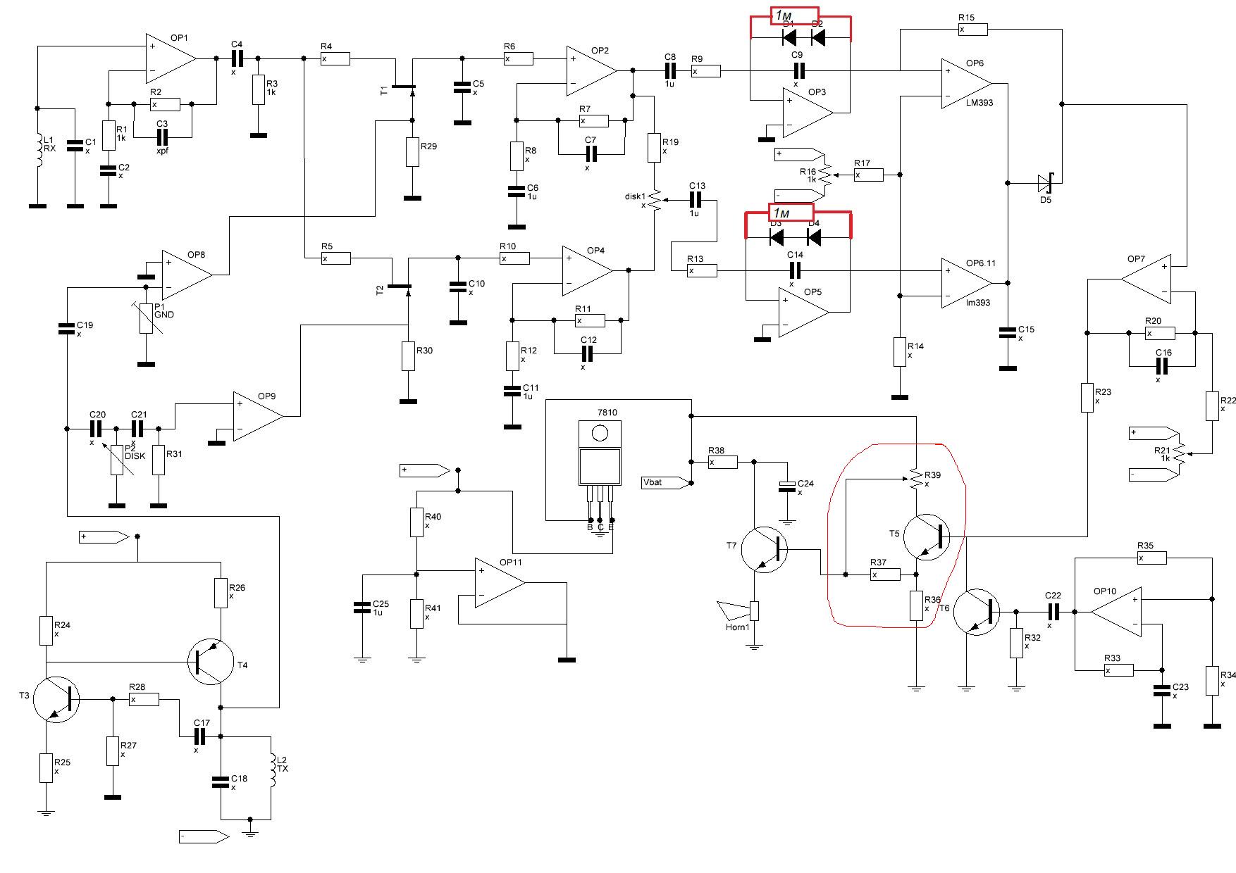

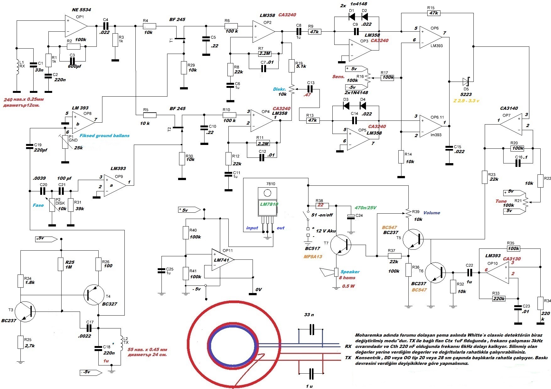

    Does anyone have more info on this device? I can't seem to find it again. I think it is here on the forum. The reason for my interest is I noticed the simplicity of the power supply circuit and the audio oscillator. Overall, the circuit looks pretty straightfoward. It looks to be operating at around 6kHz according to some data on the schem. Coil winding data is included as well.
    I think it's ALL-1.
      The schematics look very different to me.
        Its some older Fisher, perhaps 12xx.
          Originally posted by Nándor View Post
          I think it's ALL-1.
          ALL-1 is based on fisher 553 or 555. this is a hybrid - white classic sch but 4066 were changed on JFETs.
            Detector ''Moharem'' from Bulgaria....
              we had discussed it about. when somebody says its new it is just old forgotten.
                It looks to be very conventional circuit. Probably works as good as any similar circuit. Thanks everyone for your replies.

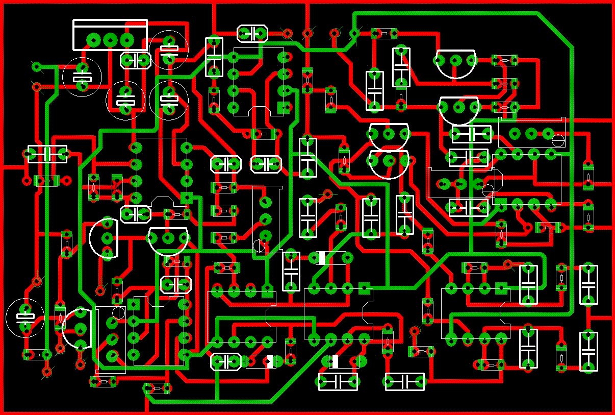

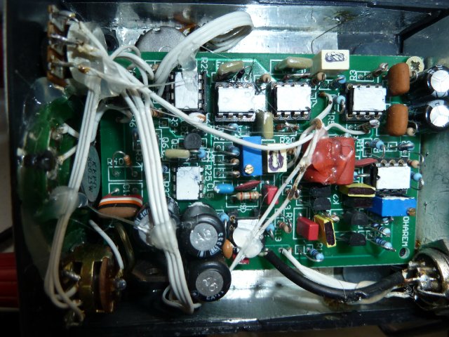

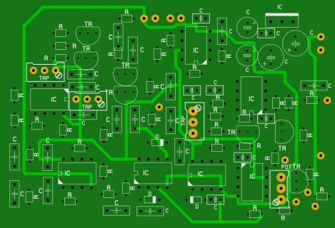

                        moharemka 2005 year https://www.geotech1.com/forums/show...-bulgarian-VLF
                        please do not write in a header NONAME. write BULGARIAN, MOHAREMKA etc. - hard to search at future time.
