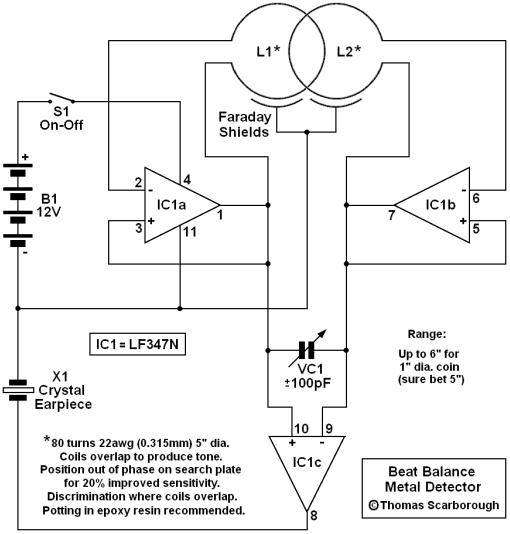

    Friends,
    This concept has met with such popularity (in the last two days I have received e-mails from Poland, USA, Venezuela, England, Denmark, etc.) that I have designed an embodiment especially for the Tech Forum.
    You will see that there are two transmitters in the circuit, each comprising only an inductor (search coil) and an op-amp. The frequencies of the two transmitters are mixed through a third op-amp, and fed to a crystal earpiece (or piezo sounder - but then volume will be reduced).
    On the surface of it, this would seem to represent nothing more than a twinned BFO detector. However, mutual coupling adds the "balance" of IB, and boosts sensitivity way beyond that of BFO. VC1 is used to obtain a suitable beat frequency or heterodyne (say 200-300Hz).
    This is a very simple embodiment of the concept of course, and sensitivity could be boosted significantly beyond that shown with a slightly more complex design. In principle, all that is required is two identical transmitters, a coupling capacitor VC1, and a suitable mixer.
    I have dubbed the concept Beat Balance or BB, thus giving a nod to the two genres which underlie it.
    With kind regards,
    Thomas Scarborough.

    When you say it Descriminate, What does it descriminate against?
    Just magnetic and Non-Magnetic?
    Or Different Metals?

            I read through the Weber patent, and it is similar to Thomas' circuit, in that it uses a balanced coil. However, Weber gates the 2 oscillators, such that only one is on at a time. His only purpose, that I can gather, is to provide "spatial" information, i.e., whether the target is closer to coil 1 or coil 2.
            Thomas' circuit runs both coils simultaneously, and mixes the outputs of the two tanks with one another, instead of a reference signal as with Weber and most all other BFO designs. In a nutshell, Thomas has placed the reference oscillator coil in the search head, along with the main coil.
            Has this been "thought of" before? Possibly. I've "thought of" a number of cool circuit ideas, only to find out that others thought of them long before me. Years ago, I had even considered doing something somewhat similar to Thomas' design, but didn't bother, because I assumed that "pulling" between the two oscillators would lock them together, and kill sensitivity. Maybe I should build Thomas' circuit, and rethink my old idea.
            Unless you pore over all the patents, and have a good knowledge of prior art, it's pretty easy to assume that some circuit idea is new. I wouldn't get too worked up over this, especially when the information is being publically shared, for everyone's benefit. And I do appreciate everyone's contribution.

                Hi Thomas,
                I noticed that you position the coils out of phase. Could you please explain this by illustration. ie if both coils are wound in a clock wise direction and placed on top of one another and then moved to the overlap position. Would the coils remain same or would one be flipped over.
                Stefan
