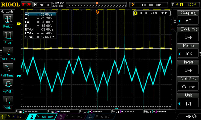

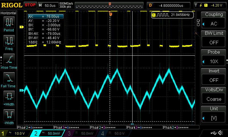

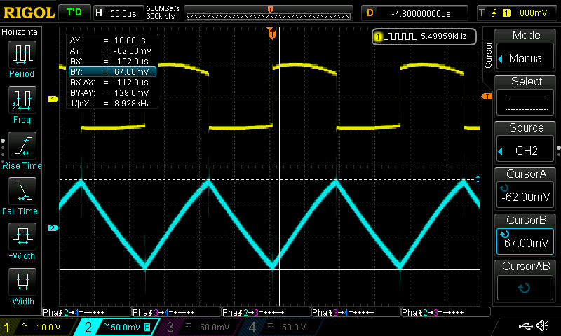

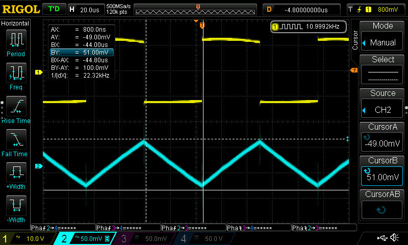

                          This is the current flow in APEX, in MF mode:

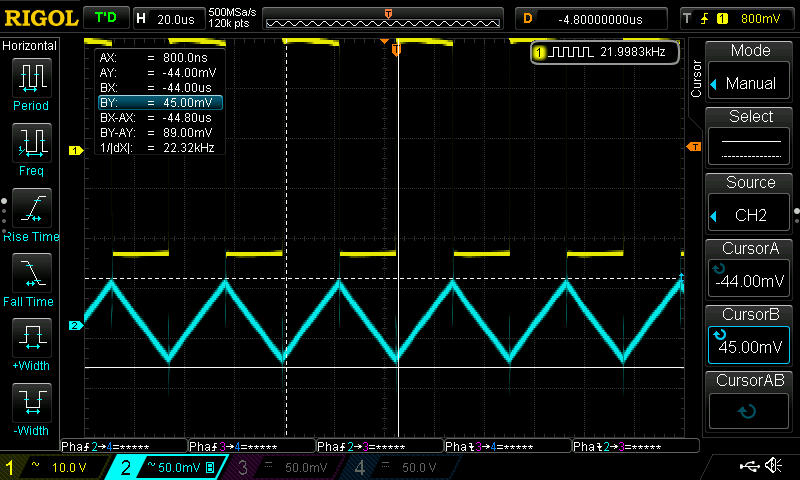

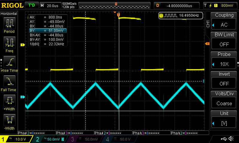

                            For single F= 5, 10, 15, 20kHz amplitude is optimized (1.3-1.0App):

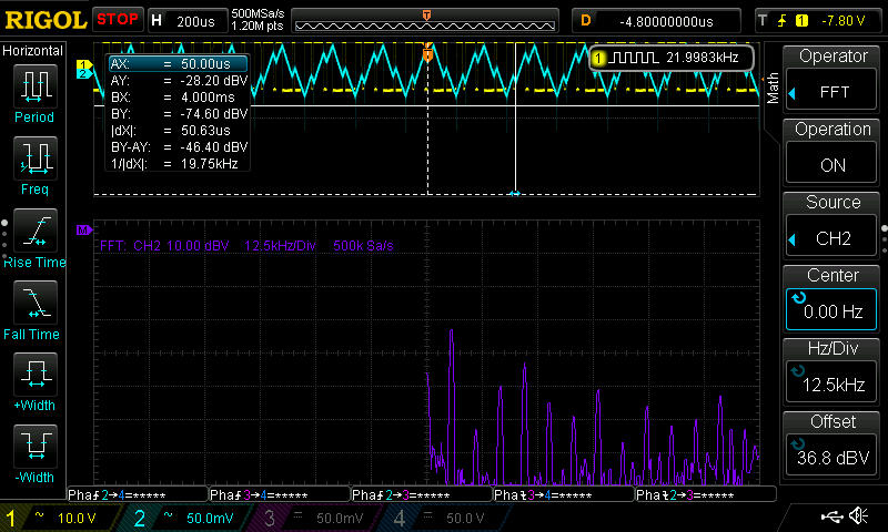

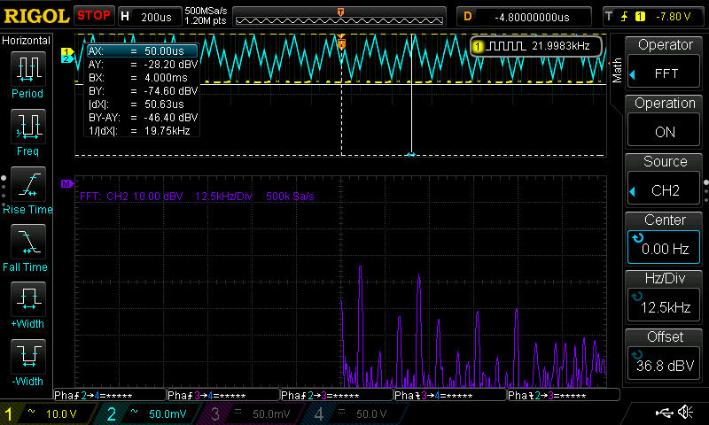

                            MS mode:

                              Analysing the MS mode, it looks like the lowest freq component is 5.5 kHz ( 3 cycles in 545 microsecs ) , and there are definitely 4 cycles of a higher freq for every single cycle of the fundamental, so 4 x 5.5 = 22 kHz.
                              That's all, I reckon, the only other 'strong' signal is just the 3rd harmonic of the 5.5 kHz, which isn't going to be used, and nothing above 22k is relevant.
                              The MF mode looks basically the same, but with a stronger level of 22 kHz.
                              So is MS mode a 5.5k detector with 22k used to suppress ground signal, and MF a 22k detector, with the 5.5k used for ground suppression ?
                                It's hard to say... There is a direct sampling.
