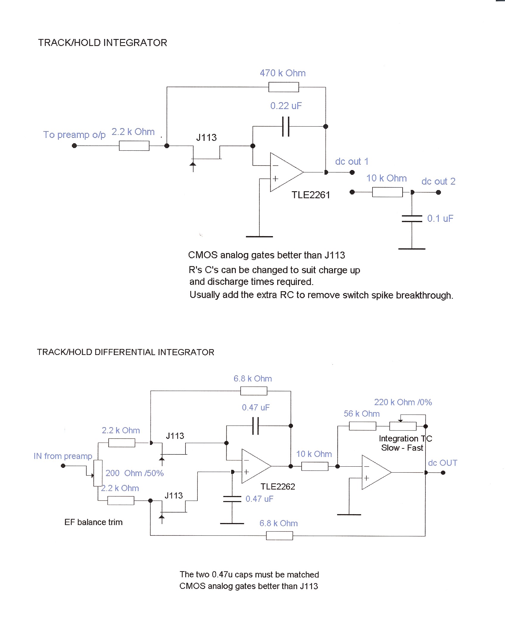

https://www.geotech1.com/forums/atta...4&d=1591477213
I've spent a lot of time trying to understand the track hold differential integrator without much success. Good because it keeps the brain active, one of my reasons for being on the forum.
Think I understand a 1C integrator(output=Rfdbk/Rin*sample time*sample rate*average sample V) TC=(Rfdbk*Cfdbk). Sample rate and sample time effect output signal.
Using spice with constant 1V input with track hold differential integrator, output=1*6800/2200*((Rfdbk/(Rfdbk+10k))second stage. Doesn't appear sample time or rate effect gain with constant input. Wondering how sample time effects signal out when sampling a quarter? Don't know how to calculate TC.

Originally posted by green View Posthttps://www.geotech1.com/forums/atta...4&d=1591477213
