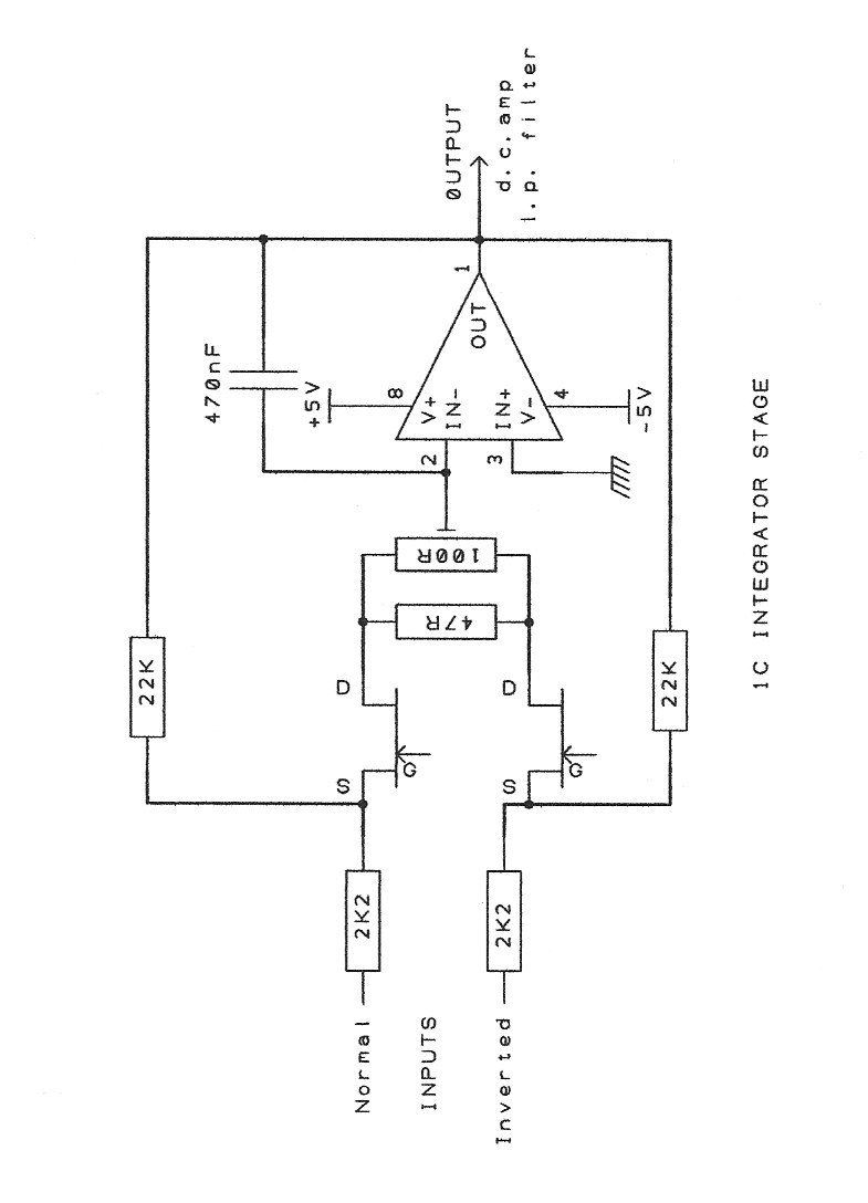

                        This works better than any other integrator I have tried, and simple too for analysis. Suitable jfets are J110, J112 and J113 plus the matched pair NPD5566. Input and feedback resistors can be different to the values shown to suit pulse rate, sample pulse width and response speed required. 1% metal film are recommended. Good quality polyester capacitor, again of a value to suit the application and the IC I use is 1/2 a TLC2262 with the second half as following d.c. amplifier. Being a Cmos device there is no measurable droop during the hold period, and with the balance preset a very precise notch can be set for EF rejection. This is set, not by waving a magnet, but by injecting a low frequency sine wave (2 - 5 Hz) into the first preamp stage to give an excursion of between 300 and 500mV on either of the preamp outputs (normal or inverted). The output of the integrator can then be viewed on a scope to see the ramp up, the hold period, and then the ramp down to the base level. The preset is adjusted until there is almost no movement in the base level. the setting is quite critical with the 100ohm preset, hence the parallel 47ohm resistor which widens out the adjustment point somewhat. The J110 and J112 have lower 'on' resistances than the J113 and maybe with other types of gate (Cmos) , particularly if matched, the preset can be eliminated.
                        Eric
                        • #57
                          [ATTACH]50574[/ATTACH]
                          Eric

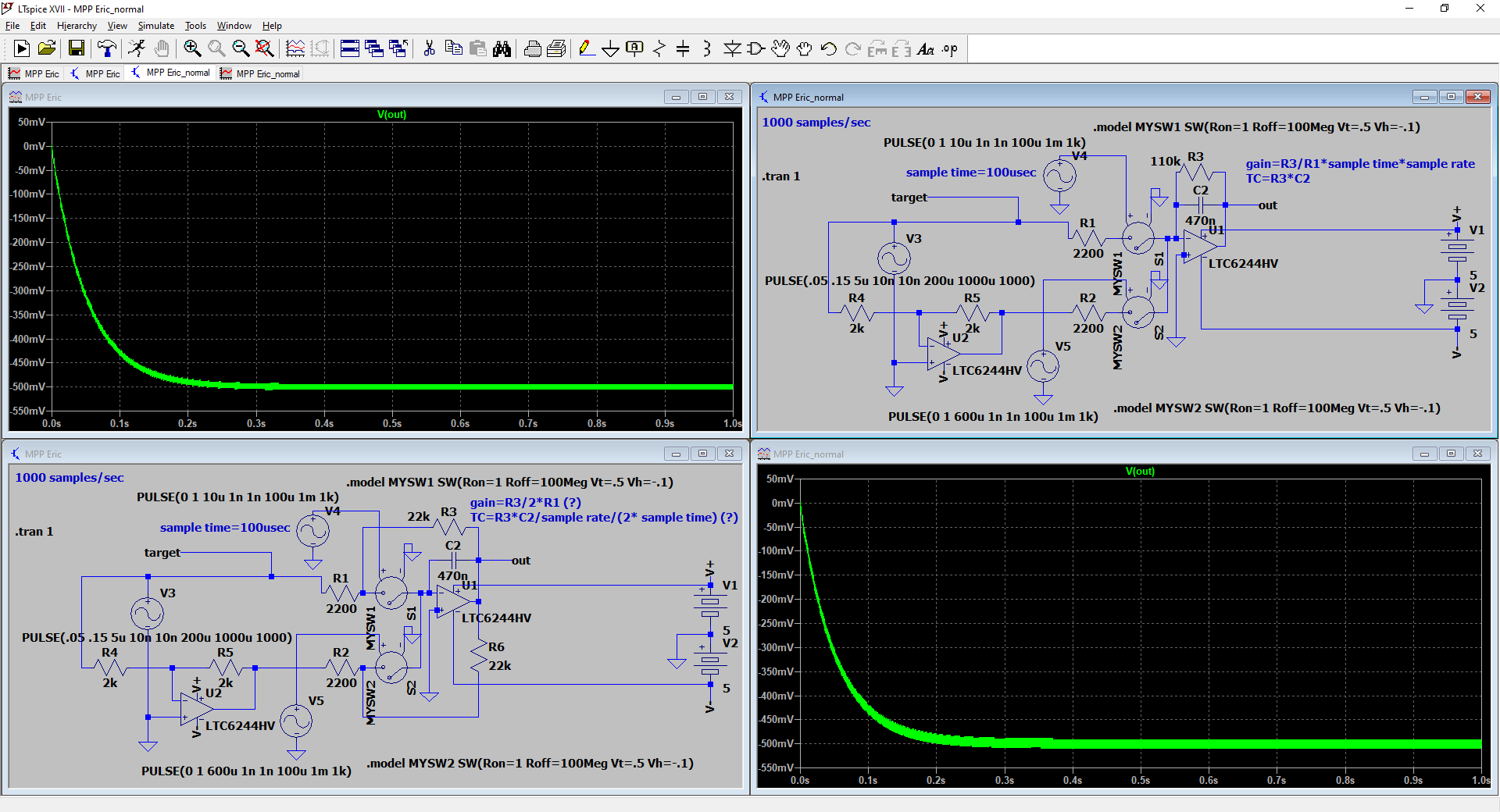

                          What is the gain formula? What is the time constant formula? Tried in spice and not sure I did it correct.
                          • #58
                            Played with spice some more. The formulas work for the simulation values, not sure correct for any values. Should have ( ) around 2*R1 for gain left simulation.
                            • #59
                              Thanks Eric.
                              • #60
                                That's very similar to a bipolar design I did a while back. Based on your original zero-droop demod, I added the negative sampler and extra feedback R. I did not use a trimmer and used 4066-type switches instead of JFETs. I agree, it works very nicely.
