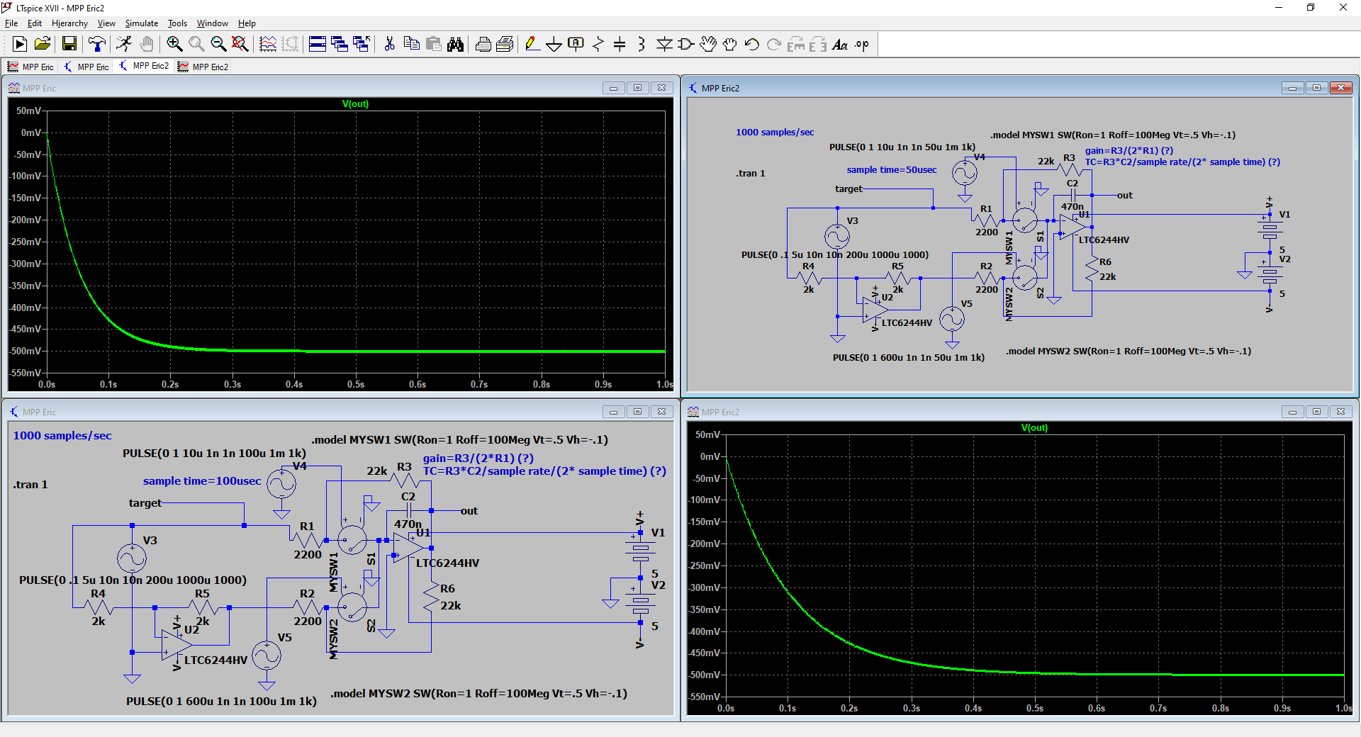

                    This works better than any other integrator I have tried, and simple too for analysis. from reply #56
                    Analysis isn't simple for me, reason I tried a spice simulation. Another try with your integrator, sample time=50us and 100us. Still get .5V out for .1V in(gain=5). Integrator TC for 50us sample =.1034s. Integrator TC for 100us sample =.0517s. What do you mean by modulated? What is the formula for TC including sample rate and sample time? Reason for trying to understand your integrator. I have to make a Tx circuit with integrator to test the large coils I'm making to try to detect a quarter at 24 inches. Think I understand the formulas for a normal 1C integrator. Just wondering what the formulas are for gain and TC with yours if I try your integrator.
                    Including the simulation. Maybe someone can try to see what I'm missing.

                      Don't worry; I have never mastered Spice so can't help much in ths area. I have a simulation package of sorts called Electronics Workbench which was useful in some design areas including filters, but the computer that has it installed has failed and I have mislaid the CD Rom. I'm sure someone versed in Spice will come and help. I can then learn too. All I can say for sure is that with the board I am working on, this 1C integrator works extremely well and seems to filter out noise much better than I have used before. The system runs very quiet in spite of the noise generated by my LED lights. In contrast a Vallon VMH3CS is spitting all over the place.
                      Eric.
                      • #71
                        Turned the lower switch off in my simulation. Gain=10, TC=Rfdbk*Cfdbk/%time on. Maybe the formulas for both switches on are correct?
                        • #72
                          Isn't the % modulation based on the sum of the two sample widths divided by the period?
                          • #73
                            I think you are correct for Eric's 1C. For a normal 1C it's just one sample width.
                            • #74
                              Yes, but remember they are separated by a 'hold'. There is never a situation where they are both on together. The circuit could be redrawn with just one sampling gate fed by one 2K2 resistor, which in turn is connected to a 1 pole Cmos changeover switch that toggles between the normal and inverted channels. Gain is always 10 with the values I used.
                              Eric.
