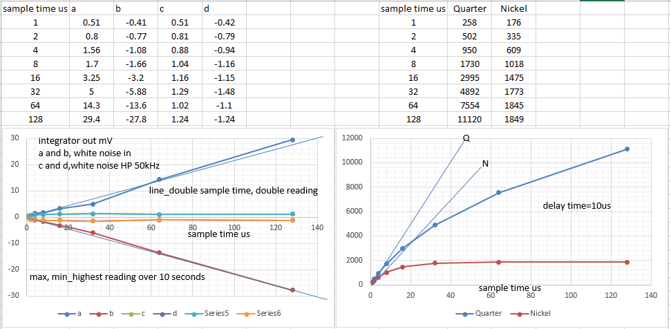

                    • Been playing with spice and Excel. I remember measuring integrator out noise with a 10us and 100us sample with my bench circuit. 100us sample has 10 times the gain but about 3 times the amplitude increase. Longer sample helped reduce the noise. Tried integrating white noise with spice, noise didn't decrease with longer samples. HP filtered white noise at 50kHz and tried again, longer samples did reduce the noise. Guessing the coil was picking up higher frequency noise with the bench circuit.
