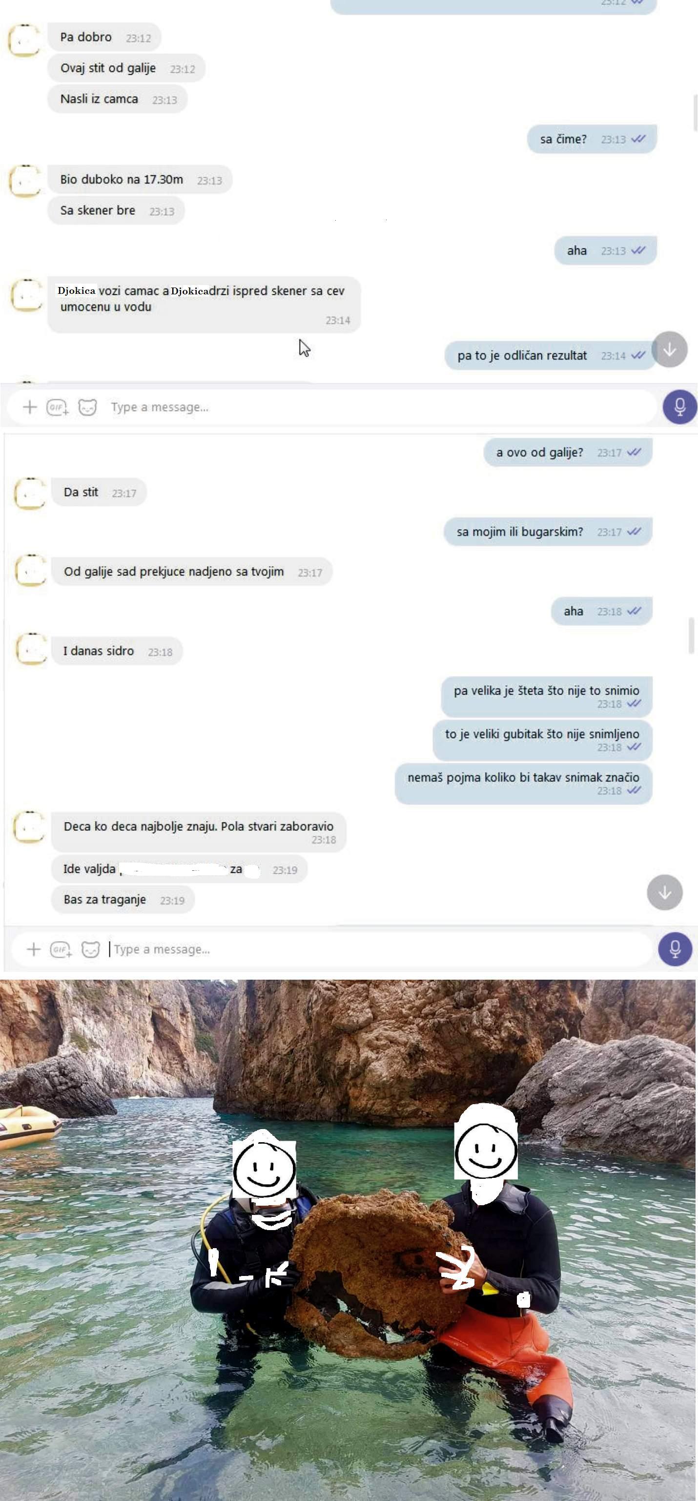

                33 years in this and still not able to digest people who tend to ask questions on metal detector like: "How deep it is?"
                But this time i see something even more meaningless, total hit and win among all cases i saw so far: "I want deeper detector ... but i don't know how deep and i don't know the targets..." !????
                Ok lets pretend that we run serious conversation.
                Loola is this deep enough for you:
                (17,5 meters in water, 45kg weight, ain't no PI to reach not even 1/2 of this depth)
