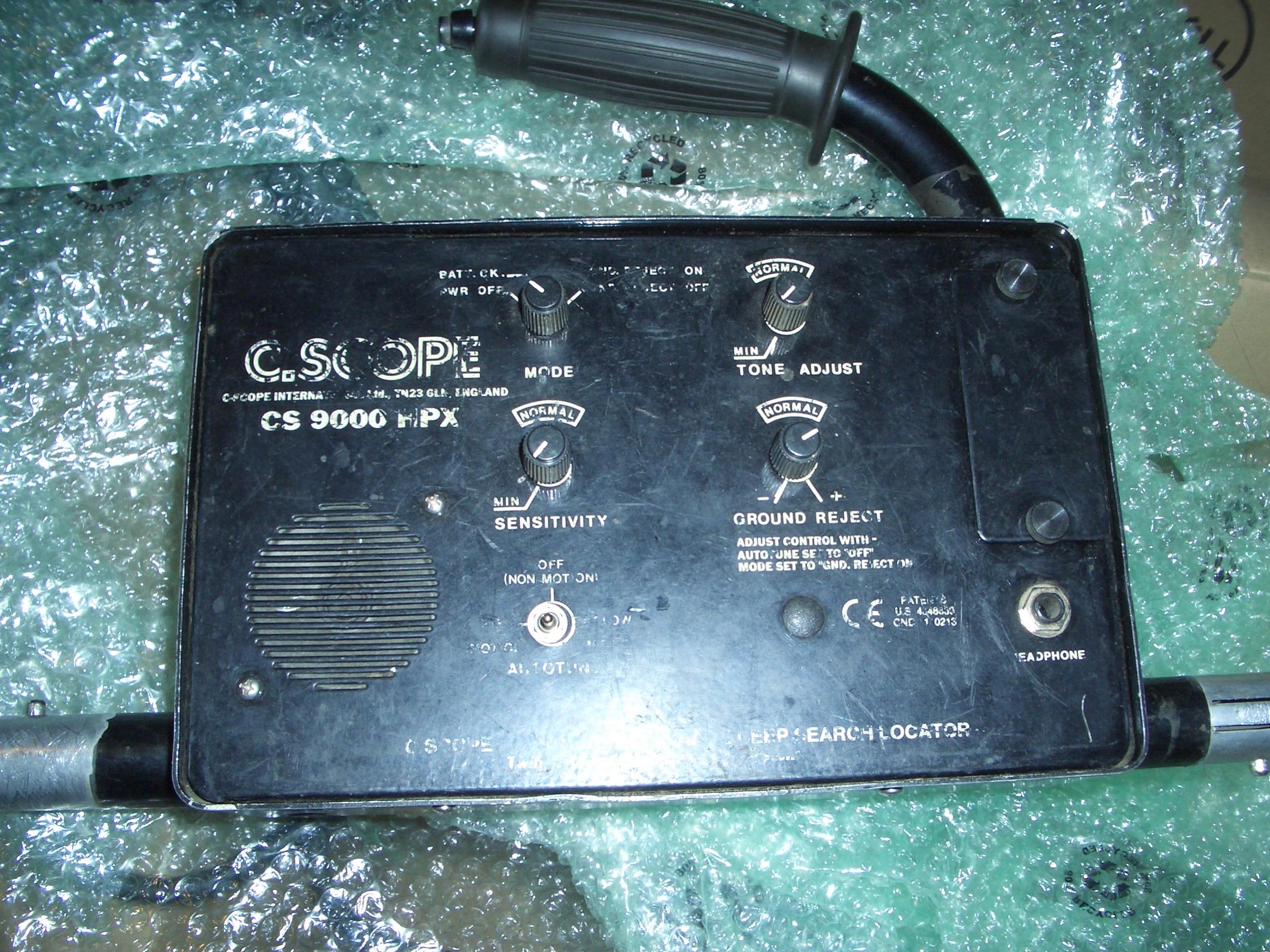

    good day people
    good boy deeper in repair these days...
    with first asking to you the service manual shared.

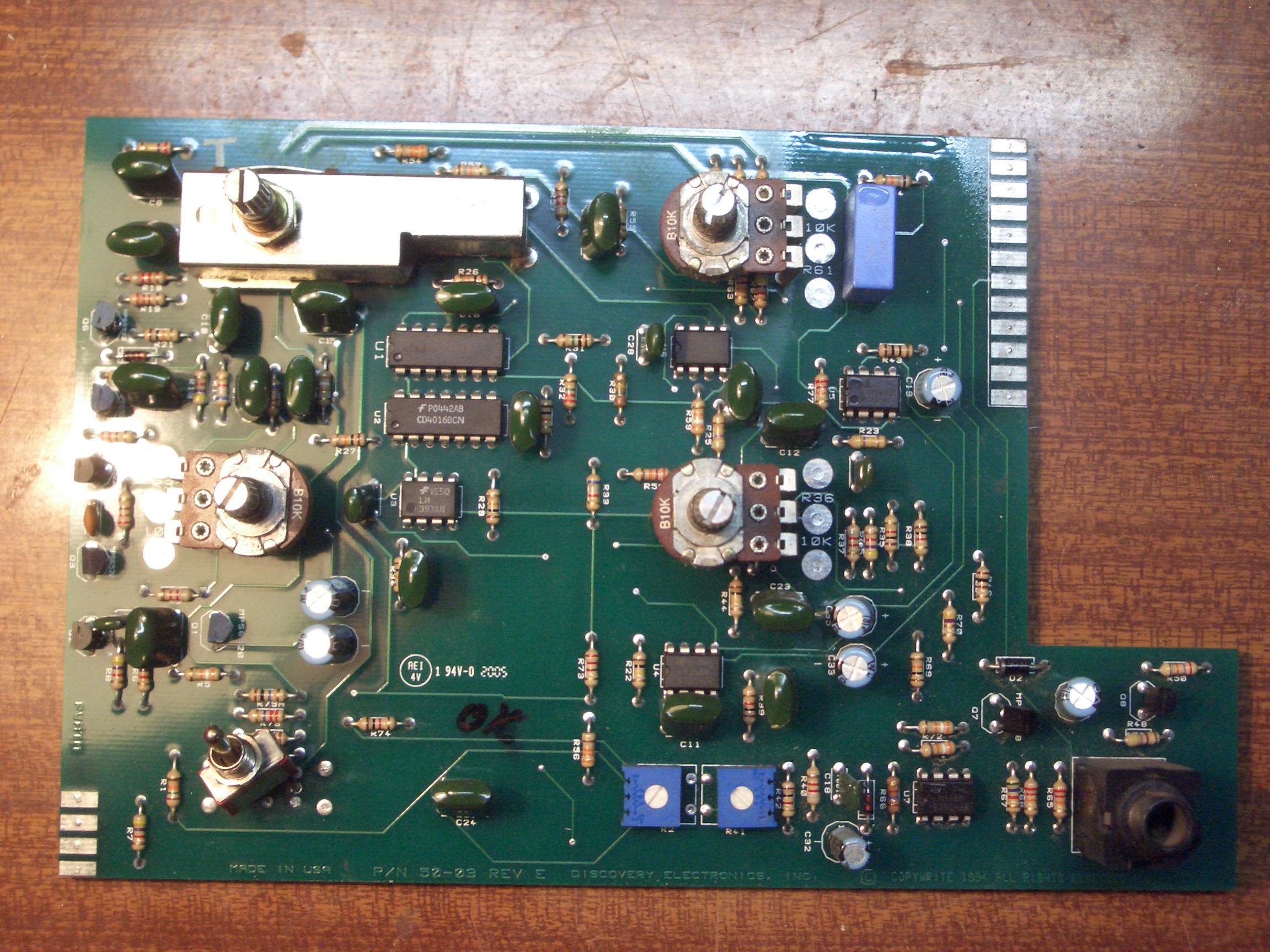

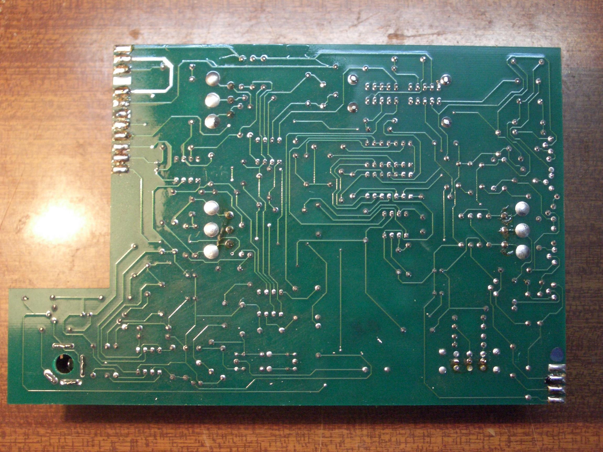

          pcb pics

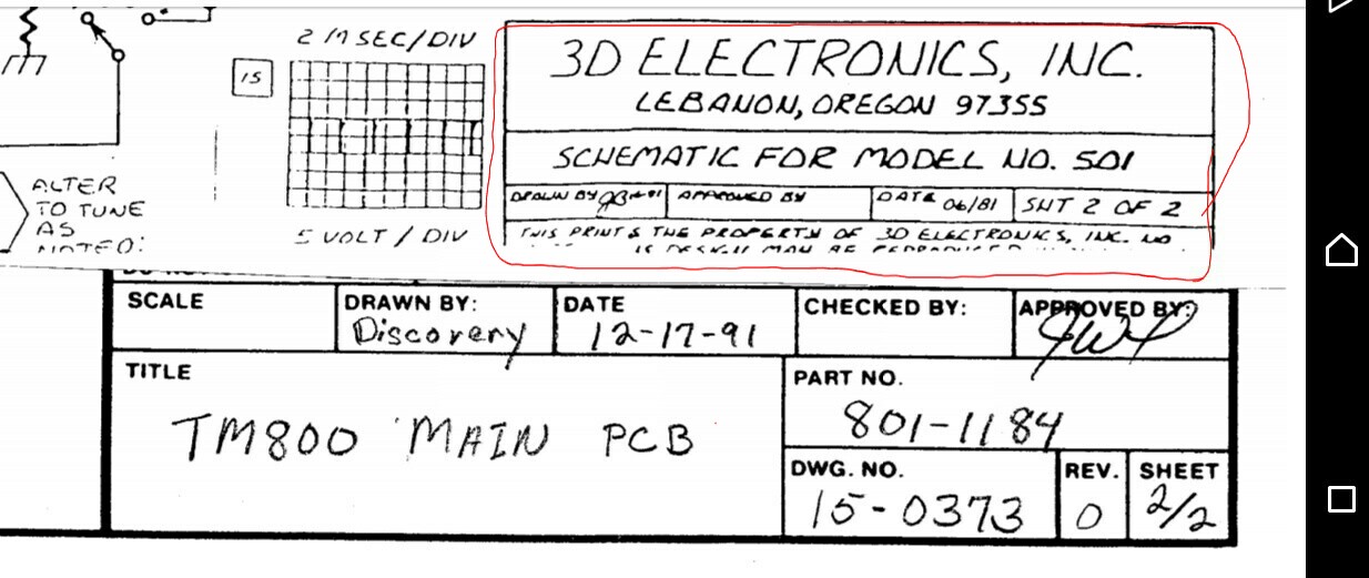

            The Discovery TF-900 was originally built for Whites as TF-800 model. They had some kind of parting, and Discovery quit building the TM-800 for Whites, and Whites then came out with their own TM-808 model. So if you find a schematic for the TM-800 model, it should be identical to the TF-900 Discovery model.
            Melbeta
              thank you Melbeta for the connection. yes, we have TM800 sch and it is very same
              as i see. this is Rev E board and thinking it is last done before a closure.

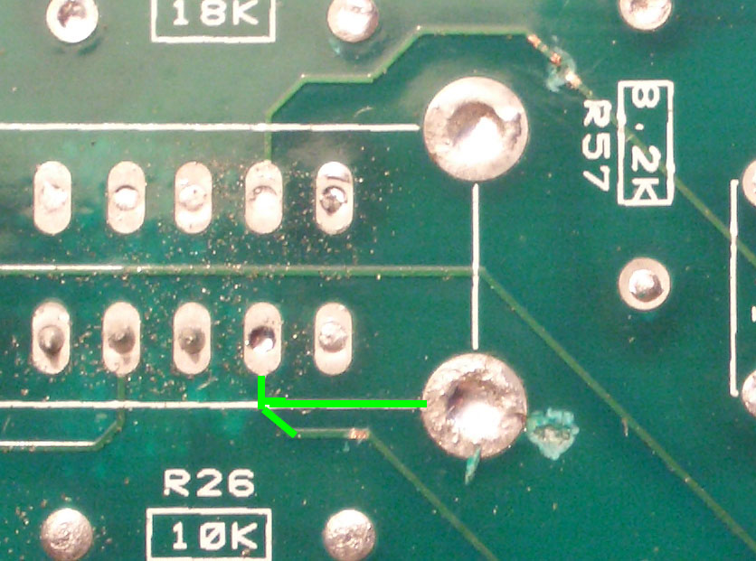

                          invisible track
                            check a BOM
                              invisible track
