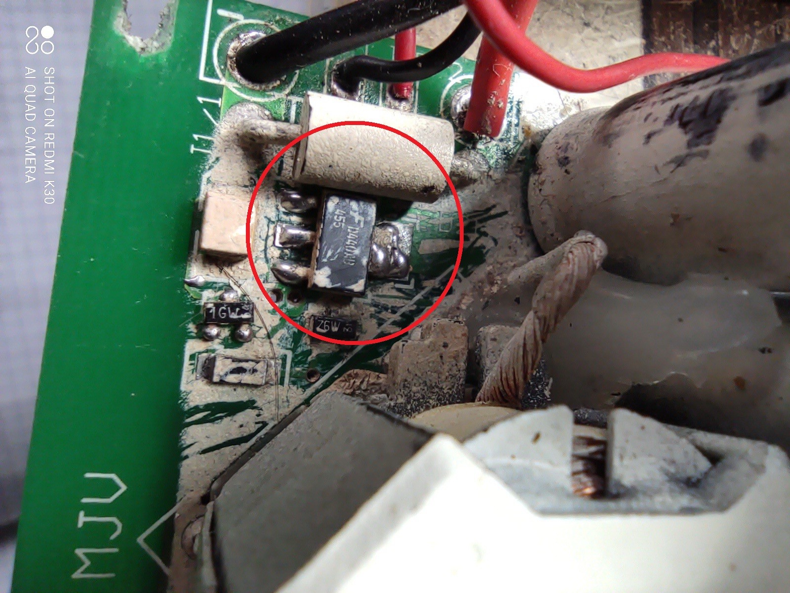

    Hi friend. I have gp3500. Gp3500 2xAd797 and w34nb20 mosfet very hot. Before Ad797 and w34nb20 gate signal ok. Very hot after not signal. Why very hot. Can you help me.
    https://resimyukle.link/i/rAIvz
    Is this a stock 3500 or “modified”…….I am aware of one or two modified 3500’s that ran too hot after someone thought they knew more than the combined knowledge of several Minelab engineers.
      hello minelab gp 3500 transistor in the picture is overheating. When I measured it, I saw that it was broken. It says 455 on this transistor, I couldn't find it on the internet. 455 is what smd code. Can you help with this. Click image for larger version

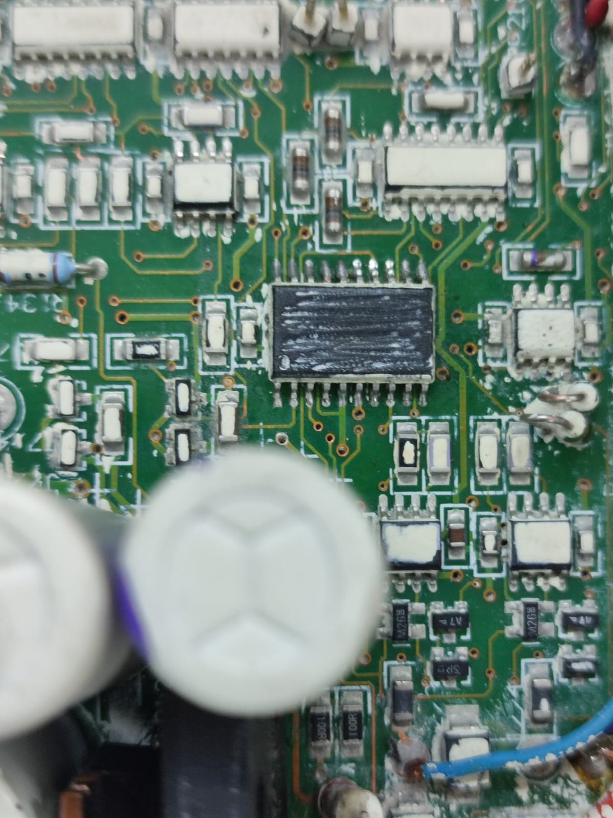

          Hi, would anyone know how integrated it is!โ€‹
            I have a GP Extreme which should be similar to the other series. How do you guys clean the white paint so good?
              That is a power switch
                Fairchild NDT455N NMOS. Anything with similar specs will work.

                  It should be left in cellulosic thinner for a few days.
                    thank you very much
                      Ho utilizzato sverniciatore per carrozzeria e poi diluente, qualcuno potrebbe aiutarmi a capire cos'รจ il circuito integrato a 20 pin, grazie in anticipo
                        Easy, detectormods has shown most of the ICs. That one there is ADG333
                          thank you very much in advance, yes it overheated and burned
                            If you don't fix what's causing the burn even if you replace it may will burn again. You may want to watch the full video before attempting to fix just to be safe.
