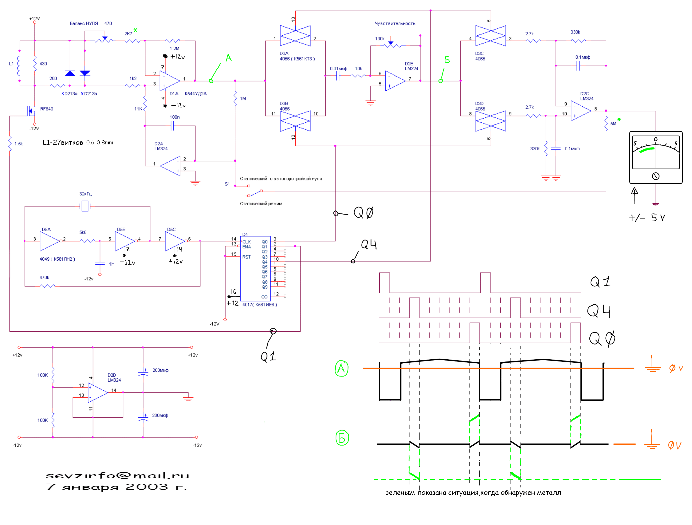

    Hi KT315.I download from your webpage the betapi.zip.The fonts of MYPI.txt are unknown so i cant translate it to english.Can you explain me what about write in this file?

      Hi Gene.L. I want to read what it say for sensitivity ,IC's and for S1. Maybe KT315 can answere us.

        hi Geo.
        the sensitivity is enough good, as impulse data is taken in sensitivity range maximum.
        the sens in autotune mode is slightly less, but no need of manual retune.
        I hope Ivan ([email protected]) will give more details... know he has built the part to a completed construction...

              Hello, This was my post from 2004 !!! see the red x , red x was image , it was lost by "accident" when Carl did V-bulletin change over . There was 2 schematics from Russia called beta-P.I . One was a big Black and white [looked like film negative]was full of many I.C. chips and the other which I think you are looking for was From sevzirfo or KT315 , was BETA P.I. , and it was color ink lines blue /red , it had a analog meter . I think I still have that schematic on a cd disc . I will look today , KT315 might be faster than me and post it sooner . But I think I know exactly which schematic you want !!!!! ................Regards...............Eugene

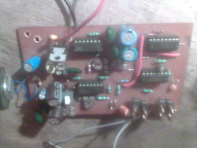

                Hello Atul Asthana , Here is the Beta P.I. Schematic and the sprint .Lay file . I guess it is a working and successfull Transmit/Recieve "TWO BOX"........This is all from a Russian public Web-Site . I think it is complete and I included some nice .GIF images of the circuit board.............Regards............Eugene52

                  The zip files I just posted are T/R circuits , it is not a Good Metal Detector for all areas , it works Bad in Highly Mineralized soil . The Sevzirfo circuit will need a lot of work to be A Great Machine !!!
                  Sorry for the error , but Here is the correct BETA-P.I. Schematic you were looking for :

                      I want to understand the working of the PI/Rx part esp the sampling.
                      And the discrimination.
                      And the effect of various pots.
                      Also, possibly, if I reduce the pulse frequency to 512 Hz for reducing power (keeping the pulse width 30.5 micro sec), how do I need to adjust the integration capacitors?
