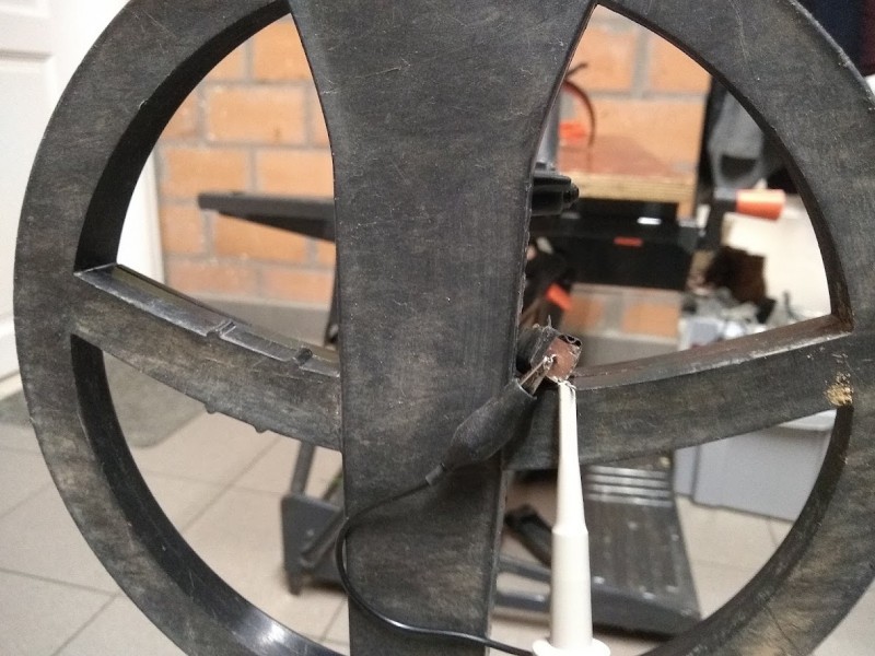

      • I measured the magnetic field of all 12 factory programs of my Deus2 using a small pickup coil placed in the TX coil.
        The TX coil is the left half when looking down on it.
        A lot of noise from a nearby wifi access point and the backlight of my oscilloscope was also picked up for free.

        Seeing this, 2 questions pop up with me:
        1/ A lot of these magnetic field signatures are identical.
        So, the difference needs to be found in the signal processing / software handling ?
        2/ Nothing to do with the Deus, but general for all IB detectors:
        The TX coil is at the left side here, looking down on it.
        So when you swing it from right to left , the TX coil is over the target first and next the RX coil.
        When swinging from left to right: the RX coil is over the target first and then the TX coil.
        For a DD setup anyway.
        Does this make a difference ?

            What is needed is a flat Tx frequency bandwidth. Distortions are removed by filters. The difference is in the received signal.

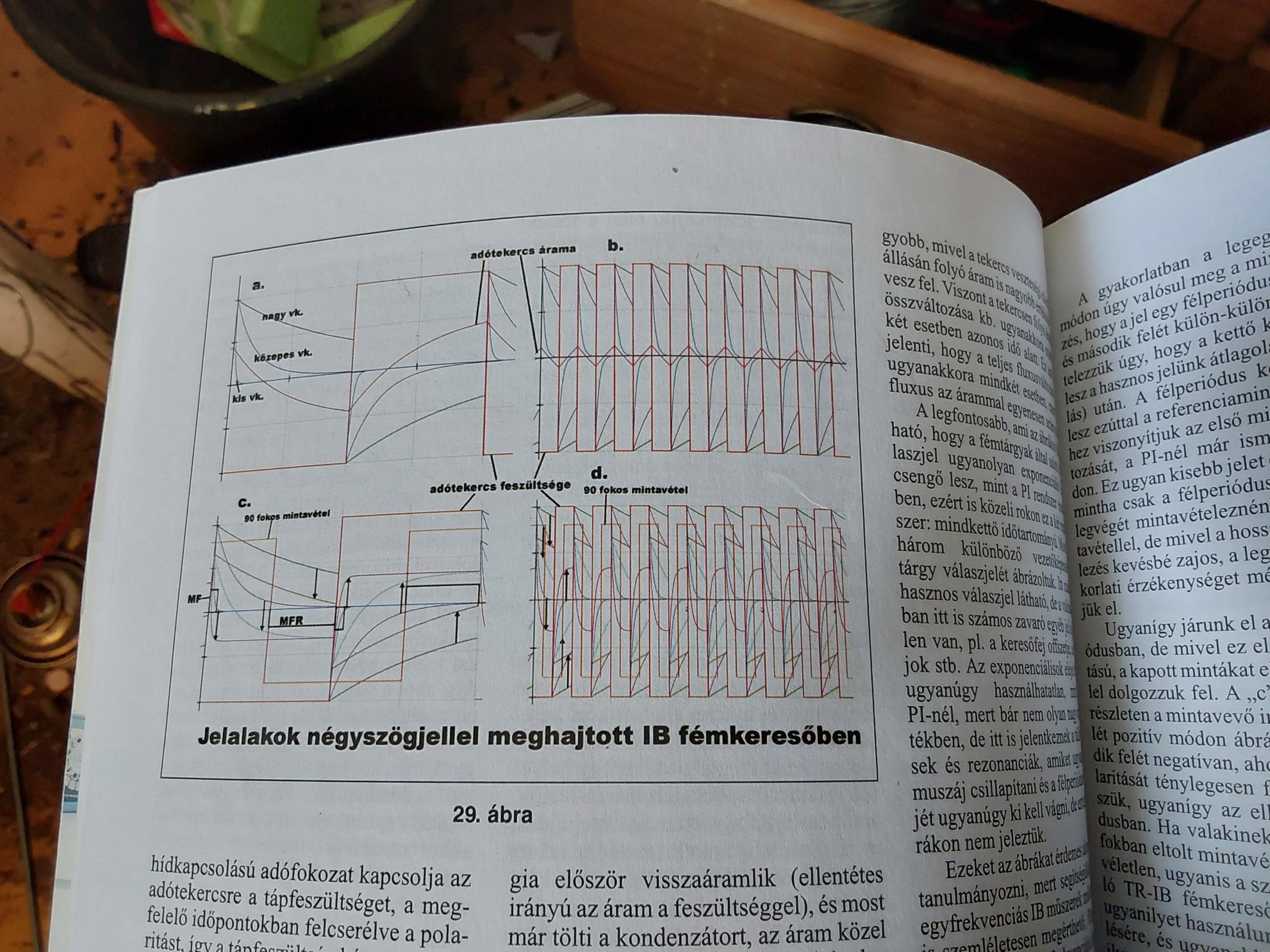

                • I wrote an article how this works in detail. It was printed in "Rádiótechnika Évkönyve 2015".
