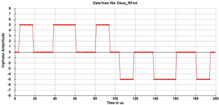

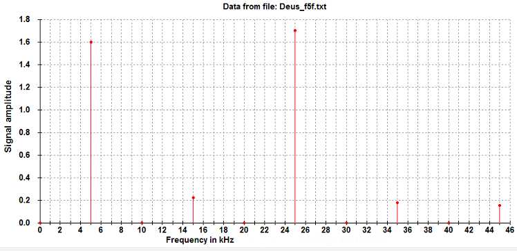

      • #78
        Here's a three-level waveform that's intended to mimic: y = sin(wt) + sin(5wt)
        that has similar fundamental and 5th harmonic amplitude, with minimal 3rd, 7th etc harmonics.
        In this example I chose 5kHz / 25kHz to illustrate it, but it's not important, it applies equally to 3kHz/15kHz or 8kHz/40kHz as you want.
        Attached are the waveform, with 160 steps per cycle. This is a multiple of 20, meaning that precise I & Q demod signals for both fundamental and 5th harmonic can be created along with the TX.
        And the spectrum analysis, showing 5th harmonic levels 6% greater than fundamental level. The actual levels are shown half what they should be (shrug), they are actually 3.2 V and 3.4 V for the +5V/-5V waveform.
        So the TX mimics: V = 3.2 sin (wt) + 3.4 sin (5wt)
