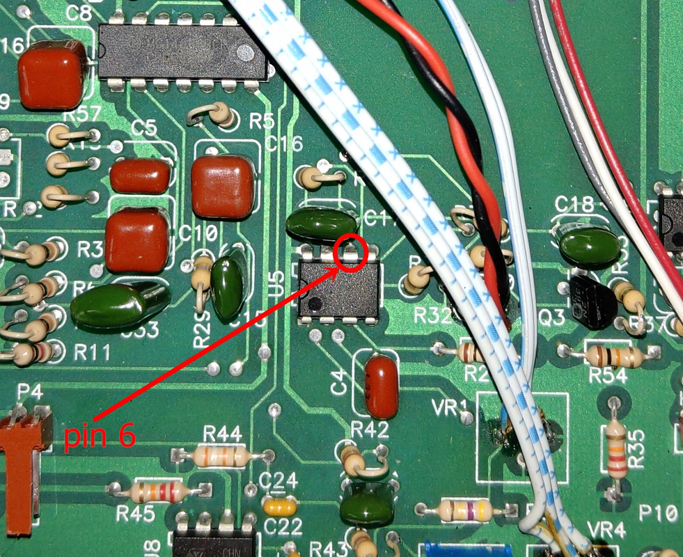

    Pot voltage looks OK. Next I would measure the output voltage of U5b vs threshold setting. Do this with the coil disconnected. This should not be difficult to track down.
      connect 6 pin of U5 on GND (lower pin of R32, C18 etc). disconnect C16. measure voltage on 7 pin U5 and write the value
      and do you hear a sound or not, in ALL METAL mode.

        is this pin 6 i assume that is what you mean. you said U5b for U56 ?

          U5b is a part of U5. there are U5a and U5b just it is dual opamp.

            i got 0.23 that's if i was doing it right.

                Output of U5b is pin 7. You want to measure it at min threshold and max threshold.

                  i get 2.69 Min and 2.76 Max
                    Both way too high. Again, with the coil disconnected, measure the input to U5b (on pin 5). Also pin 6 at min/max threshold.
                            I get 0.02 on Min and 0.02 on Max

                                Is that pin 5 or pin 6? Need both.
