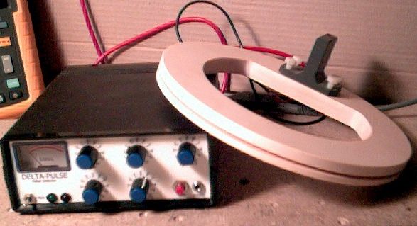

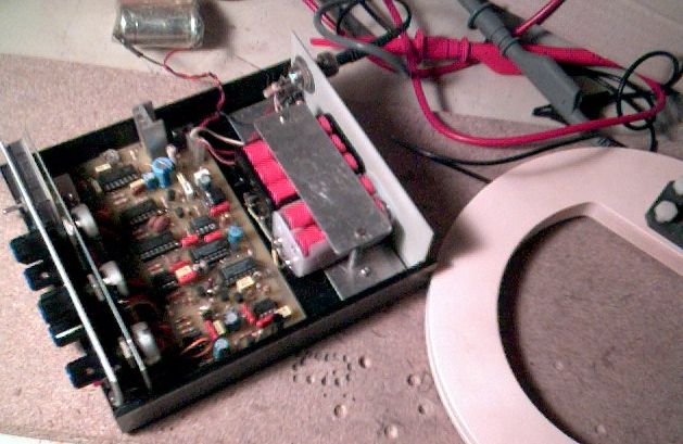

    Hi
    The construction of Delta-Pulse doesn't put any probléme.
    Concerning R39 and R40 to respect values of the diagram. The XR71 is different on this point and the T8 transistor is a PNP.
    Concerning R1 and PR1 authorizes the adjustment of the frequency of the pulse. Delta - Pulse works to 100Hz and the XR71 over of 300Hz. my delta-pulse operates to 400Hz.
    I replaced R1 by a 120k.
    The frequency is given by the constant of time (R1+PR1)*C1.
    If you don't have of oscillo to respect R1 to 680K and replaced PR1 by a strap.
    The frequency of beating is not critical if one doesn't pass certain value.
    Attention on the printed circuit it is necessary to add a strap between the paw 2 and 6 of the IC8.
    Sorry for my english.
    Jean-Charles

      Good & professional look! Great assembling job. Can you post the PCB layout into the forum?
      Chris
        Re: Delta pulse
        Thank you very much.
          Re: Delta pulse
          Hi JC. Did you draw the pcb with Protel?
          Geo

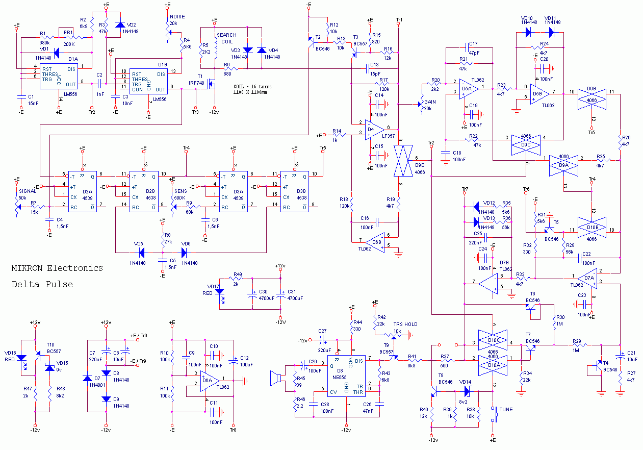

            Where could I find a schematic for the Delta Pulse? n/t
            n/t
              Re: Where could I find a schematic for the Delta Pulse? n/t
              here is a schematics, also i have XR 71 schematics if you need

                nice job, and your PCB is perfect, i used older version of PCB and there was an error with vd12 and vd 13, this is why sensivity was so low, after i fixed it sensitivity is growed up and now i need to shield everythnk because it feels everythink around

                      Thanks...The schematic is as nice as the PCB layout pix...awesome!!! n/t

                            Hi.
                            The drawing has been made with WINTYPON.
                            Now I work with EAGLE.
                            For the sensitivity :
                            coke: 70cm
                            coin of 5F silver: 30cm
                            gold ring: 20cm
                            For the coil :
                            30 turns of 0,35mm enameled wire on 200mm
                            I replaced
                            R1(680k) by a 120k.
                            R7(15k) by a 10k.
                            R5(2k2) by a 1k
                            R6(680Ohm) by a 1k.
                            IRF740 by an IRF840.
                            It is a good and funny PI
                            Jean-Charles
