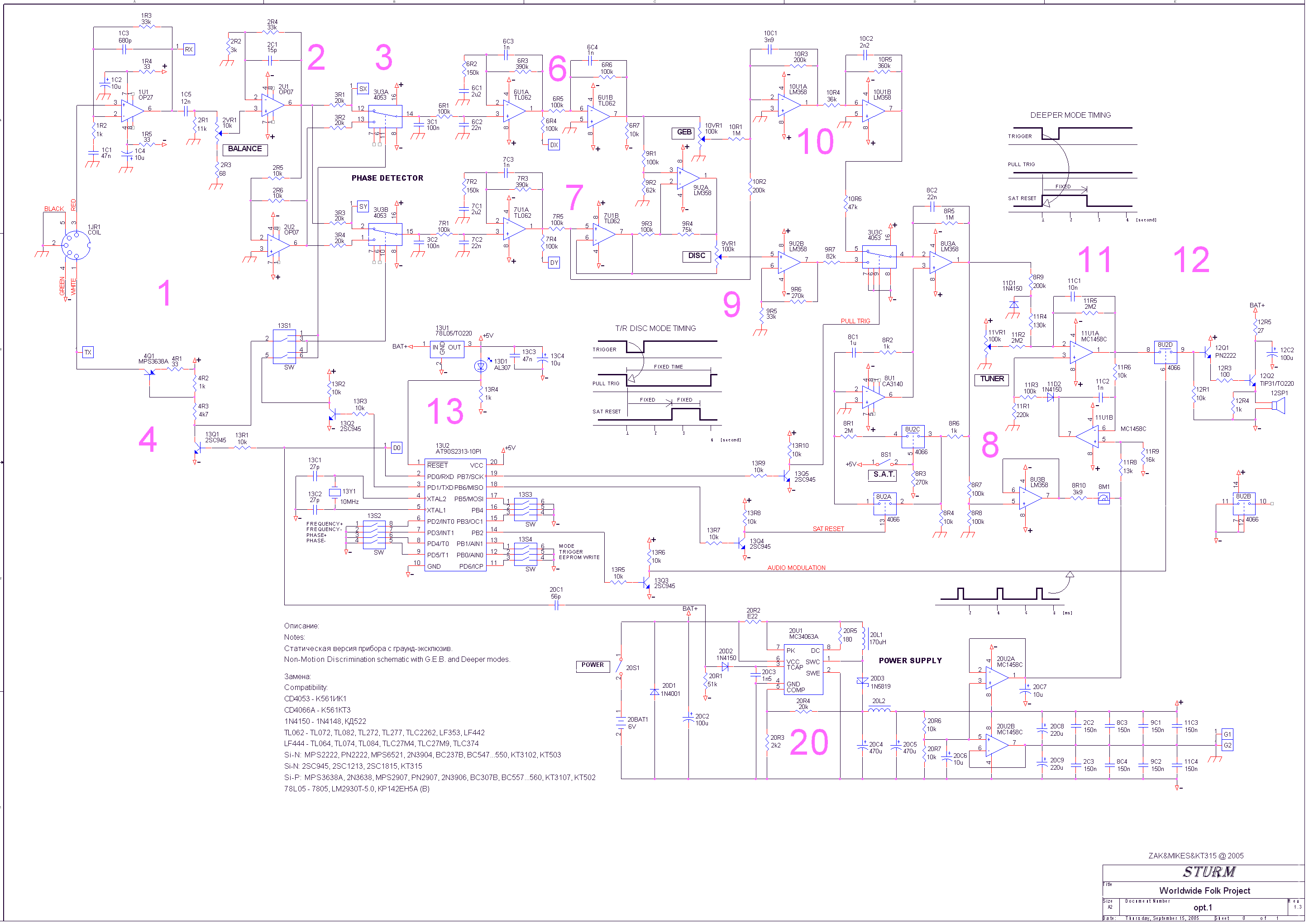

    hi all,
    new conception, old idea. I did take a part from very famous schematic and added a part on AVR. it is same static GEB disc. mode, you can see this in TM-808 also. all vantages are now. you do not need in the specific quartz.

      1. STURM is a clearly part of Whites 6000 DI PRO. but more universal
      because you may use coil from Tesoro, Fisher etc. and will get
      static mode of 6000 DI PRO.
      2. a soft you can take from Iwan's K. project http://sevzirfo.narod.ru/md.htm
      Classic MOD ver 0.3. (same development of Whites Classic schematic).
      3. there is yet not a block in the programm for SAT control - I hope
      anyone can be able to add this without problem. I did a diagramm on schematic how it must working in my appreciation, but some time references maybe changed and probably has need in adjustment.
      4. frequency and phase are tuning by one time. these are not operative tuning.
      4. programmator is any. I have an access to the brand, at my work, so
      I do not need in it.

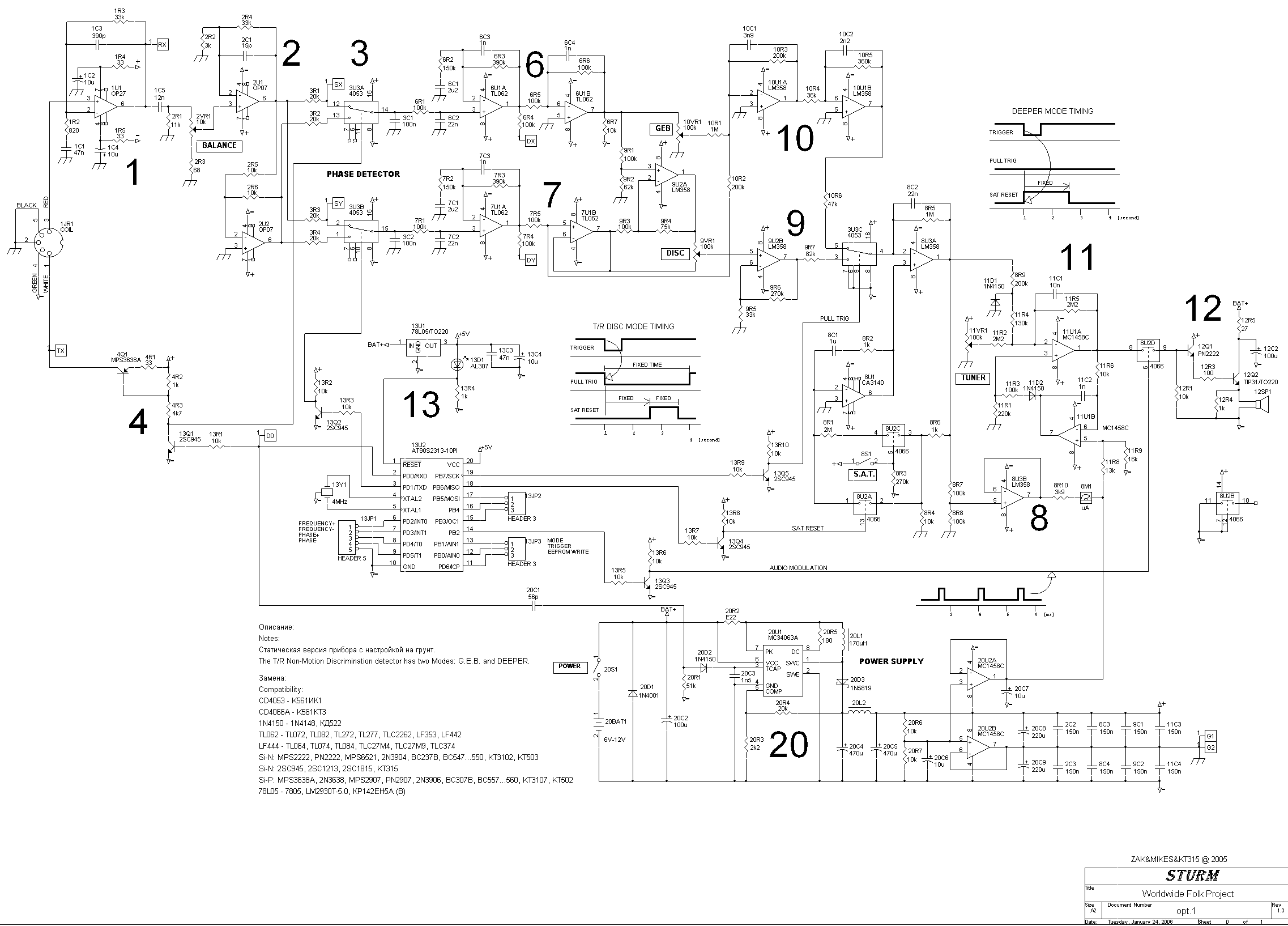

          up date

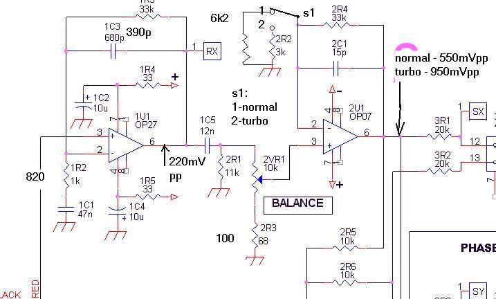

          I did some small changes of the schematic.
            HI KT315!
            It’s a may modyfication block Signal Balance. All see for drawing.
            That schema Signal balance beautiful works in motion detector.
            I have modyfication Classic III, ther’s one sensitivity – signal balance.

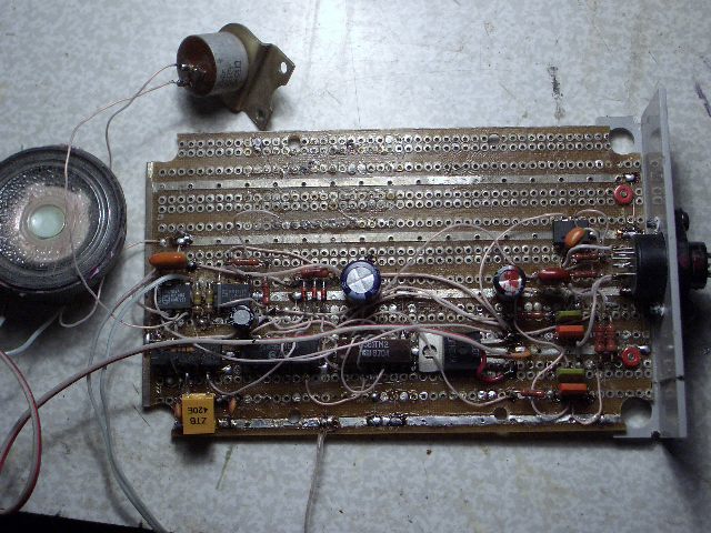

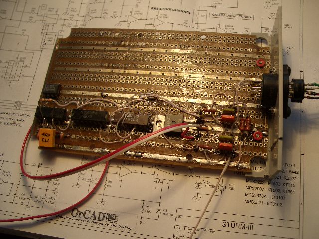

              VOLKSTURM-1
              thank you lots, Edik.
              now about our shortcut version. about VS-1. it was without PCB, but it was done and even tested. simple as any can see. good will be for learning VLF platform. HH.

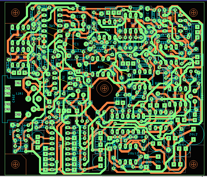

                PCB in Sprint Layout format.

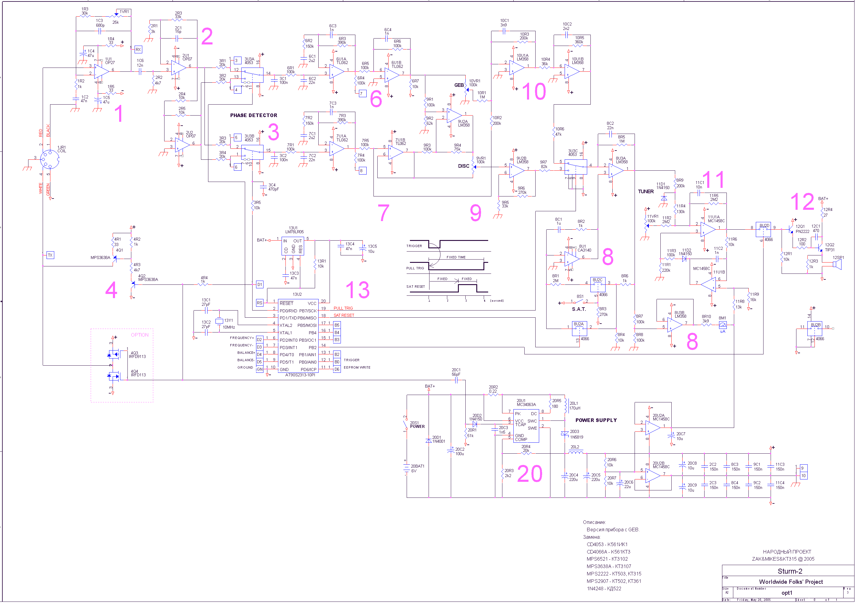

                  'Sturm' schematic was updated. still not tested. PCB layout will be ready in the week.

                        aft,
                        God sees I would not like give what is nothing now. schematic is simple and based on F-1266 one. I use Whites coil, 6,59 kHz. RX driver stage is a bridge but you can use any driver there. I has met many criticism on it.
