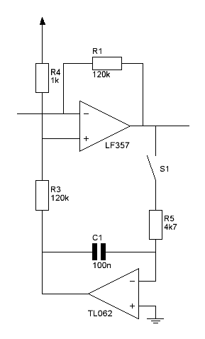

                • To Max
                  Is increasing the R3 necessary when increasing the R1 ?
                  Thanks,
                  1843
                  • uhm...maybe I understand reason for this question...
                    [ATTACH]5740[/ATTACH]
                    Thanks,
                    1843
                    there are other parts connected... like inverting input resistor you didn't draw.
                    In differential configurations you must mantain simmetry of the two halves to get the differentiation on common mode noise: it's a benefit to you.
                    So, if you change one , you need to change the other as well.
                    Both, opening or not the switch, you get a polarization voltage at the lower 120K, thus providing the effect of a battery there used to fix an offset, required for proper operations of preamp far from saturation.
                    In both cases you actually don't need, to simplify, both resistors to be 120K, they could be also different values. But if the scope is mantaining hi immunity to common mode noise... well... it's strongly suggested you keep them same value there.
                    This way, the simmetry give you always A(V2-V1), V2 is at + lead, V1 is at - lead and A is the voltage gain...(in your case is 120/1=120 times)... that means a common mode noise will have two amplified components in phase opposition and will be virtually eliminated from signal at output.
                    This is no matter of which signals you put at inputs, if they are compatible with linear behaviour of the amplifier.
                    So, though not strictly required for signal amplification it's good you keep simmetry to gain the maximum common mode noise reduction.
                    Without this your preamp will work too, and you'll not notice big differences there... but cause PIs have enormous amplification along the chain you'll get sooner or later that dang noise propagate being amplified and then create big troubles.
                    Kind regards,
                    Max

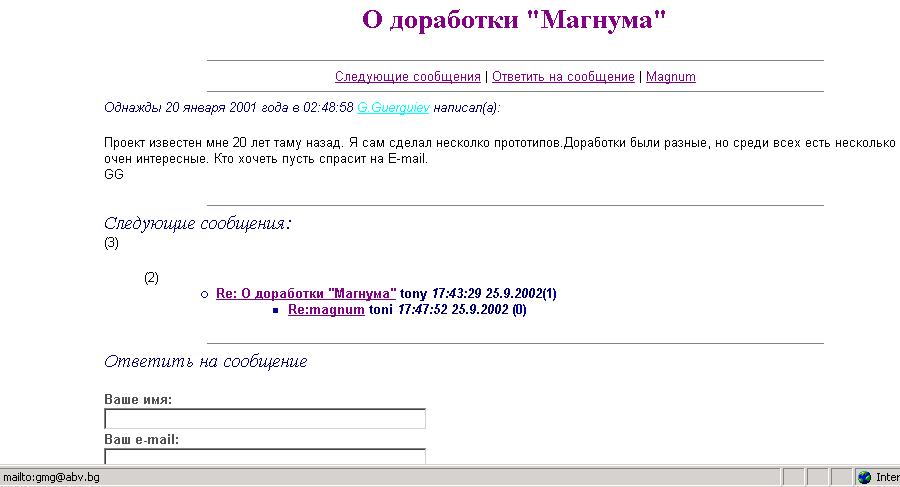

                        • amtech,
                          I will discovery you this great secret now. XR-71 was done by Gueorgui Gueorguiev in Bulgaria. he released Delta Pulse too! so I would like to ask you WHERE IS THIS BULGARIA? why you think Bulgaria is a state of USSR? what NATIVE is in Bulgaria? may be Turkish or Albanian is native? what the h to say all were done by russians. we must ask him to Welcome in the forum and I hope he will give you ALL info you wish of.
                          • SNIFFER XR-71
                            KT315 , I think this "Bulgarian File" come from a .RU Web-Site .But Now I am not sure ! I just rememember getting lot's of information from Bratsk-city .ru in late 2006. But I noticed that some good metal detector .ru sights are not working anymore!!!! But this file could be made in Bulgaria then sent all over the web!!! I will be more carefull about where I say I get my files. You are right , and this is important to know , especially if there are errors !!! I do not want to blame the wrong people for making mistakes ............Have a Good day !!!........Eugene
                            • I still see his posting in net. there he writes about his Magnum updates. yes, he was been active in 'bratsk city forum' time (the site was moderated by Roman Gusev aka silver goose). first schematics of DP and XR-71 was got from Gueorgui for the site. what he does and where he is now I do not know.
                              • Hi kt315,
                                Have you read the following page? There are some information of Gueorgui Gueorguiev...
                                http://geotech.thunting.com/cgi-bin/...n/guestbook.pl
                                Best regards
                                1843
